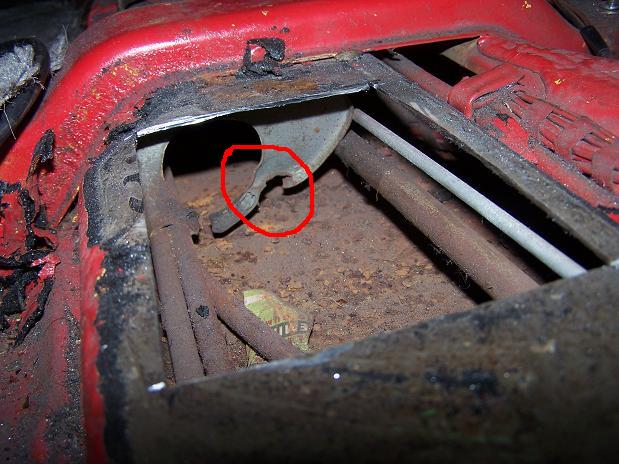

Here's the middle support. I guess the clutch tube goes where the red circle is, correct? There is a lot of stress if I put it where the circle is.
The original tab is still half attached to the side of the tunnel. Looks like someone tried to put a clamp on the tube. The extra clamp was not attached to anything although there are some holes in the side of the tunnel wall.

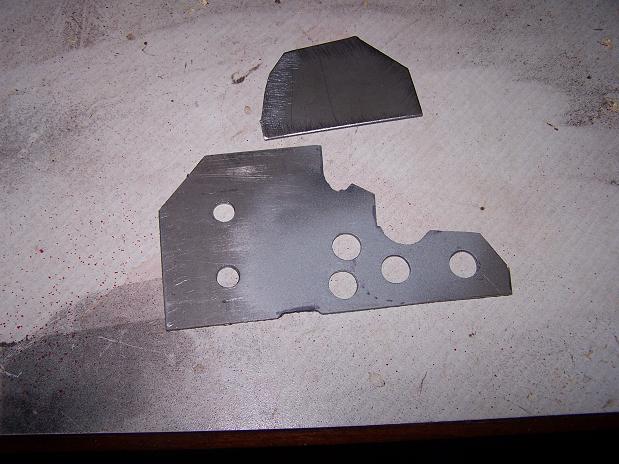

The clutch tube was repaired before as there is a bunch of weld material built up around the tube. The problem is the weaken-by-rust firewall around the tube ripped.
Made a template for a replacement piece. This piece will be quite detailed as it will have 3 holes; one for the tube and 2 for the fuel lines. I'll make the piece out of 14 ga to be sure there is enough strength. I knew my "Stop Walmart" signs would come in handy. (IMG:style_emoticons/default/dry.gif)
To remove the tube, I had to make only one vertical cut to the left of the tube as the rest of the metal had already ripped.

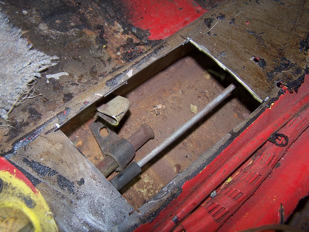

So what shape should the clutch tube have? This one looks like it has a jog around the shifter.

The plate for the firewall is completed and ready for welding. I will be overlaying the second piece on the first for more support. The 2 center holes are for the clutch tube. When doing a mock up with the side-shift engine bar, the top hole was too high and wasn't pointing towards the hole in the engine bar so I made a lower hole. See pics in the next post for different exit hole positions.
The little support plate will cover up the extra hole. I was too lazy to make another piece...

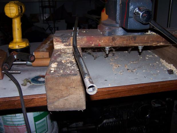

I straightened out the clutch tube and re-bent it to match the clutch tube shown in the classic clutch tube repair thread.
