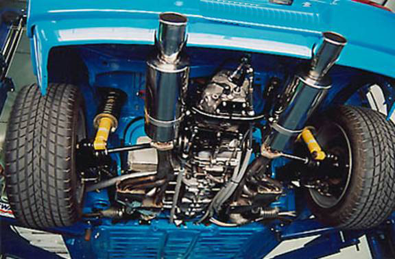

The Boxter cable shifter is very difficult to adapt to a 915 trans. The work to get the geometry correct for the cable push and pull throw lengths are not even remotely close for each box.
I went with this system which is sold by PMS. I am raising the shift tower higher to obtain better ergonomics (like a 935) and could not get a straight plane for the shift rods to go with a WEVO which I would have spent the money if it worked.
The reason I liked this system is it can be located forward, back, tilted, higher than the factory shifter location.
I found out about this system from a friend who has one installed in a sand rail with a 3.2 and 930 trans that I drove out in the desert for a day. Everything was covered up in aluminum bodywork so I did not know it was a cable setup. Once I got out of the drivers seat and looked underneath I was impressed at how well it worked. A 930 box is a notchy shifting unit anyway and I have driven them in a 911 Turbo. The operation of the cable shifter was so impressive I abandoned going with the WEVO setup.

Jeff Hail
post Jan 14 2008, 09:55 AM
Posts: 1,141
Joined: 3-May 07
From: LA/ CA
Member No.: 7,712
QUOTE(woobn8r @ Jan 14 2008, 06:36 AM) *
Contact info (or link) for PMS.....
Cost?
ease of installation...
MORE PICS!
From what I can see you have a beautiful car!!!!
Is that an inboard parking brake on your output flange?
Thanks...
Sean

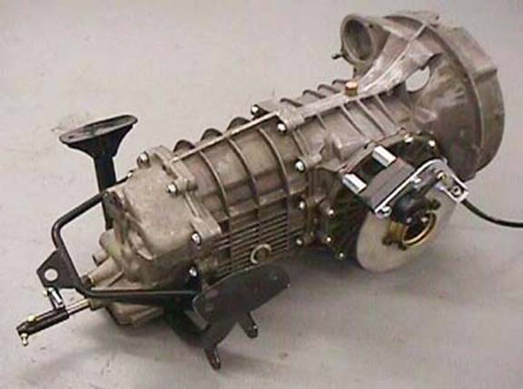

Not my car. These were the promo pics Patrick Motorsports sent to me before I purchased the setup. Yes that is an E-brake on the drive flange. Only way I would have done that is one on each side otherwise one side will still roll. Guess it's ok for a race car parked on flat ground.

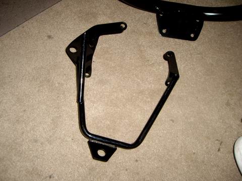

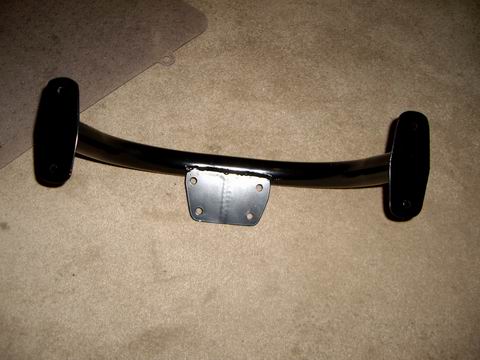

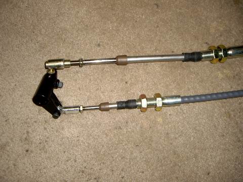

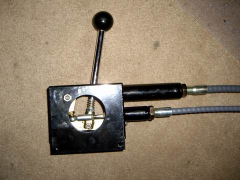

Here are some good pictures of mine (not installed yet).
I had Patrick Motorsports fabricate the transmission hoop because they already worked out the design. The smaller bracket mounts on the tail end of the transmission housing to locate the business end of the Morse Cables. The pivot mounts to the shift selector rod and is a quick release unit. Cost is about 1/3 that of a complete WEVO with the tailshifter, shift rods and bearing not including installation of the WEVO.
This system has been used by the offroad guys for about 20 years. I figured those cars are subject to a lot more abuse than a street/ track car.

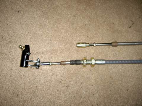

The tail piece that mounts on the rear of the trans..........

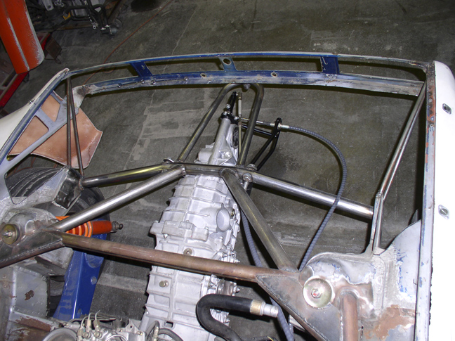

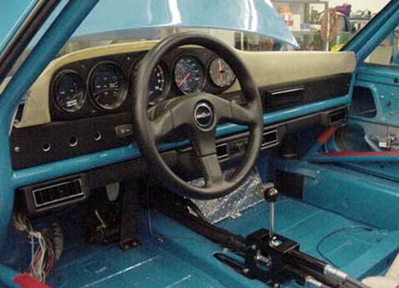

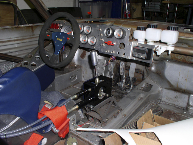

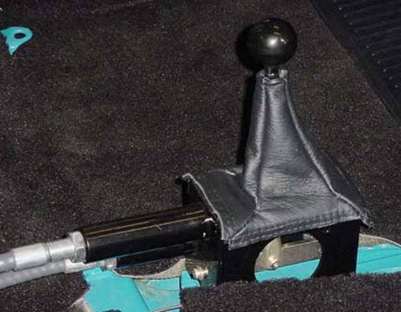

Here are a few pics of the Patick Motorsports system installed on the G50-52 in the race car (Old build pics, it's a LITTLE further along now... (IMG:style_emoticons/default/dry.gif) ).
The Patrick system is the only way to go in my opinion. It is well designed, very crisp and a great deal for the money. Mine came out of the box fully assembled! (IMG:style_emoticons/default/blink.gif) I took it to the shop, bolted the bracket to the gearbox and stood behind the car shifting through the gears. (IMG:style_emoticons/default/cool.gif) He also has a mount for the shifter box that bolts up to the stock holes in the tunnel and puts the shifter up higher than in the first set of pics.
I'm not affiliated with Patrick in any way, just a happy customer...
Interior with shifter box...

This is the trans bracket for the (flipped) G50-52...
