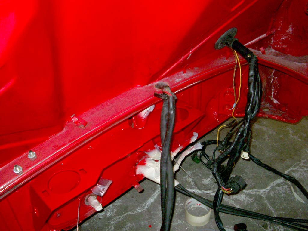

Probably 6-7 different mounts and I have learned that any "Quick Six" bar is great to get you going, but nothing to run forever. Best bulkhead mount I have ever used is the one Maddog makes that is a copy of the RJ and Vellos mounts. I only prefer the Maddog over the RJ mount because the Maddog requires that you pull the wirring loom all the way out from the back up to the firewall, mount/weld mount and push it back through the maddog mount. The RJ mount goes OVER the wirring loom. Soooooo, if you weld on your RJ mount and have to pull through wires, you're pretty much screwed. The maddog takes more time to install, but easier to work on the car later if needed.

You can still pull the wiring harness through Rich's mount, if you ever need to.

QUOTE(Root_Werks @ Jan 18 2008, 07:09 AM) *
what? (IMG:style_emoticons/default/confused24.gif)
there's plenty of room to pull through wires, the channel in the RJ mount is fairly large ...

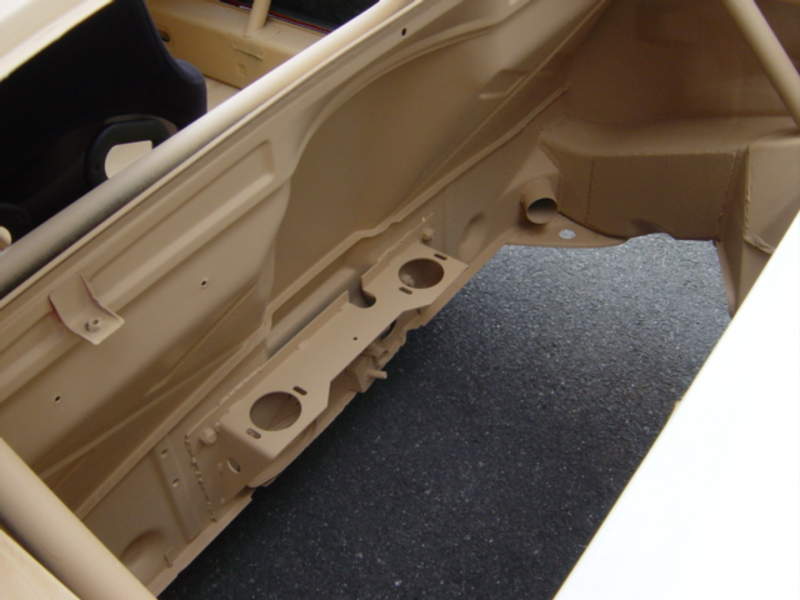

I prefer bulkhead mounts. I prefer to fabricate my own.
I have no wiring harness issues.
(IMG:http://i137.photobucket.com/albums/q202/johnflesburg/EngineMount_02a.jpg)
(IMG:http://i137.photobucket.com/albums/q202/johnflesburg/EngineMount_01a.jpg)
The "Quick Six" bars cantilever the weight of the engine on a bar that is too weak and flexes continuously.
