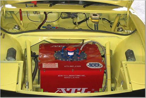

front trunk
1973914

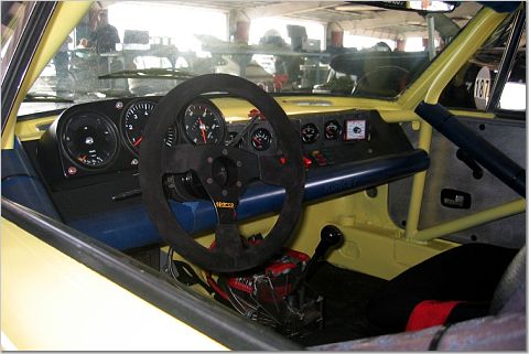

all business....
1973914

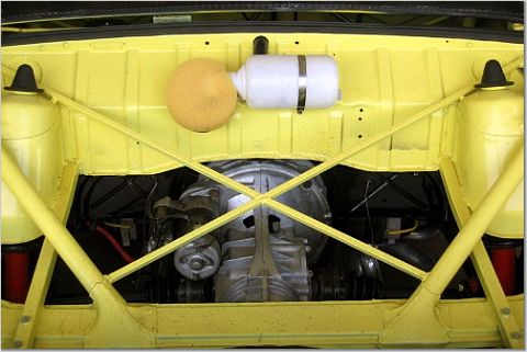

rear trunk cut out for access
1973914

Wow! Very clean build (IMG:style_emoticons/default/clap56.gif)
Unusual towhook location / set up
cheers,
Jeroen
1973914
post Jul 11 2004, 04:26 PM
Post #1526
Posts: 353
Joined: 16-May 03
From: Washington, DC
Member No.: 703
Thanks, it was quite a few hours to get it in that kind of shape! The towhooks are actually hollow - welded c-channel, flat stock and a pipe. Wanted to tie them directly into the caging, and decided to go with a unique location. Unfortunately, actually needed the front hook last weekend (IMG:style_emoticons/default/sad.gif)

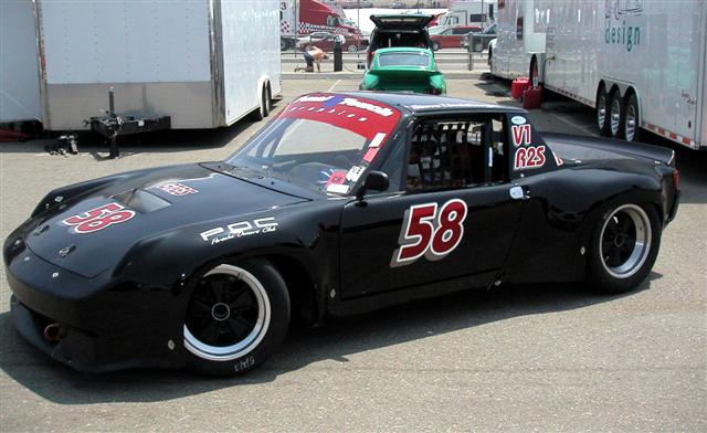

slivel
post Jul 11 2004, 05:51 PM
Post #1528
Old car....... older driver
Posts: 544
Joined: 10-July 04
From: San Diego
Member No.: 2,332
Thanks for the welcome into the club. I've attached another shot of the exterior with the new color scheme on the numbers. Don't have any engine or interior shots just yet - maybe later.

1973914 ...200 HP is not too shoddy either (IMG:style_emoticons/default/smile.gif) . I feel the need to see a spec sheet on your car...engine, suspension, weight etc. The front wings (fenders) are one piece F/glass?
1973914
post Jul 13 2004, 06:41 AM
Post #1537
Posts: 353
Joined: 16-May 03
Member No.: 703
Engine = 2.4 with 0 HP (IMG:style_emoticons/default/blink.gif) , front patrick cooler vented like the factory GTs, euro pipes with jet hot, EGT and CHT guages to monitor engine conditions
Suspension = Koni adjustables all around, 19mm Sway in front, no rear, 200lb springs, A struts, boxster brakes in front, carrera brakes rear (m-wide),vented rotors all around
Weight - havent weighed it yet, but we are guessing about 2k, will know for sure sunday
Body - fiberglass all around except for the doors, fenders are one piece and dzuesed for easy of adjustments, cleaning, and replacement if needed or wanted.
Chasis - gt kit, long kit, tubing out to the suspension areas, any rust is gone
Really should have just done a 6!
