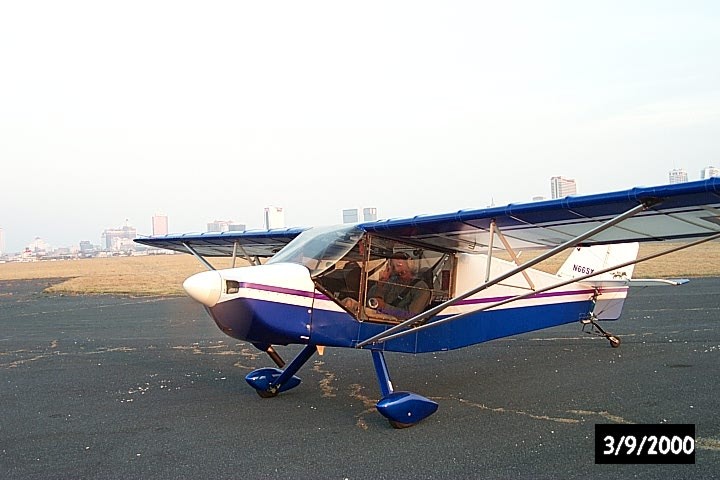

I'm flying behind it's little brother, the type I. Converted for aircraft use. THe type IVs are nice but a lot heavier then the type Is. Here's my type powered toy......

Neither your bird or the ebay plans appear to be geared. You're direct driving your prop? I don't know much at all about automotive conversions, but my first question would be power. You're going to spin the prop at about 3,500rpm max, right? At 3.5k the motor would last forever, but there's not much power to be made down there. I'd like to hear more about this. Cool stuff.

Your right, it's direct drive. I'm maxing out at 3200 rpm. The motor is bored/stroked to 2180cc and is supposed to kick out 70 - 80hp @3200. It's never been dyno'd but the plane's performance seems to be spot on for these hp #'s. This is the only aircraft of it's type (Rans S6) that's flying with this engine. I had to create a motor mount, cowling, and all engine systems (intake/exhaust/etc..)
It's a blast to fly and only burns about 4 gals/hour. It's kinda funny building an engine that needs to develop all it's power at 3k, most of the hp tricks we all know and love are useless down that low.

WOW! that's incredible to me. looks like a blast! (although i don't think i would trust my life to engine i have in my 914....)

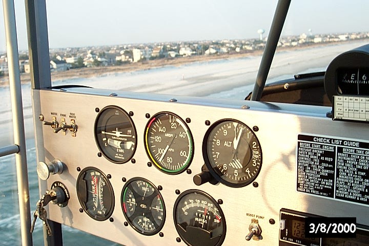

birds eye view........
2400 rpm @90mph puttin' down the beach

are thos VDO gauges??? LOL, must be a late model (no silver center gauges!) (IMG:style_emoticons/default/wink.gif)

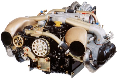

I have a customer with a 140hp @ 3500 rpm type 4 direct drive with a Kr-2...has LN engineering secret torquemeister cam- like 200 ft/lb of torque below 3k... :-) With nickies, you can make a big type 4 weigh in around the weight of a similar cast iron cylindered type 1.

I can get 200 lb/ft and keep it a daily driver- been there- done that!
I have built engines that made 140 BHP below 3500, but its not easy. Above that and according to prop size- they can explode.

What the hell is that???? Looks like water cooled heads/aircooled cylinders and turbo charged. Is this what Limbach is up to these days?
Mine is dual ignition (one magneto, one electronic) with an Ellison throttle body injector. I've had wood over those nikasil cylinders ever since someone posted a picture of them on this site. I was looking all over for someone who made an aluminum cylinder sleeve for a type I when I was building the plane/engine. All I could find was Autocraft and it was only suitable for alcohol use. When/if I rebuild the engine I think it'll get nikkies.
The motor has been very reliable for aircraft use. So far, the only problem I've had is the exhaust valves having a short life (150 to 200 hours). I've never had a failure of any sort, but they are begining to erode at that point.
The plane took 10 months to build from start to first flight. That's working every weekend, every night after work, all my vacation. Not to mention 10,000 cups of coffee and 150 pizzas! I actually kinda built it twice, I cut and fit every piece and then disassembled it and had every aluminum piece on the plane color anodized for orrosion protection and then re-assembled it. It's paid off, it's been flying for 10 years and still looks perfect and it gets hangared 100ft from the ocean.
