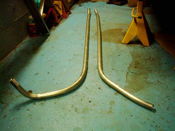

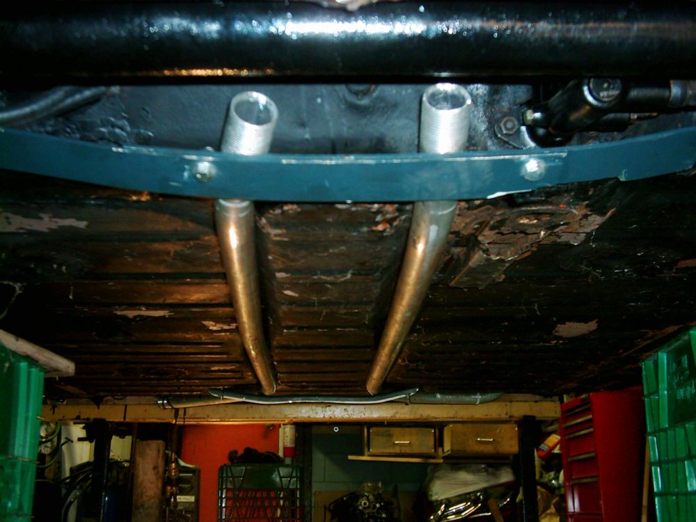

nukepipe:
Not sure which hard line installation you previously saw, but here is a couple of photos of my installation from a
couple years ago. Thick wall aluminum tubing 1" ID; must say it took two guys eight hours with and large
commercial pipe bender to fabricate these up. Seem to work fine with no problems/concern (yet) with bottoming
out. Trust this helps.
Allan

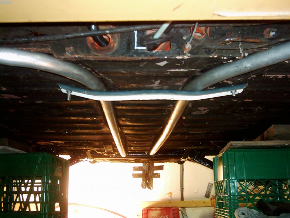

Another shot
