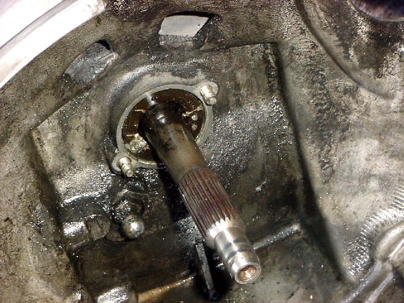

415PB
post Jan 17 2004, 09:39 PM
Posts: 498
Joined: 7-August 03
From: So Cal
Member No.: 996
Thanks, I got the seal off but it appears the PO might have used some type of sealant. It appeared to have been glued on. The portion of the seal that goes into the tranny was very brittle and some very small pieces fell into the tranny. Should I be concerned with this or should I try and fish the pieces out? I have been trying for like two hours with no luck.

post Jan 17 2004, 09:50 PM
Resident German
Posts: 42,257
Joined: 21-January 03
From: Oakland, Kalifornia
Member No.: 179
QUOTE(415PB @ Jan 17 2004, 07:39 PM)
Thanks
were they rubber or part of the metal inside the seal?
the rubber probably won't do any harm, not sure about larger metal pieces.
if metal, try a magnet on a extension.
Andy
Brad Roberts
post Jan 17 2004, 10:51 PM
914 Freak!
Posts: 19,148
Joined: 23-December 02
Member No.: 8
Make damn sure you check the pivot ball for the clutch fork. I'm to the point now that I check ALL of them when we have the tranny's out. I have been bitten too many times. I pull them out and load them up with some good sealant and screw them back in.
B
415PB
post Jan 17 2004, 11:12 PM
Posts: 498
Joined: 7-August 03
From: So Cal
Member No.: 996
I'm pretty sure they were small pieces of rubber so I probably wont do much about it then. As for the pivot ball, I did notice that it is leaking. I will take it off and seal it up. Thanks for the help.....

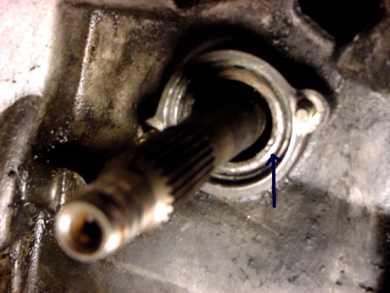

415PB
post Jan 24 2004, 02:32 PM
Posts: 498
Joined: 7-August 03
From: So Cal
Member No.: 996
Andy, does this metal ring have to come out as well, or is it part of the tranny.
Thanks,
Rod (Feeling stupid in Cali)
