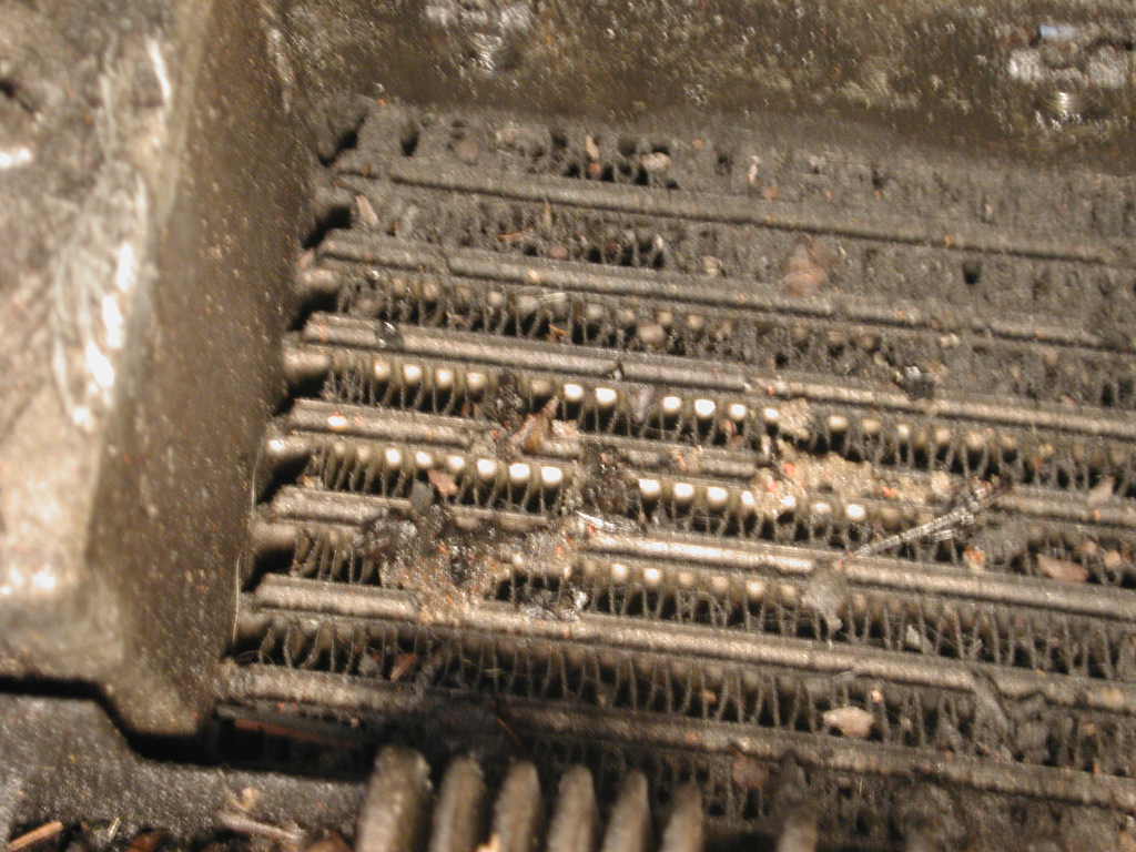

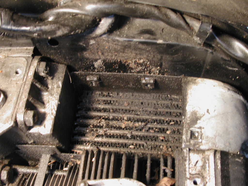

First the before. For those new to this part, the /6 has a channel to funnel air from the fan into the top of the oil cooler. On an 914, it is visible on the top of the shroud from the fan, back to the rear of the engine on the driver's side. Oil leaks, or any other crap entering the fan, are well funnelled to the top of the cooler.
Before Pic.
krk
post Mar 16 2004, 08:58 PM
Post #82
Posts: 997
Joined: 27-December 02
From: San Jose
Member No.: 22
Nother before.

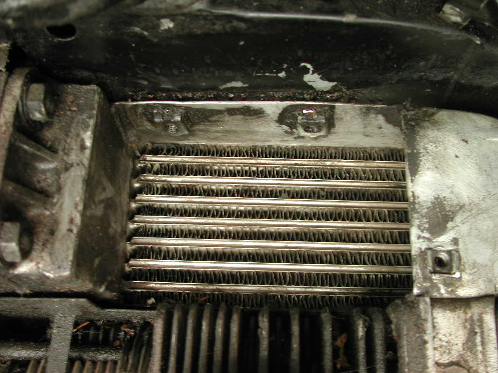

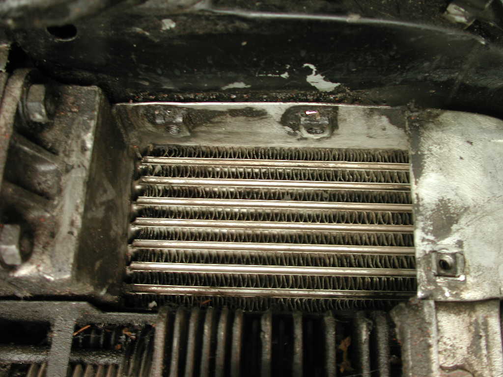

My cleaning approach: First I used a shop vac with an appropriate attachment to clean off as much debris from the top that I could. Next step is to spray cans of brake cleaner down until you are bored. I used a turkey pan to catch the drippings. It will drain over the exhaust on the drivers side.
I used up 2 large cans of brake cleaner. It's not obvious when you should stop. I quit when it didn't seem to be draining anything with particles in it. But it's very subjective.

Oops. The Pic!!!!!!! (IMG:style_emoticons/default/headbang.gif) (IMG:style_emoticons/default/headbang.gif) (IMG:style_emoticons/default/headbang.gif) (IMG:style_emoticons/default/headbang.gif) (IMG:style_emoticons/default/headbang.gif)

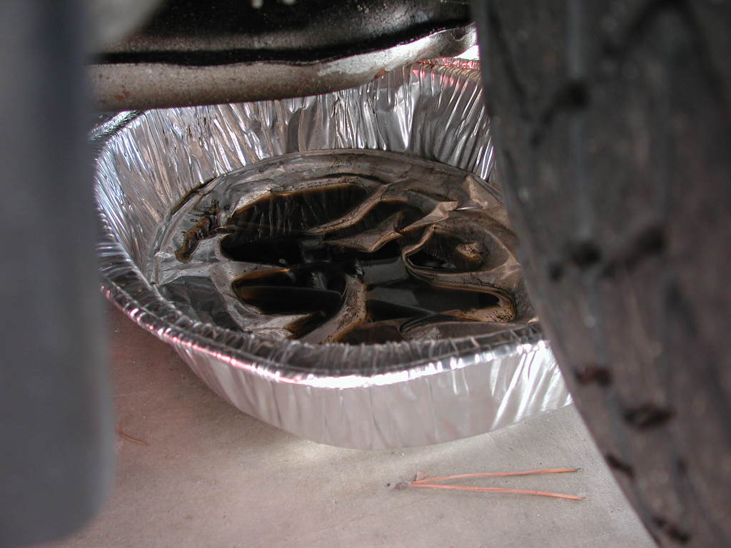

And finally, for the really perverse -- you need to see what drained out.
Here is the turkey pan.
I know -- nothing stirs the soul like someone cleaning old crap out of something. What a great way to end a thread!
love, kim. (IMG:style_emoticons/default/laugh.gif)

post Mar 16 2004, 11:35 PM
Post #86
Ummm ... what?
Posts: 781
Joined: 17-January 03
From: San Jose, CA
Member No.: 163
Well, THAT gives a whole new meaning to basting the Butterball. (IMG:style_emoticons/default/blink.gif)
Are you gonna save that for Thanksgiving with the in-laws?
That "before" photo looks like the cholesterol buildup after a lifetime of Big Macs.
Good job getting the job done.

Carl,
I'm not sure it's safe to pick on hamburgers on this board. You know how politically correct we are. (IMG:style_emoticons/default/laugh.gif)
But there is no doubt that the car runs cooler. Even after only a week of being back in service, the temp gauge tells the story. Gum up your cooler and you will pay. I had no idea of course, so I was looking into under car flaps (prolly will still install them) and so forth, but if your cooler is plugged up, none of that will matter.
kim.

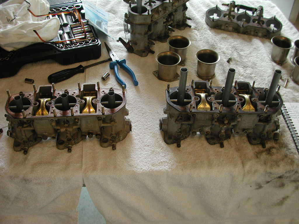

I have one last pic. There are old webers and new webers. The carb on the left is an old one, and the newer on is on the right. The tell-tale is the quality of surfacing that is done on the outside casting. Inside these carbs look pretty much the same. They got chinzy over time and the outer casting was left rougher.
