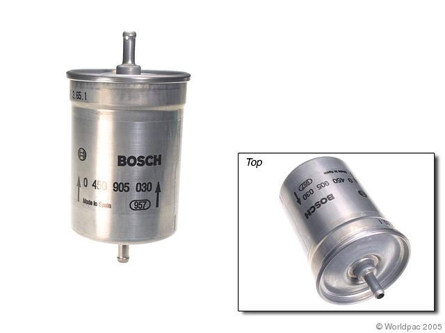

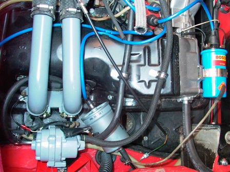

I noticed that the filter for my daughter's '99 VW Cabrio has the right hose sizes. I mounted one just upstream from the fuel rails, in the engine compartment....
I kept my plastic low pressure filter up front between the tank and the pump. (Filter photo from Drivewire.com)

Jim, thanks for the photo...
You mentioned you have a low pressure fuel filter between the tank and the pump, is it one of the small round clear plastic ones that you can see thru?

QUOTE(watsonrx13 @ Feb 19 2008, 08:13 AM) *
-- Rob
Nope. Mine's a '76, and I'm still using the stock square filter, translucent white, up front. Inlet and outlet are different diameters.
I put the Bosch in because I got worried about crap from the pump during the switchover to gasohol.
Good luck!
Jim
