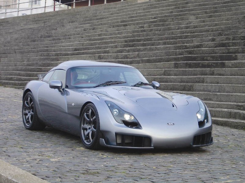

It goes to show I'm of the new video game generation (i'm from 1981) and I hear TVR and I think Project Gotham Racing 3 and the TVR Sagaris, my fav car of its class (IMG:style_emoticons/default/wub.gif)
sorry about your diff though. The charger(E-class) is an IRS maybe you could use one of those? I dunno, i'm no help
that sagaris is hot secks though
