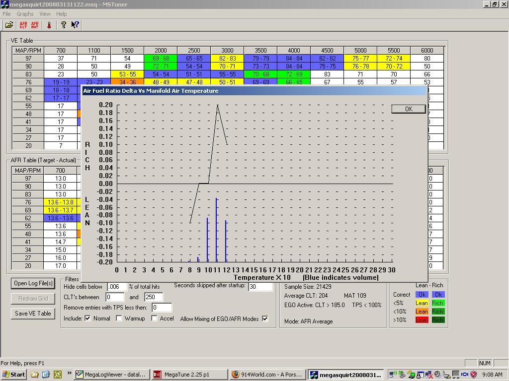

agrump
post Mar 18 2008, 09:35 AM
Posts: 141
Joined: 13-November 04
From: Atlanta, GA
Member No.: 3,103
No SDS doesn't have any head temp/heat soak issues. It uses std. bosch head temp sender, same as in the stock L or d-jet. On my wideband A/F values are rock soild were I set them 12.5 to 13:1, my old cammed 2.0 and stock 1.8 had/have head temps just barely over 300F.
Hell, if I set up my maps as 12.5 I wouldn't notice it either, but at 15-16 cruise it starts to stand out as an oddity.

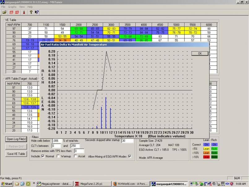

agrump
post Mar 18 2008, 09:46 AM
Posts: 141
From: Atlanta, GA
Member No.: 3,103
QUOTE(Rick_Eberle @ Mar 18 2008, 07:26 AM) *
Hey Dean, what software is that???
Wrote it myself. I didn't like the way most of the tuning software averaged the VE bins so I wrote one that interpolates similar to how the MS ECU does it. It only supports MSII, v2.6 or 2.8 but if you want a copy send me a pm with your email address
