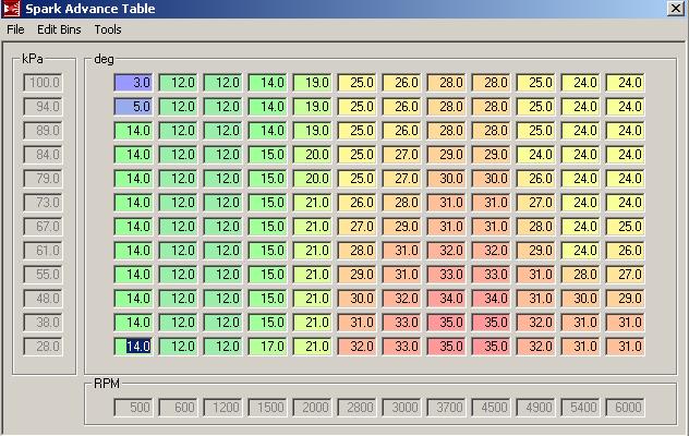

agrump
post Mar 18 2008, 12:12 PM
Post #26
Posts: 141
Joined: 13-November 04
From: Atlanta, GA
Member No.: 3,103
QUOTE(yarin @ Mar 18 2008, 09:28 AM) *
Hey Dean,
Can you please post your spark tables? I believe i'm running a bit too advanced, my head temps are high. Nice app.
I ran my air temp sensor in a custom intake pipe, no heat soak issues since it's mounted to PVC.
Good idea about mounting the sensor in PVC, the stock plenum gets stupid hot. Care to share some pics?
My head temps are lower then normal since I’m running Nickies but I’ll post my table. Good idea about mounting the sensor in PVC, the stock plenum gets stupid hot.
Standard disclaimer that this may destroy your engine, blah, blah, blah
Sorry if I hijacked the thread, I’m a big fan of the MS system.
