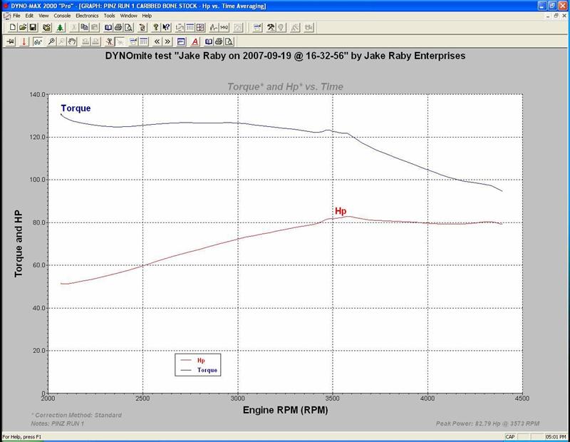

but, what about routine driving (cold start, idle, cruising at various speeds, and acceleration)?
Been driving one daily for 5 years... Thats everyday, rain, middle of summer, middle of winter.
The engine runs as well as you tune it to run. The cold start, enrichment and overall functionality is all on you and with SDS thats as simple as programmable FI can be.
It took me a year of seasonal changes to get my 912E perfect for cold start and weather changes, since then I haven't touched the programmer except to innstall a new programmable chip that I am developing with SDS that allows manipulation of the target AFR in closed loop mode especially for aircooled applications that need to run richer AFR than stoich.

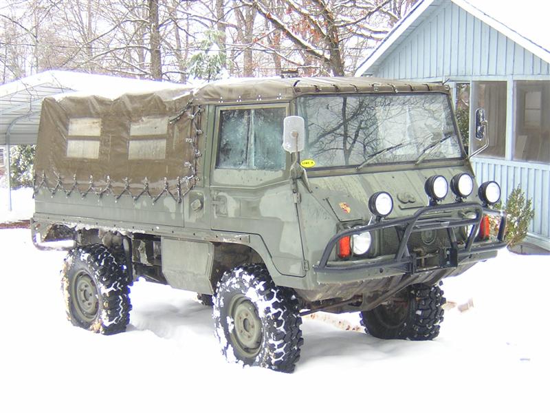

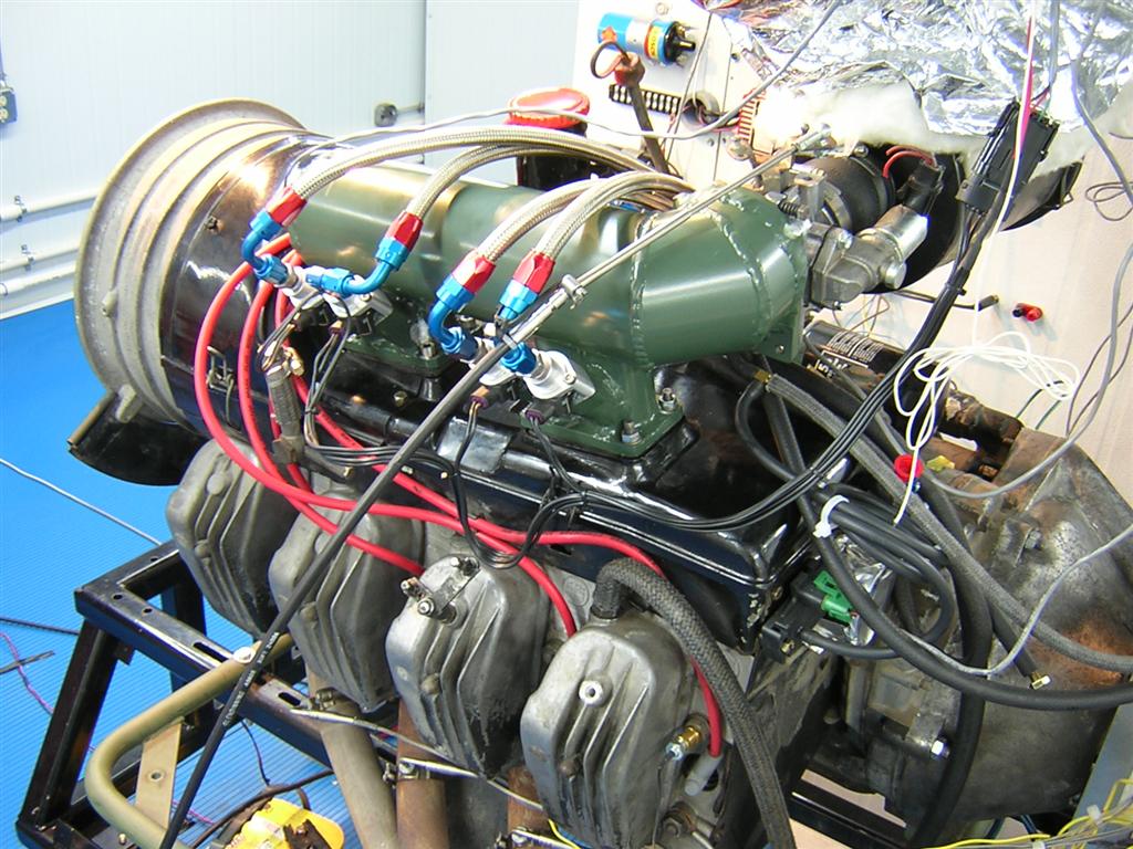

I have even made the SDS retrofit onto my Pinzgauer aircooled engine. The FI did amazing things for this 90 HP beast...

I'm surprised that Pinz doesn't have a MassIVe-torque TIV in it. (IMG:style_emoticons/default/tongue.gif)

The TIV isn't heavy duty enough for the Pinz. The Pinz crankshaft weighs nearly 100 pounds and was developed not to break when the combat troops it is carrying are being shot at with artillery...
The Pinz engine uses many VW and Porsche parts and weighs about 800 pounds fully dressed
