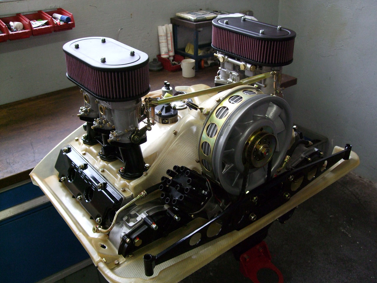

Well this topic got waaaay off target....
How about it. How does the DIY make his own amber-colored fan shroud pieces for the 914? Would I need to make a mold, or could I use the should as the mold? How do I get the amber color?
I've done some glass work but only on top of wood and clear was the desired result.
For reference:
