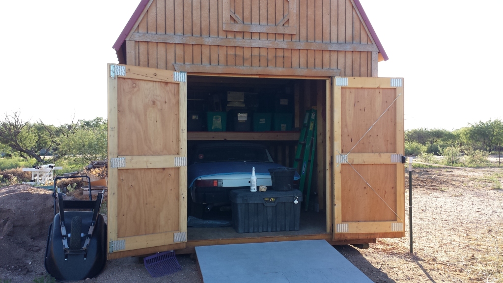

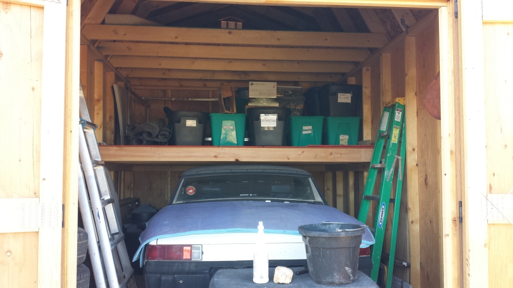

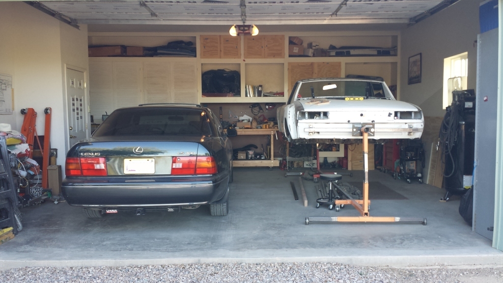

I know I haven't been on in a while. After getting my brother squared away, I was having difficulty getting back to the 914. My garage had become unmanageable, so I did what I thought I'd never do - buy a shed.
Well this is more like a small barn - 10x16 and lofted so that it has storage under the roof. Once I put my son's 914 in I built another loft a few feet lower - giving me more storage space that was easier to access.
And just when I was ready to get back to the 914, my LS400 starter took a crap. SO while I'm in there, I'm going to do a 150K mile service on it first.
So nice to have my garage back though.

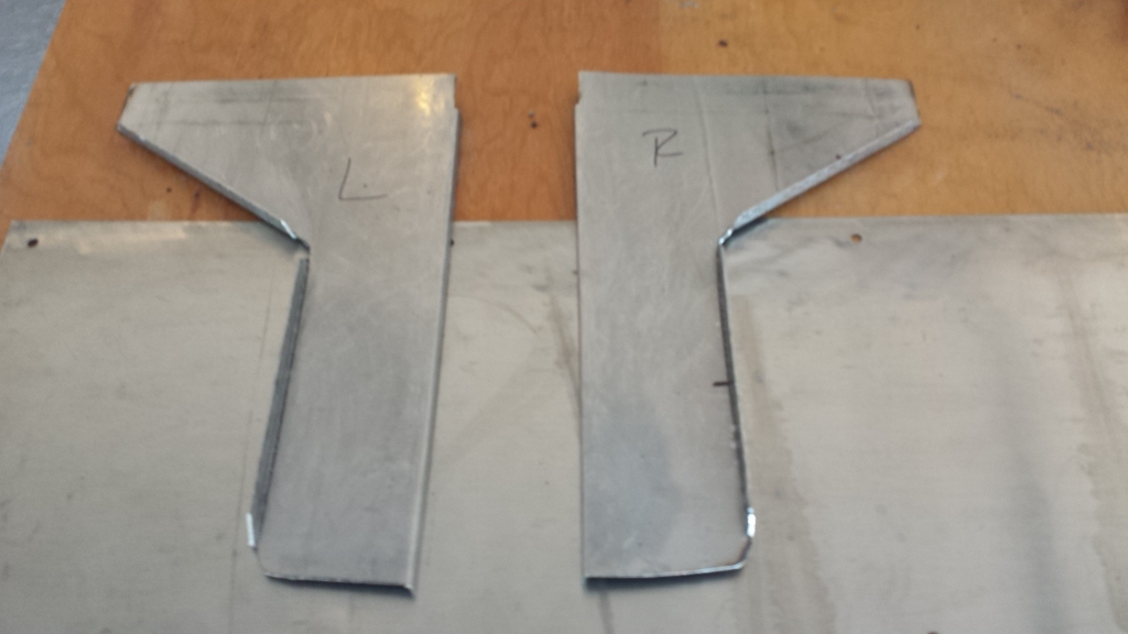

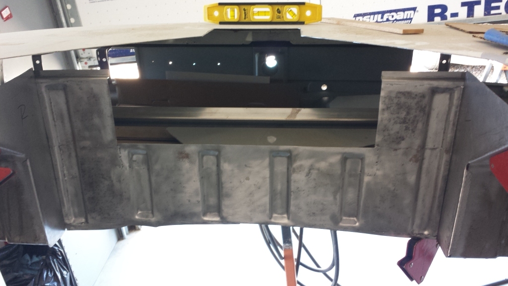

Made some progress this morning before it got too hot. Got the side pieces for the rear firewall extension fit, trimmed, and bent.
The sides have 90deg tabs front & back to reinforce the extension. I'll also be adding a tab at the bottom. What remains is to add the L-shaped piece (seen on the center extension) at the top where the molding is mounted. The trunk will also get the rib added so the molding fits properly.

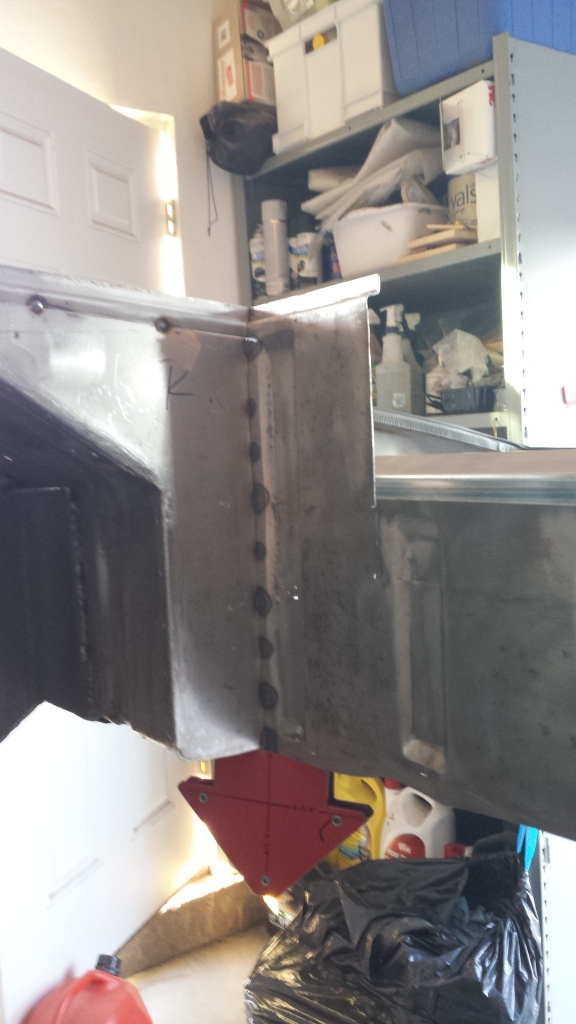

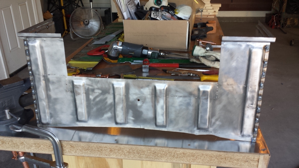

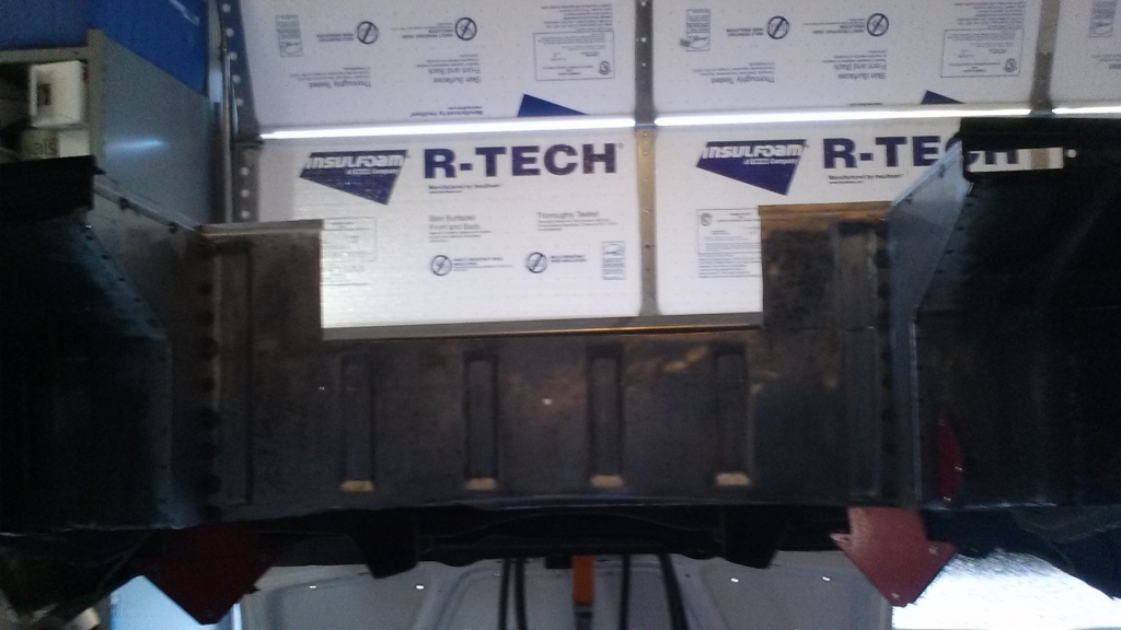

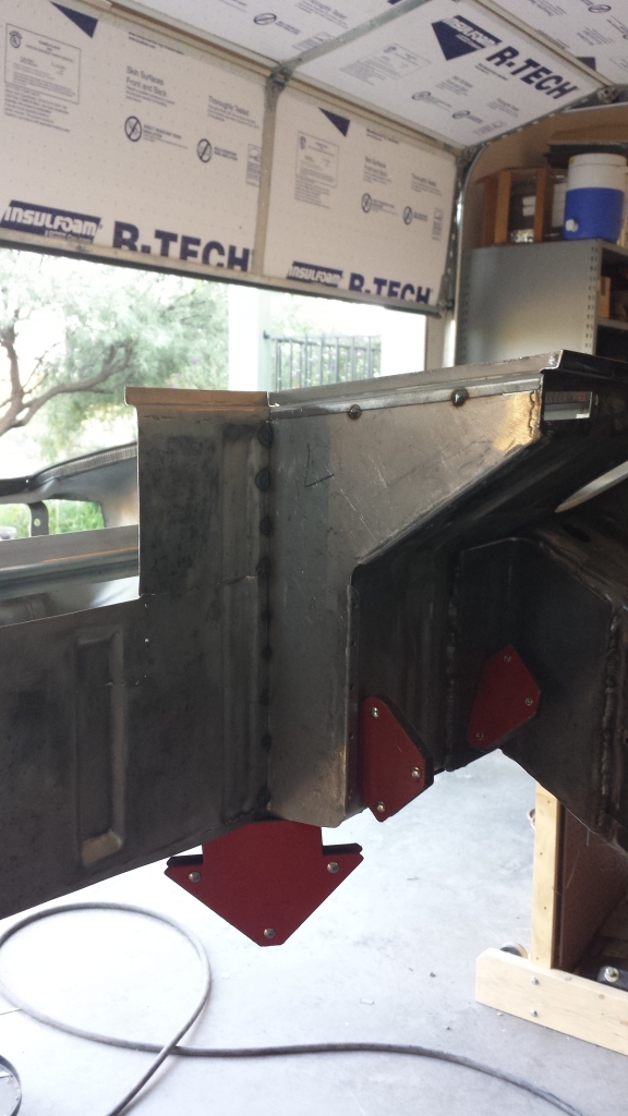

Another hot day, but I was able to get the firewall insert mostly roughed out. Still have a bunch of welding to do on the parts and to put it in. Here's the hole with the motor in so you can see what's getting closed up.
Here's the parts spot welded together.
Left and right installed temporarily.

Your new firewall looks awesome!!! It really looks just like a factory piece; very nice!

Thanks guys. I wasn't sure how this was gonna come out. But I've found that doing stuff on the bench yields better results than trying to do it on the car.
Got to spend a couple hours doing some of the finish welding and cleanup. I'm anxious to get it welded in place, but need to do more finish work before that happens. Once it's in I can move on to getting the rest of the body ready for primer & paint.

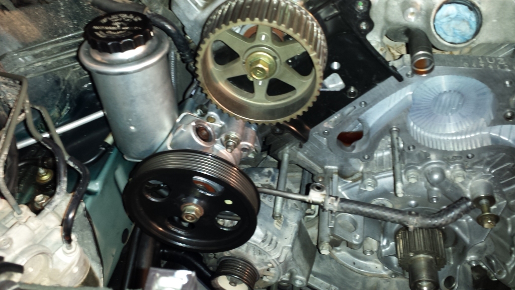

Haven't spent much time on the 914. Spent a couple weekends with my son home working on his bike & his 996. Mostly been working on concreting posts in between all the rain, and finishing up work on the LS400.
The LS400 turned into one of those - while I'm in there . . . jobs. Started with a failed starter, then a dripping water pump, stuck fan clutch, and a leaking power steering pump. Water pump is off and power steering pump has been resealed and haven't even gotten to the starter yet - which just happens to be buried at the back of the top of the motor underneath all the intake stuff.
