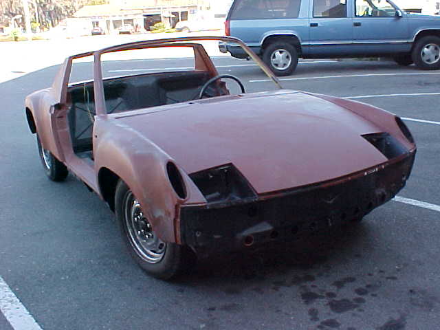

This guy over on the Pelican board sprayed the entire car in Por-15 and some other stuff before painting it. It actually looks awesome and the underside turned out amazing. It looks like if you spray the por-15 on correctly it is smooth enough paint over and still look good.
POR-15 coating before Painting
(IMG:http://forums.pelicanparts.com/uploads2/por15-61073797925.jpg)

http://www.eastwoodco.com/RustvsPOR.asp
Carefull testing should be done so the paint sticks the way YOU want it.
Rust Encapsulator (by itself) does not grab the paint as well as a normal primer.
I put some Rust Encapsulator on some ballards next to my house. 4 years and no rust.
-Rich Hilgersom
(Yup, the whole car, this shot is at the paint shop)

Painting the whole car in POR-15 is a great option, but still has the problem of only covering the areas you can see. Those surfaces aren't really a problem, for the most part. If I could dip in POR-15 then we might be on to something.
