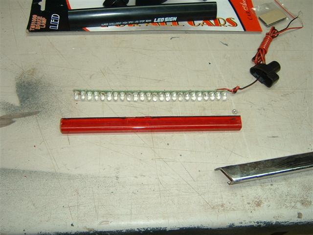

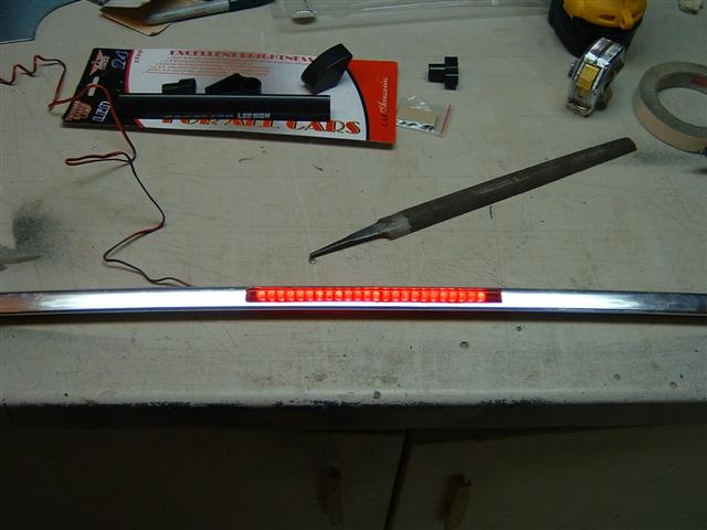

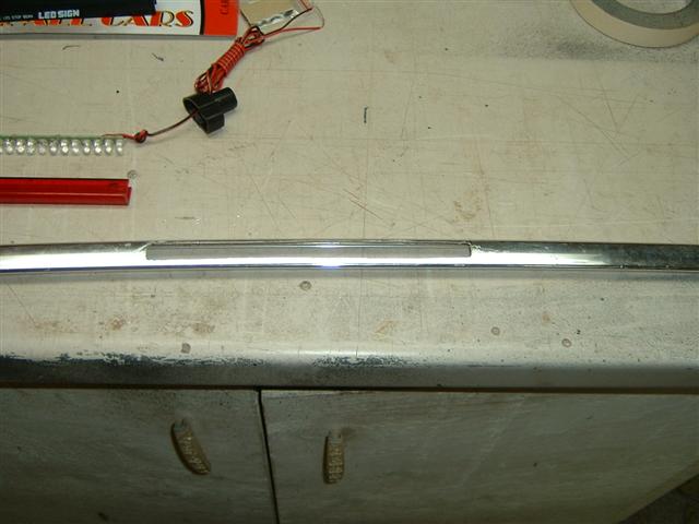

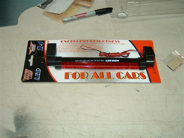

I bought a LED universal brake light on Ebay for about $8. I bought as short a light as I could get.(24 LED's and about 7 1/2" long) I took it apart and determined that it could fit into my roll bar trim. Since I just bought a parts car I felt I had an extra roll bar trim to experiment with...so I did. The trim will be painted black so it should blend in even better.
I've yet to mount it on the car, it will be tight but I think I can make it work.
Either way, for $8 it was worth the dream of a nice high mounted brake light.

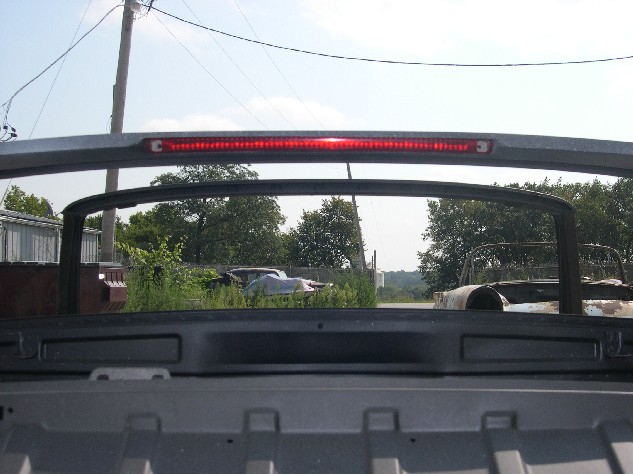

here is my solution to the same problem. (brake light from a Honda Del Sol, also on ebay, $25) THe details are in my (lack of) progress thread in my sig line!

Making a clean slot in a "U" channel can be quite pissy. I can see a lotta careful filing and fitting. Got a seal to prevent water ingress?

Andy that's my plan. I figure I might have to notch out the roll bar a bit, but the wiring will be the easy part.
To seal it I plan to use good old RTV silicone. Since I don't drive in the rain or snow, the only water my 914's see is from the hose when I wash it.
As for cutting the hole, I started with a drill bit, then used a jig saw /metal blade, then a dremel tool to clean it up and finally a file to smooth the edges and square the corners. It's been quite easy so far.

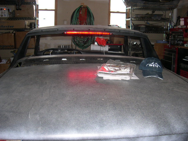

Does much light reflect back into the passnger area form the back window whenn the light is engaged? It looks really, really good, but I am concerned about light backwash.
TravisNeff
post Apr 9 2008, 01:53 PM
Posts: 5,082
Joined: 20-March 03
From: Mesa, AZ
Member No.: 447
I have one on my engine lid, there is no lightwash from the light into the passenger compartment.

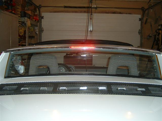

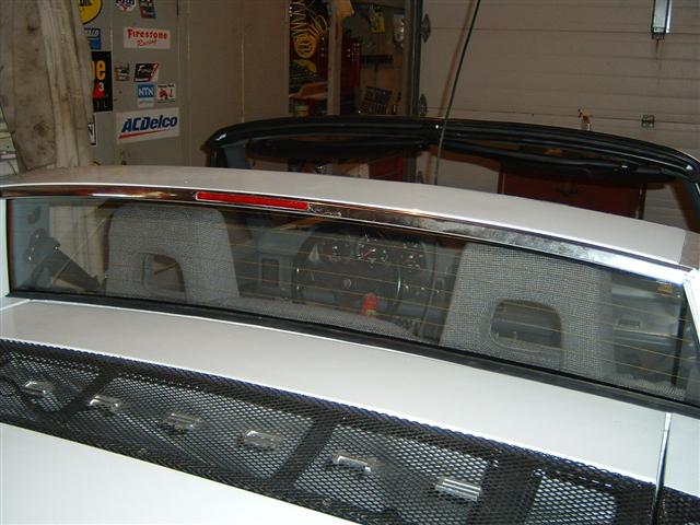

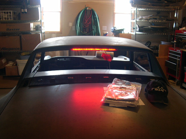

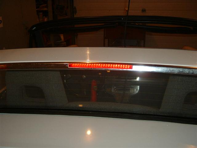

Just an update. I installed the light on my car. I had to trim most of the bottom lip off the inside of the trim piece to get it to fit without grinding away any of the roll bar but it worked pretty good. The trim will be painted black to match the rest of the trim on the car and the ends of the light will have to be sealed but I am happy with the finished product.
