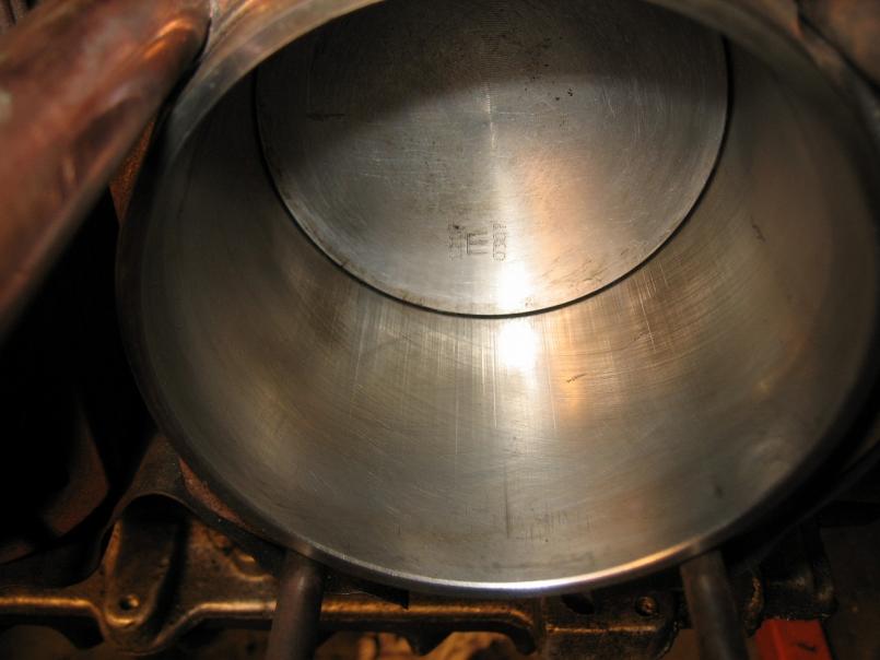

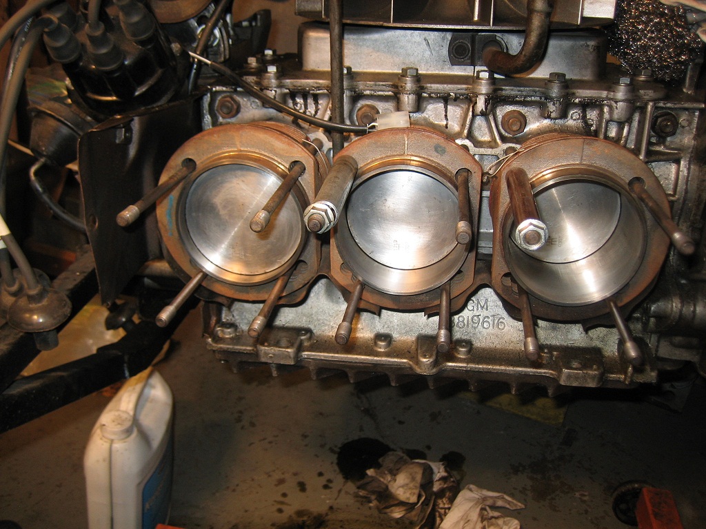

OK, time for some re-education. If the cylinders have this scoring mark on the low side, does this mean I have to do anything? I know it is likely because of one of the times that damn carb flooded the engine (no lube) and it gouged the sides a bit. I cleaned all the piston heads and barrels up on the one side tonight. (IMG:style_emoticons/default/smile.gif) Scotch brite and spun stainless pads.

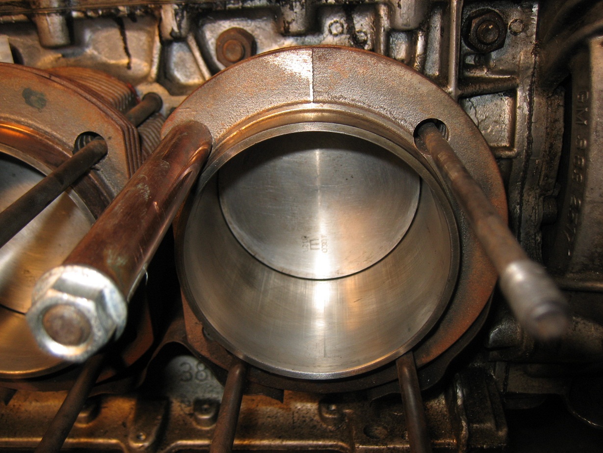

Here are some close-ups of the marks. These were brand new.

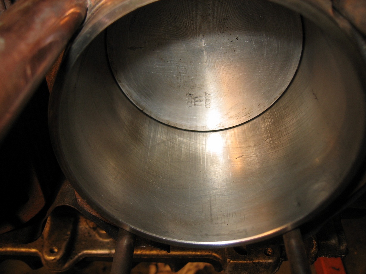

Uno mas. Mis pedos olfean como muerte.

Well, the pistons and cylinders ALL have rub marks....this is a kiss of death for the parts, and my account (IMG:style_emoticons/default/sad.gif) The worst part is that I need 6 p/c and that is typically a PITA to get since they come is sets of 4. The other PITA is that they all need to be modified to be used, which is more time and $$.

What are you seeing that I am not?
Unless the scoring is deeper then it looks, I don't see why that could not just be polished out. Are the pistons really so shot that they can't be used? they are really so shot that you can't just re-ring?

I got the same feeling, that they could be reused....but so far have had only you reflecting that sentiment. I ordered a dingle berry hone to recondition these. The skirts on the pistons are showing light scoring, but the factory marks are still there. The original hone marks on the cylinders are still present under the score marks. (IMG:style_emoticons/default/confused24.gif) I can take better pics and get a consensus today. I think I will start a new thread to get more input.

just use them....cross hatch with a hone if you want to feel better..My guess is that you will have the same scrapes within a couple of hours after re-install....

The cylinder in the 14 HP Kohler in my John Deere is scored a lot worse than that and it runs fine. (IMG:style_emoticons/default/wink.gif)

(IMG:style_emoticons/default/agree.gif) It's a bus. Hone it, clean the pistons and rings and run it. Remember you still have to dial in the CIS. If you end up with a rich condition again an smoke a second set of cylinders you will really be pissed. If you think your going to have a leak down problem you could always assemble the heads and check it.

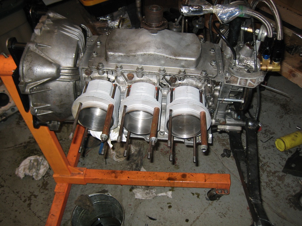

Starting to reassemble the engine. I used my blasting cabinet to clean the barrels and coated them with silver BBQ paint (IMG:style_emoticons/default/chowtime.gif) They look like fake nickies.
I also removed the rings and cleaned up the pistons. Then I roughed up the barrels with my flex-hone.
One side done.
I am seriously thinking of going with roller rockers on this engine...while I am in there (IMG:style_emoticons/default/rolleyes.gif)
