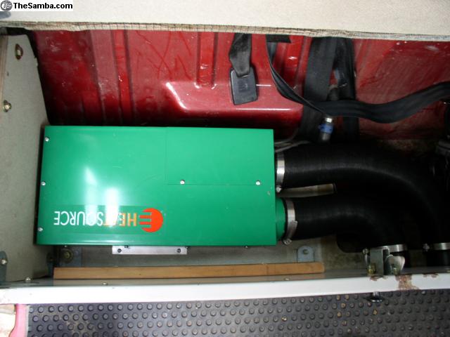

Been distracting myself with motorcycle stuff lately. I needed a break from the bus as it was starting to not be fun. Now, winter is closing in and even if I do get it running, which I will, it will not be able to be driven without heat and defrost. So, I am now planning on buying a Propex heater for it. In the long run, this will make things better as I can drive whenever and do not have to divert time into my wacky heater design. This will not be cheap, though.
Here is the plan:
- 30lb horizontal propane tank in enclosed storage on floor against drivers wall in passenger area. I have checked into this and it only needs to be secured from moving, enclosed, and have a 4x4" vent to the outside in the floor in case of leak.
- Propex HS2800 for approx 9700 BTU
- Bilge fan for forcing air into/out of the heater so the air will travel through the bus' plumbing.
I plan to mount the heater in the bench seat like here:

The propane canister is steel and measures 12.2"x 23.4" and stands 13" high.

Looking into the Espar heaters, I see more price and not much benefit. Propane is efficient and largely cheaper and will not effect my travel range. At $4/gal for gas, and living in natural gas territory, I am leaning towards propane. Also, I can use the tank to run grills at camp outs so another bonus.
Cost I am finding:
- Tank = $153
- Heater = $830
- Bilge blower = $25
