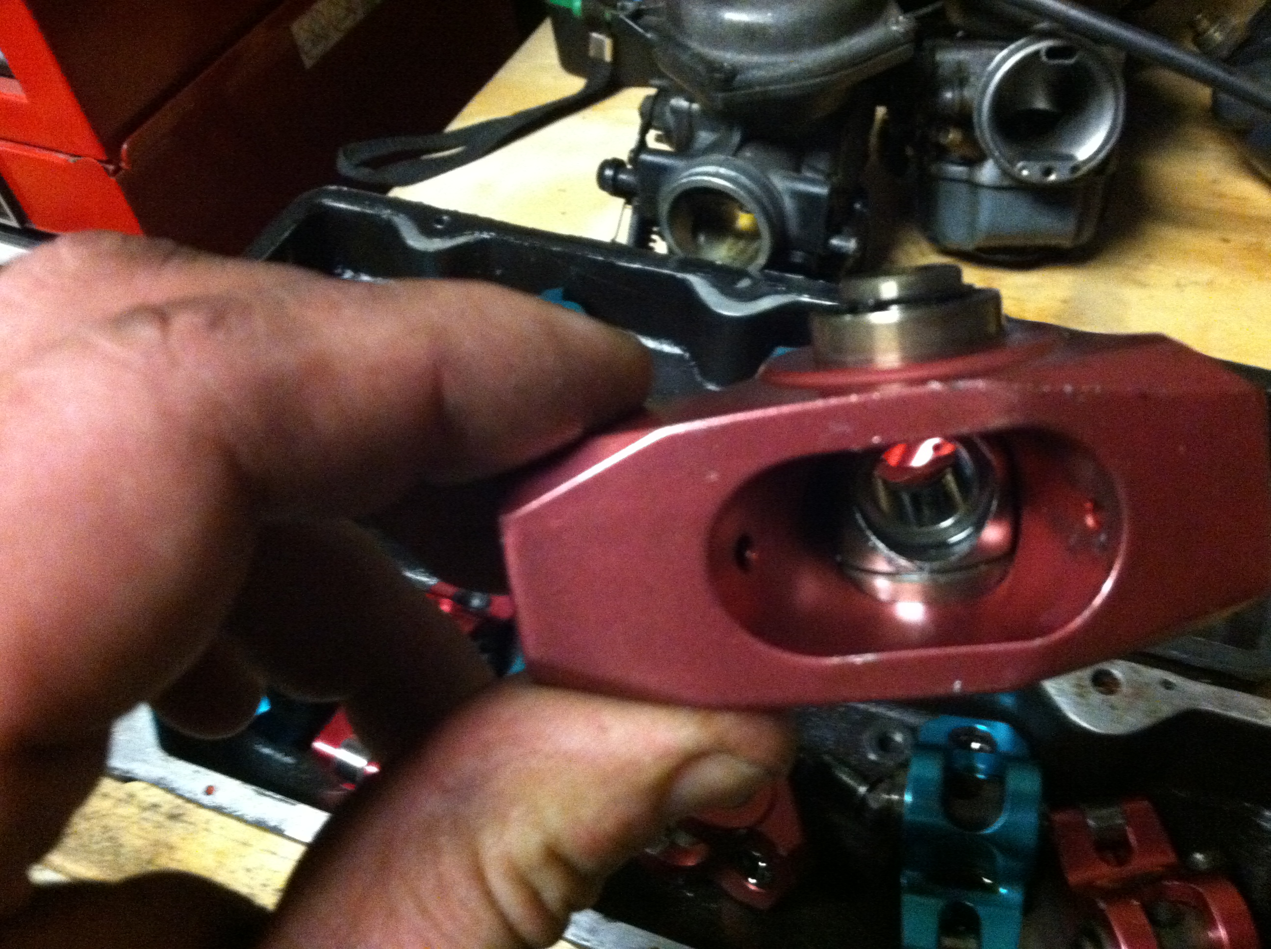

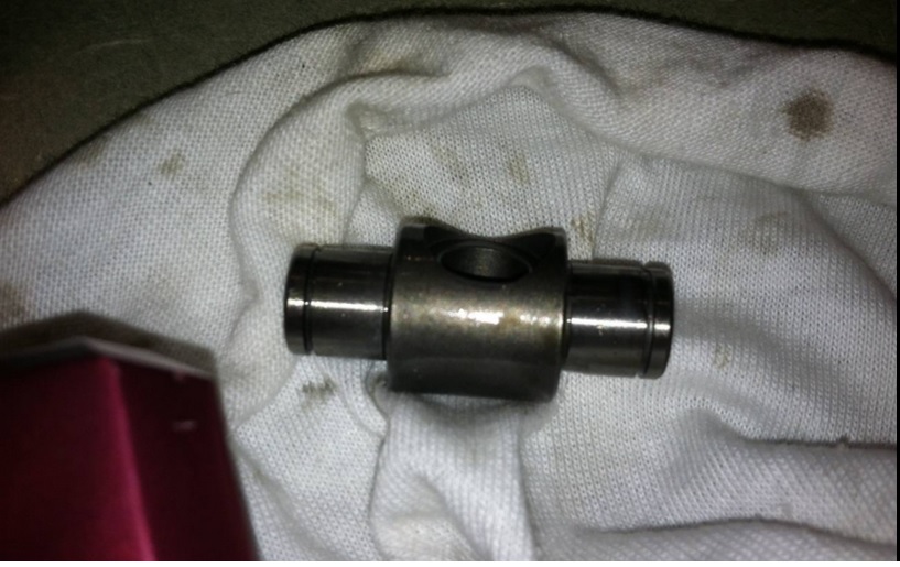

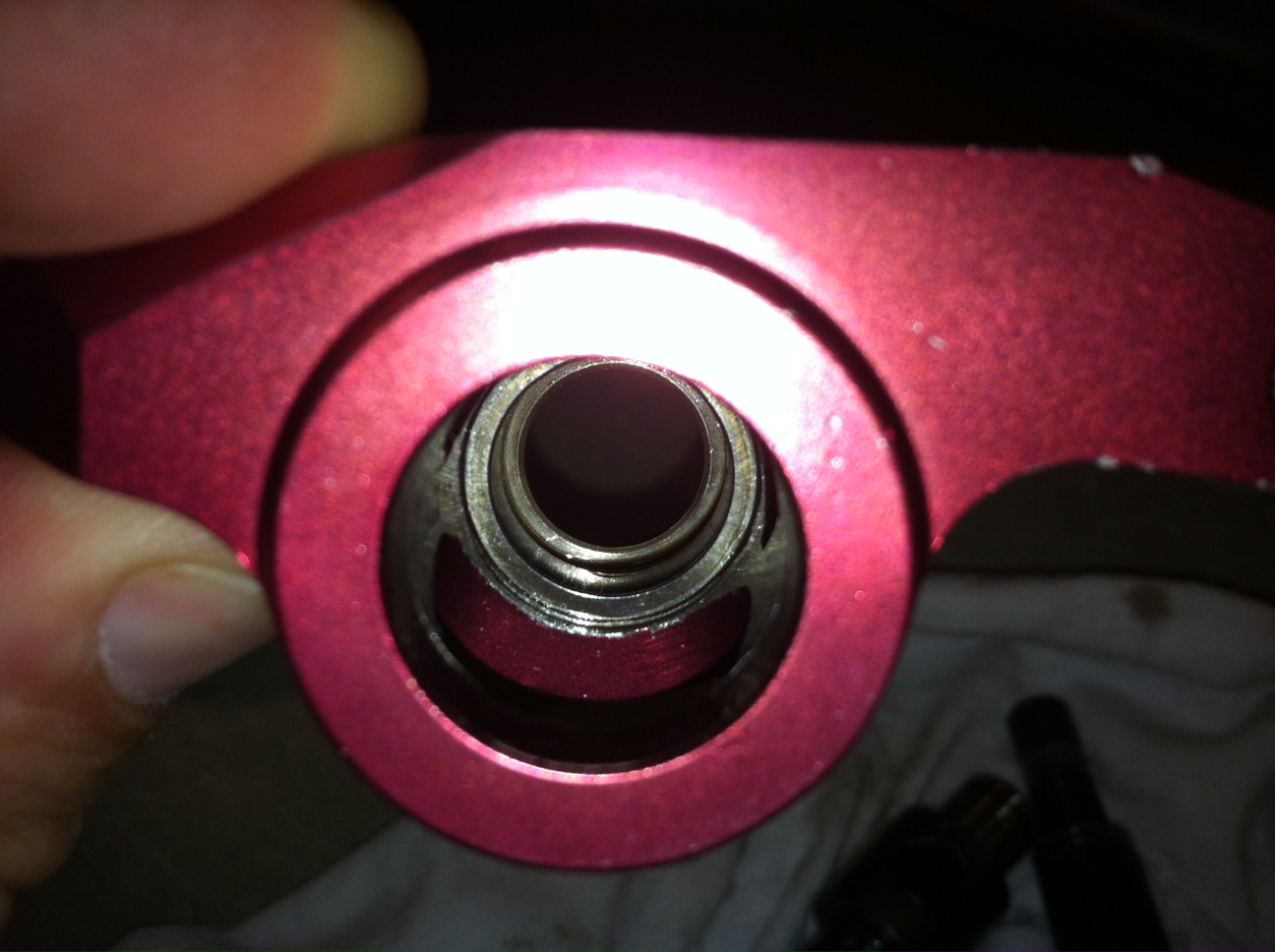

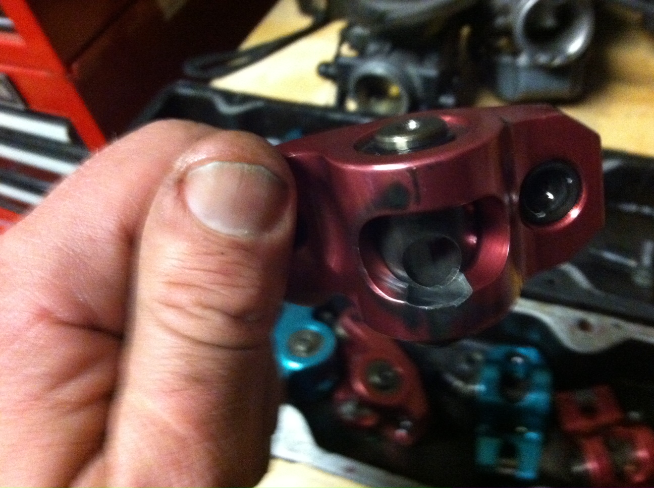

Well, shit. I was all set to get the replacement rocker installed and get back on the road today. However, I decided to take a better look at the remaining rockers. Most of them look like they were about to have the same failure. WTF?
The bushing that the needle bearing is held into is coming out of many of them, the rockers are migrating to the side for reasons I do not know, and rubbing on the stud. This is obviously what happened to the one that failed.
So, I removed all of them and am not sure what the hell I am going to do. I need to call the guy that sells this kit and find out why most of them are not staying centered.
