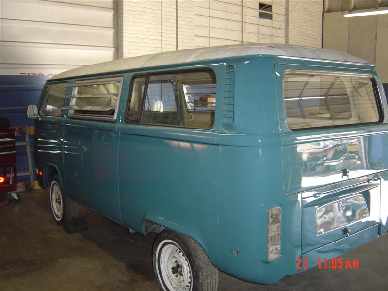

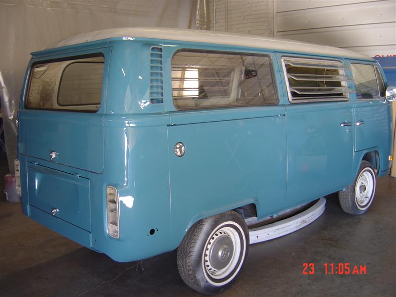

Windshield will be here Monday. (IMG:style_emoticons/default/smile.gif)

QUOTE(type11969 @ Jan 23 2009, 04:40 PM) *
Looks sweet! Where did you find the windshield? Did you find one that was completely clear or does it have the tint across the top?
Glass shop we use occassionaly is getting it for me. I don't know if it is tinted or not. I honestly didn't even think about that (IMG:style_emoticons/default/unsure.gif)

QUOTE(type11969 @ Jan 23 2009, 04:49 PM) *
Cost? Might want to ask about the tint, I've heard complaints about it from taller bus drivers, apparently the tint comes down far enough that they are looking through it all the time when driving.
But I've also heard that it is tough to get anything else new.
175.00, I'll find out Monday about the tint I guess, hopefully Mike won't (IMG:style_emoticons/default/slap.gif)

QUOTE(r_towle @ Jan 23 2009, 06:01 PM) *
What is the plan for the roof?
Rich
Roof will be done at a later date. For now it ( the bus ) will go back to the house until Mike is ready to put the engine in. That way he can drive it with the fixed roof so I can get the 914 done, make some $$$ and prepare myself for the roof " project " It really won't be that bad I just need to get some other things out of the way first, and he can enjoy the bus sooner.
