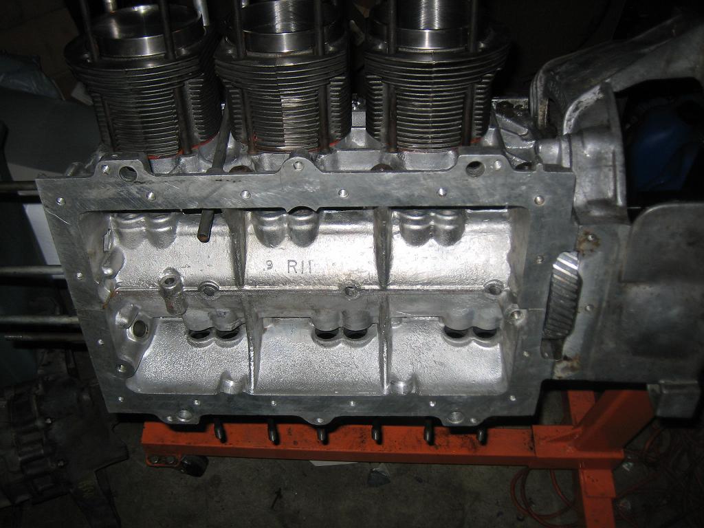

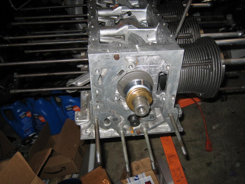

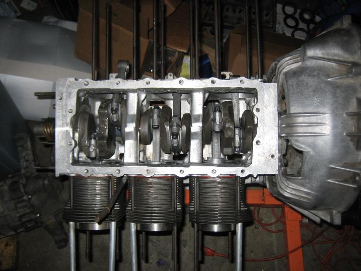

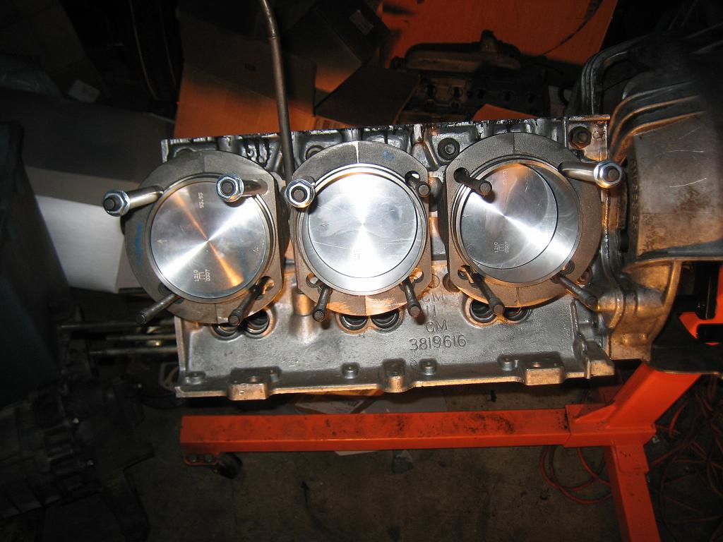

OK my hungering masses, some engine pics as promised (IMG:style_emoticons/default/smile.gif)

Enjoy the no maintenance hydraulic lifters.
6cyl air cooled /flat fan = cool (IMG:style_emoticons/default/flag.gif)

I am in lust for a case design like that...
WOW...never saw an open one before...

That is the first time I have seen the Corvair intake manifold. Two runners into the manifold then three intake ports. Doesn't look very efficient. One question: Why did they do that? (IMG:style_emoticons/default/confused24.gif)
I think I've heard that people cut off the manifold to fit triple throat Webers. From Jeffs phot it looks like you could fit a dual throat Weber if you had a suitable manifold. (IMG:style_emoticons/default/idea.gif)
And that engine case sure looks different form a VW/Porsche case. Very square looking. Interesting.

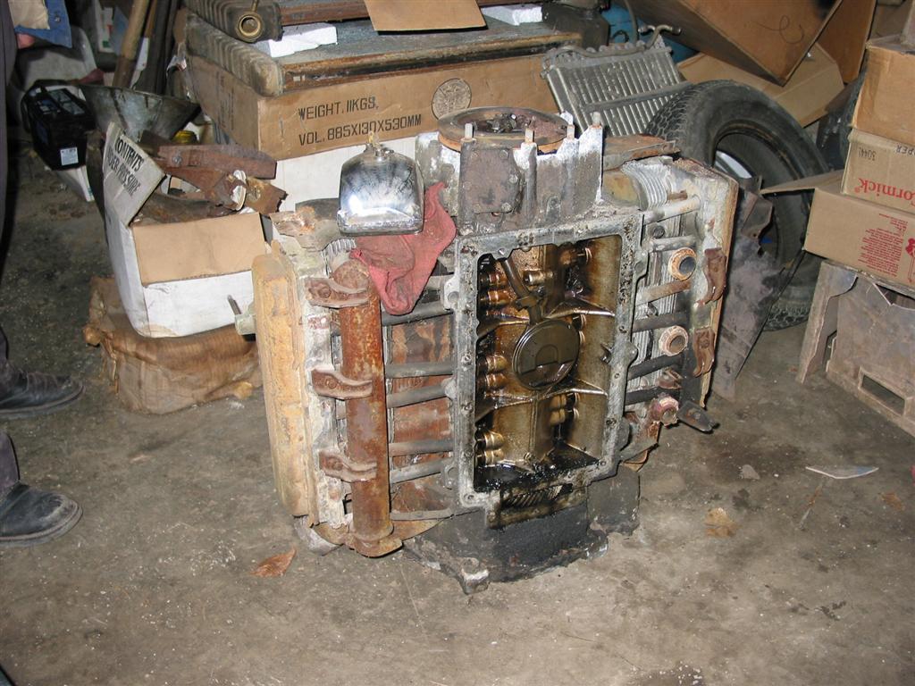

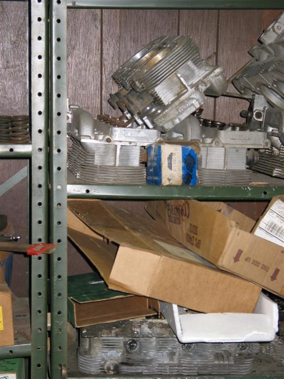

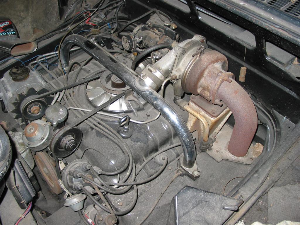

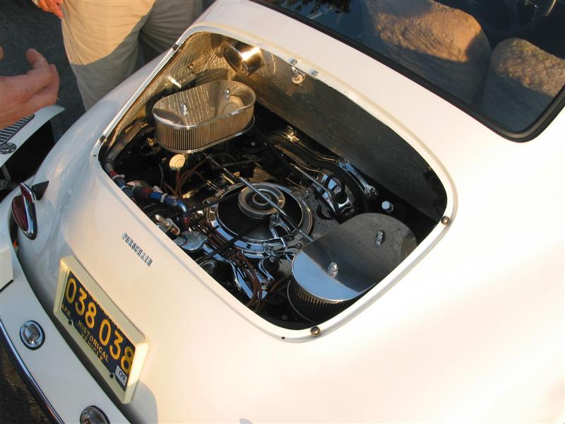

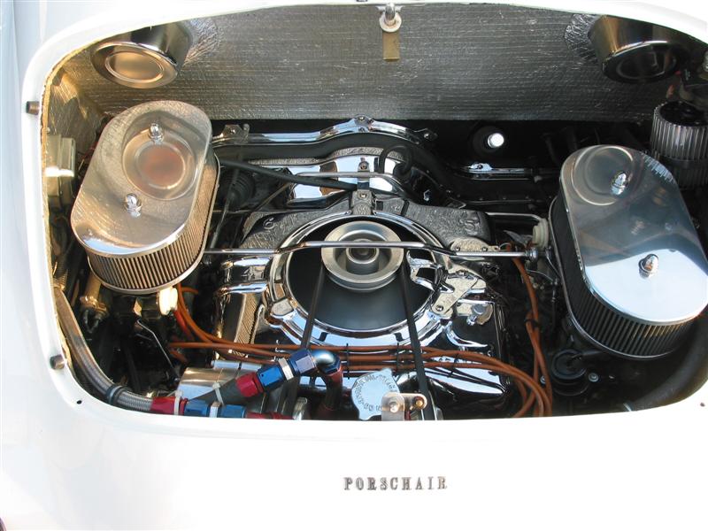

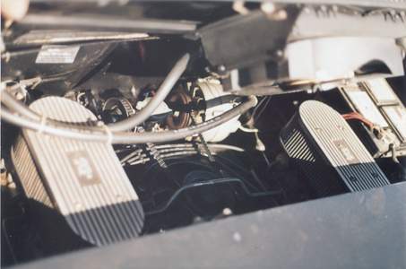

Hi Guys,
I thought I would throw in some Corvair pictures I took back in March 2005 just before they sent all this stuff to the dumpster. It's gone!! (IMG:style_emoticons/default/mad.gif)
Tom

Corvair motors with auto transmissions find their way into strange places. (IMG:style_emoticons/default/driving.gif)
Dr. Evil, Really enjoying this forum. (IMG:style_emoticons/default/popcorn[1].gif)

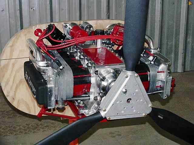

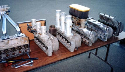

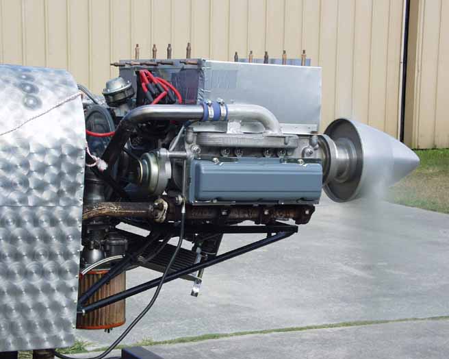

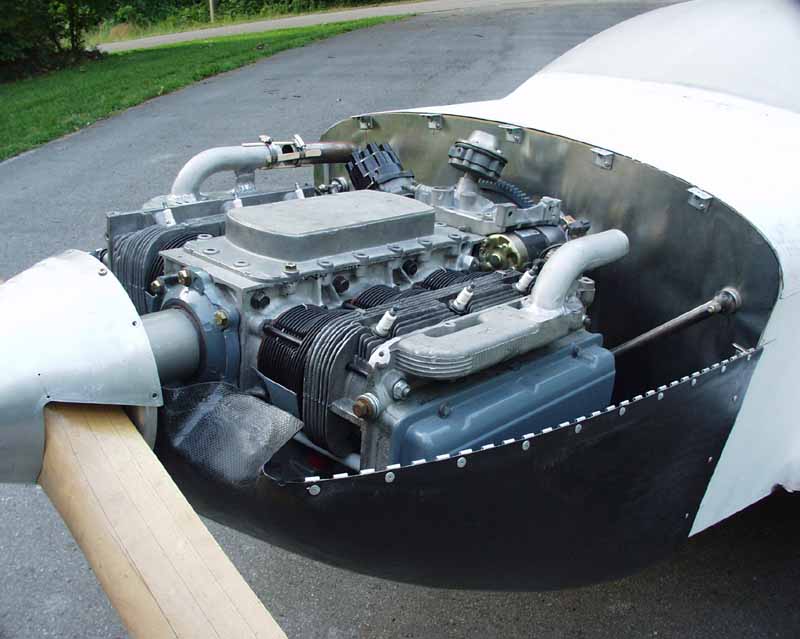

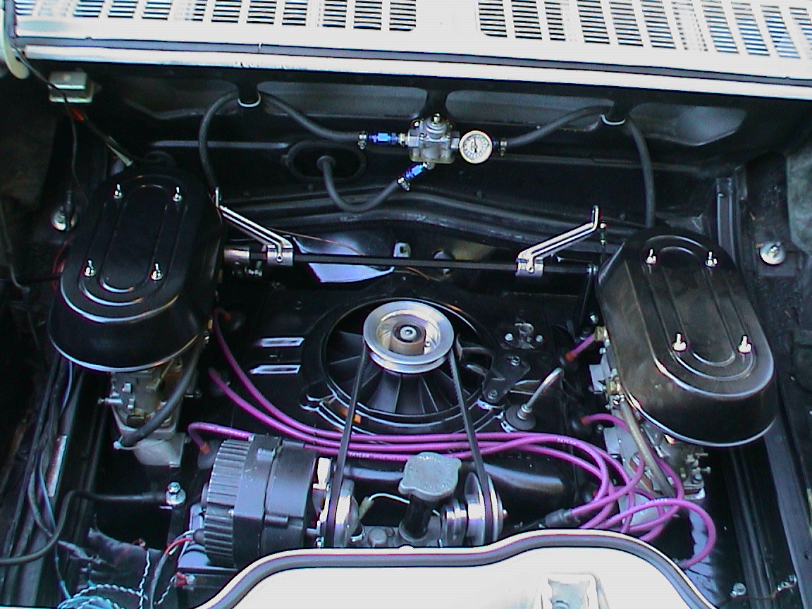

140 heads have seat problems, similar to our 2.0 heads and for the same reason, not much metal between the valve seats. There are many fixes, mainly you just need to install the seats correctly with .030 crush for one. I chose the 110 heads because I wanted low end, off the line, and less worry about dropping seats. I actually am using 80hp heads, but the valves are the same and I have done some chamber tweaking. I have not spent too much on this and can do upgrades later if I want.
My first engine I was doing like this for a 914 got to kit stage with all the parts, it sold easily and I made money.
The heads are the week link without a doubt, but they can be worked pretty easily. They cant be too bad, they are coveted and used in home built planes often.
Reworked heads
In a teener
With tripple webbers
