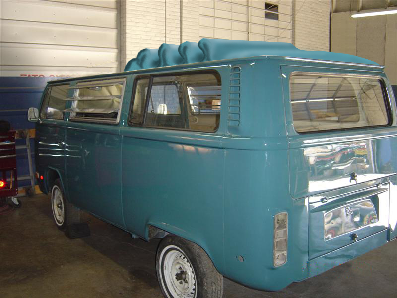

QUOTE(r_towle @ Feb 8 2009, 11:18 PM) *
QUOTE(Dr Evil @ Feb 8 2009, 12:33 AM) *
Looking at the pics again and the roof looks really bad compared to the rest of it (IMG:style_emoticons/default/poke.gif)
Send him another check...
Get r done.
Rich
He isnt doing the top because we are going to cut it off and put the camper top on (IMG:style_emoticons/default/smile.gif)

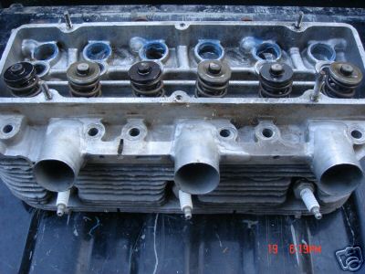

Hey that top picture is from starr cook, off road racer .
Wallin Piper was making some individaul heads for the vairs and starr has like the only finished set.
Dont get me wrong DR. I have had plenty of success with em just noting the weak link, When you could buy a whole 64 turbo spyder car for 150.00 dollars those head mods were out of the question.
Back in the day.

Ya, those heads are off of Starr's old web site. He still makes stuff and sells it on ebay. He has skills, but is kind of an arrogant SOB (IMG:style_emoticons/default/dry.gif)
Here is where I will likely end up with mine, 6 runners with one 4bbl (IMG:style_emoticons/default/smile.gif)

Hey Doc - according to what I've read - and this may be similar to the T4 engine, it's way too easy to get extra fuel into the 'Vair, even without doing much headwork. The key to making power is cleaning up the exhaust flow out of the heads. This requires angle-cut ports and special outlet tubes. Without that, it's basically bottle-necked. That's one reason I bagged putting the 'Vair into my buggy - way too easy to get into a couple grand into just headwork to get into the 200+hp club.
Your engine should make tons of torque though, should be perfect for the Bus!

Jeff,
do you recognize that case? (IMG:style_emoticons/default/wink.gif) It was yours once. The heads can be done for not too much if you have friends (IMG:style_emoticons/default/smile.gif) I have Root to do my head welding and working and my contacts at Feaser's machine shop in Hbg.

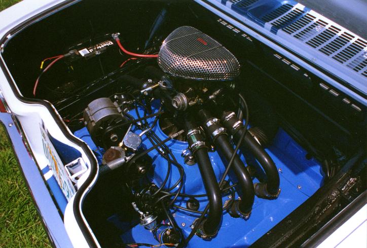

QUOTE(maf914 @ Feb 9 2009, 11:46 AM) *
That is the first time I have seen the Corvair intake manifold. Two runners into the manifold then three intake ports. Doesn't look very efficient. One question: Why did they do that? (IMG:style_emoticons/default/confused24.gif)
I think I've heard that people cut off the manifold to fit triple throat Webers. From Jeffs phot it looks like you could fit a dual throat Weber if you had a suitable manifold. (IMG:style_emoticons/default/idea.gif)
And that engine case sure looks different form a VW/Porsche case. Very square looking. Interesting.
NOT that I am dising (IMG:style_emoticons/default/chair.gif) the effort or engine but it sure makes you appreciate the German counterpart!

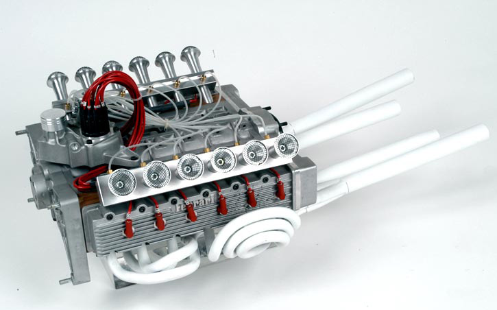

In a way the case reminds me of a ferrari case I saw apart.
This one is a working model, 8hp at 10,500 rpm
