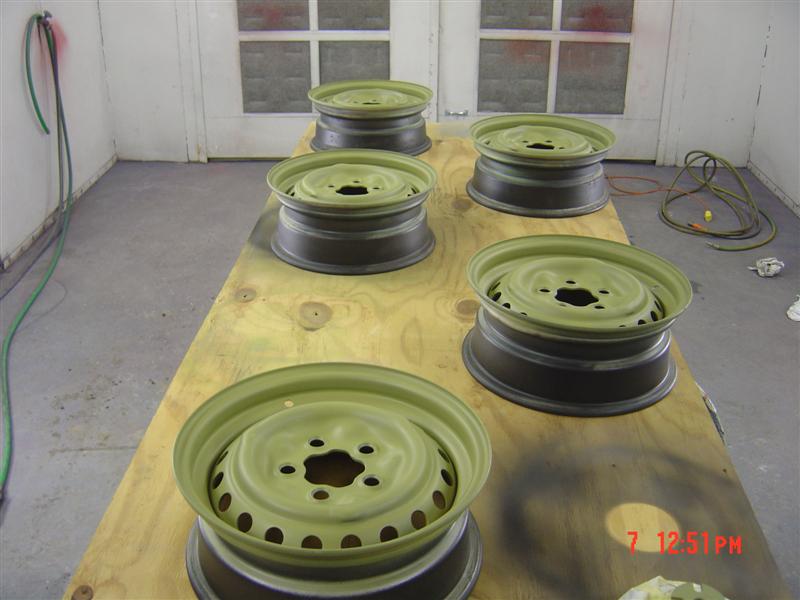

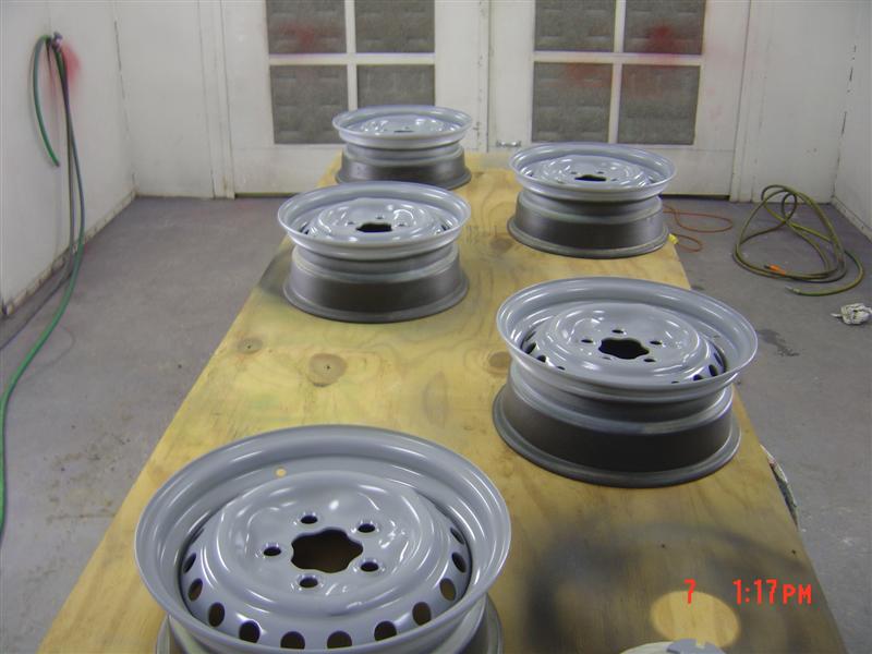

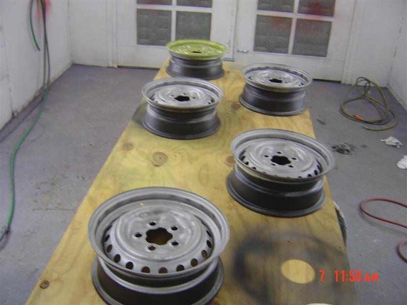

Blasted the fronts, etched, sealed and blakced out. I hit the backsides lightly and just gave them a coat of black.

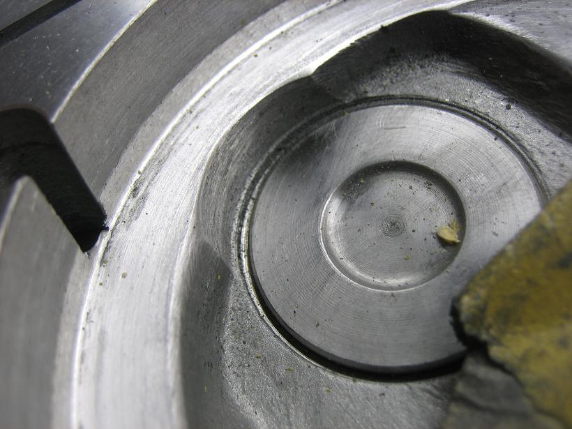

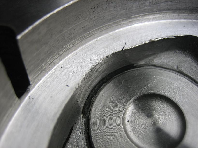

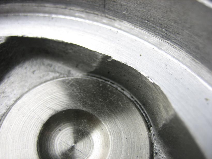

With the heads back from the shop and turned down to my calculated seat height, it was time to finish the heads; smooth the seating edges, CC and adjust as necessary.
You can see the sharp edges left by the machining. These edges are a great place for heat to build up and cause preignition.
Attached ImageAttached Image

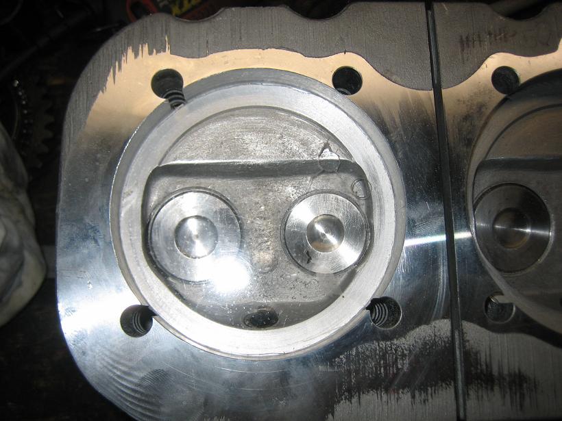

Here are the smoothed edges.

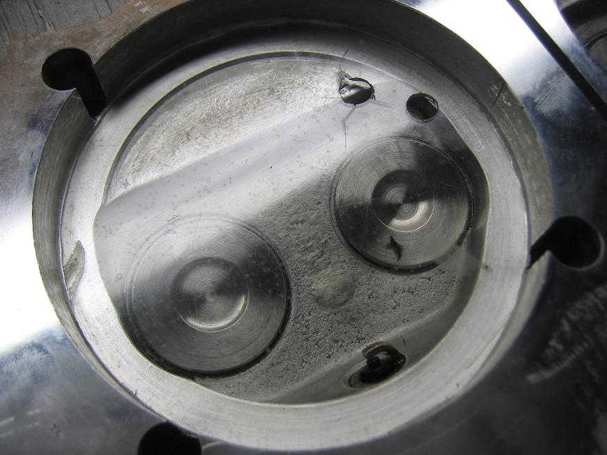

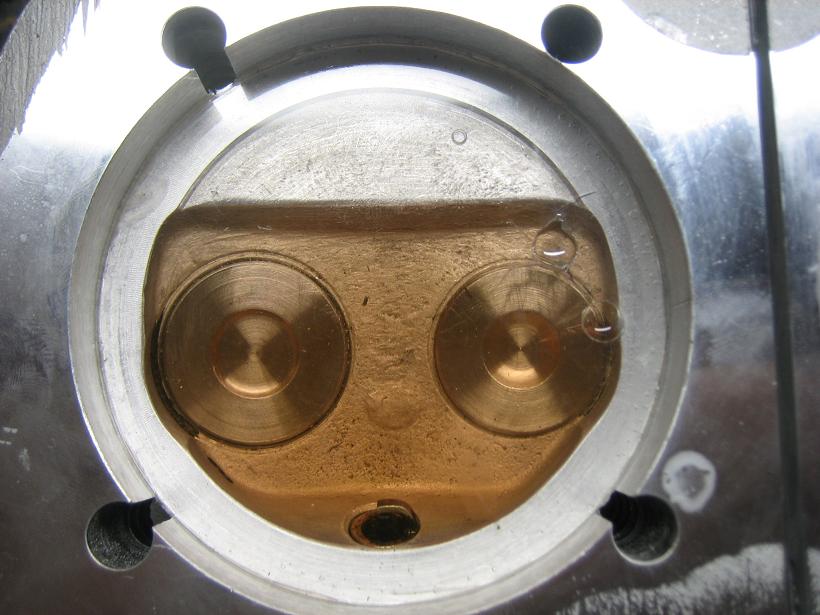

Here are the pics of me CCing the chambers. All was good as they were within 1cc or less, between 47-48cc for a CR of 7.5-7.6:1 (IMG:style_emoticons/default/smile.gif)

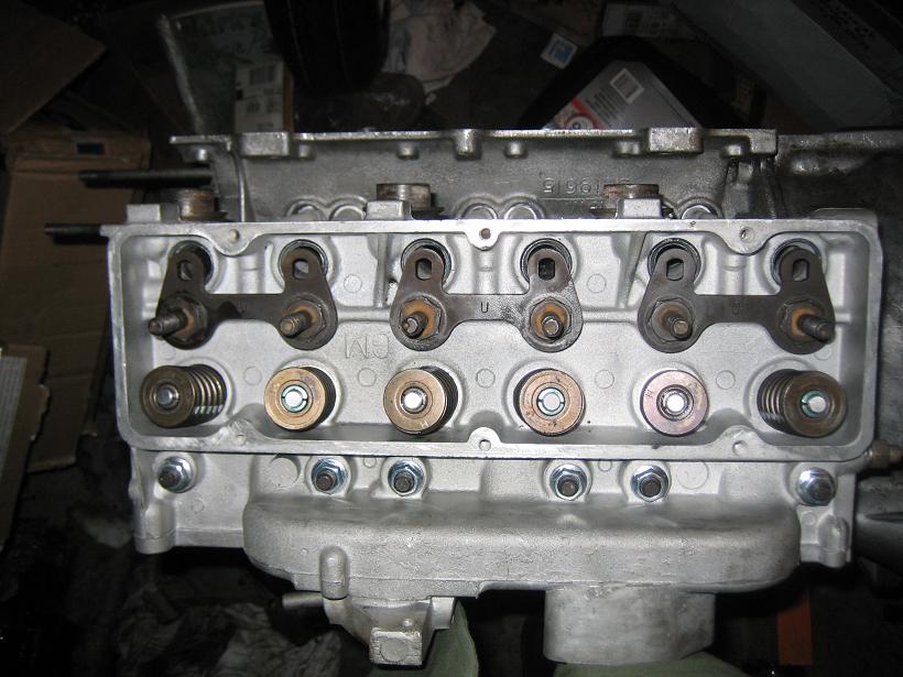

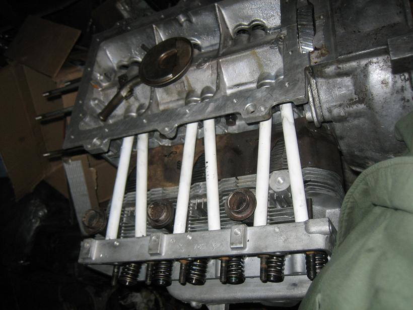

I got one of the heads on and things are progressing along nicely. This engine is pretty darn easy to assemble.

So uh what exactly what is up with that crack ithe first pic and those " plugs " in the others ? (IMG:style_emoticons/default/blink.gif)

I looked at that too Scott. The cracks are in the plexiglass disc he was using to cc the heads.

QUOTE(ws91420 @ Mar 15 2009, 05:33 AM) *
O.K. I see them in most pics but the one in that very first pic sure looks like it is in the head. Is my eyesight that off ? (IMG:style_emoticons/default/blink.gif)

Yes I have one a Lensley 914
Posts: 2,063
Joined: 10-September 03
From: Ruther Glen,VA (halfway between sticks and civilization)
Member No.: 1,137
No. It took me several looks before I realized what it was.

I think that is a bit of shaving from the machine shop. Its gone in the "smoothed" picture.

Zach gets the prize (IMG:style_emoticons/default/smile.gif) The pics are sometimes staged as I tend to get focused in my work and miss photo ops. In the pics you can see a piece of debris in the chamber that I removed after the pic as well. I'll try to get a pic posted of 1/2 of the engine done (IMG:style_emoticons/default/smile.gif) I have to read a whole book for tomorrows class....I started it at noon (doh).

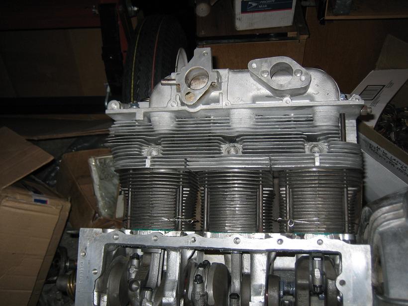

Here are 3 pics of the head installed (IMG:style_emoticons/default/smile.gif)
