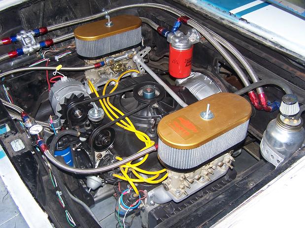

Corvair engines are cool. I really like the down the middle fan arrangement. The bus will giddy-up and go with a Corvair engine. What induction are you using for the engine?
This one uses triple carbs, I think they are webers. Estimated HP is about 275.

I am using a Holley 4bbl 390 cfm carb on an adapter with a Holley dial-a-mile electrically adjustable jet system (IMG:style_emoticons/default/smile.gif) I need to get an O2 meter so I can adjust my jets more precisely on the fly (IMG:style_emoticons/default/smile.gif)
My engine is 3.1L since I used 2.0L Type I p/c from a VW. It will move the bus and did not cost me an arm and a leg.

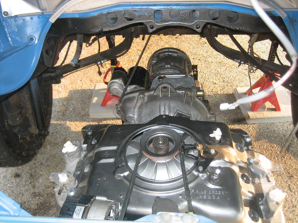

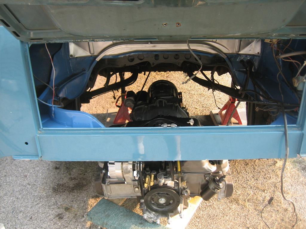

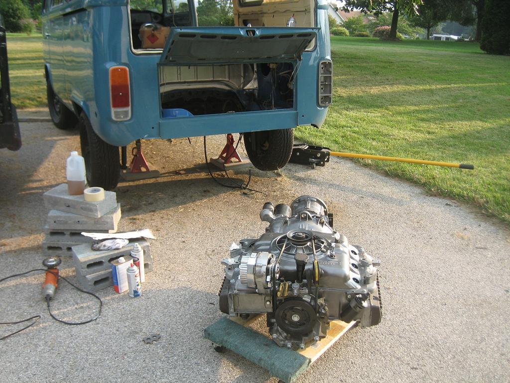

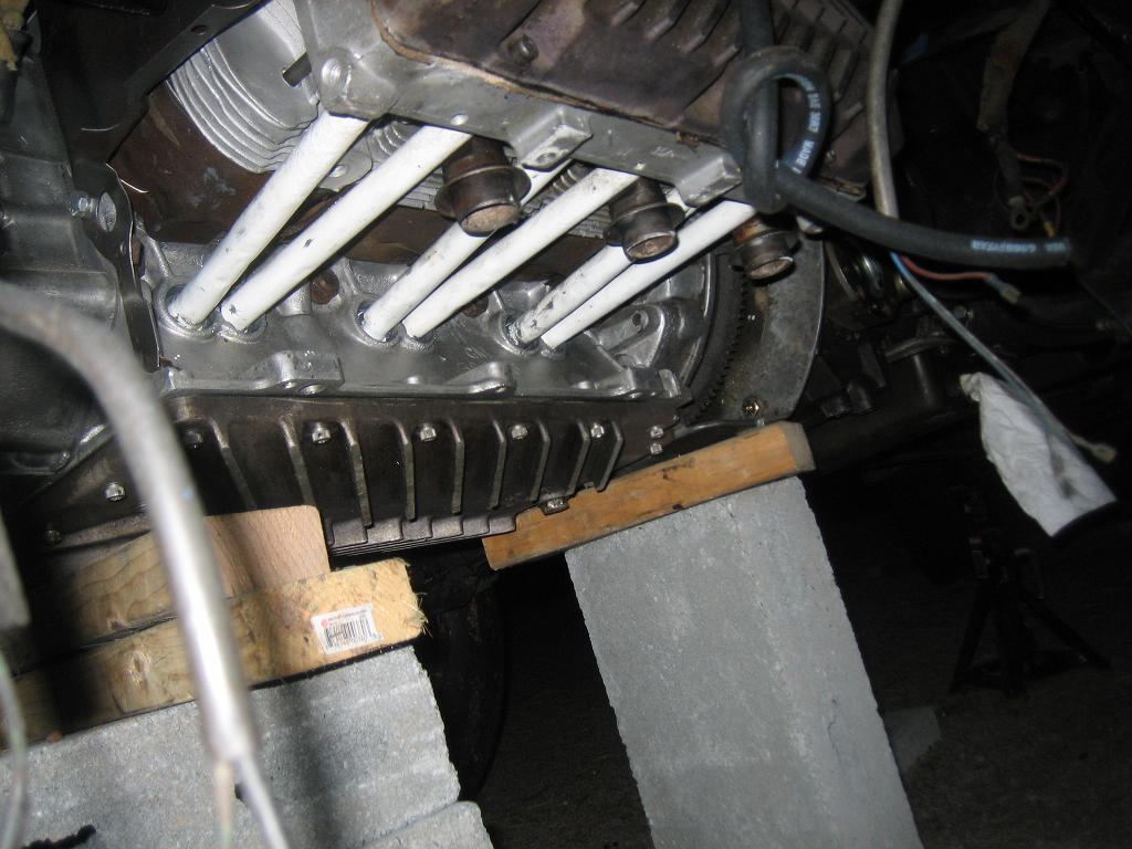

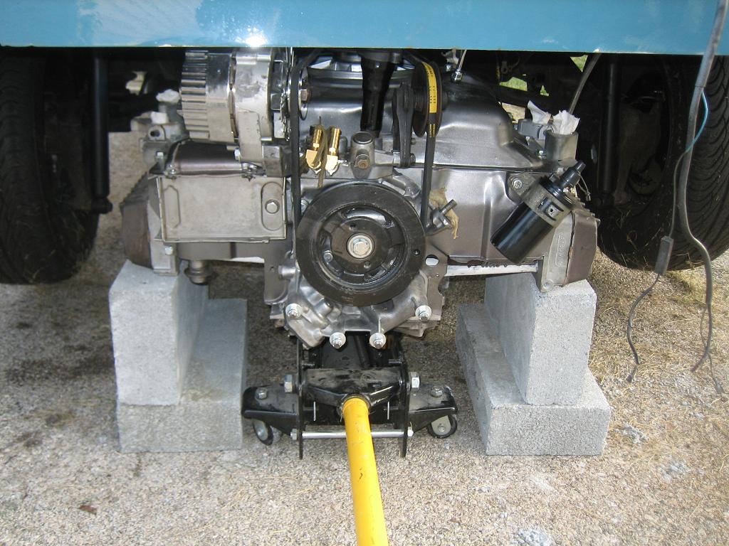

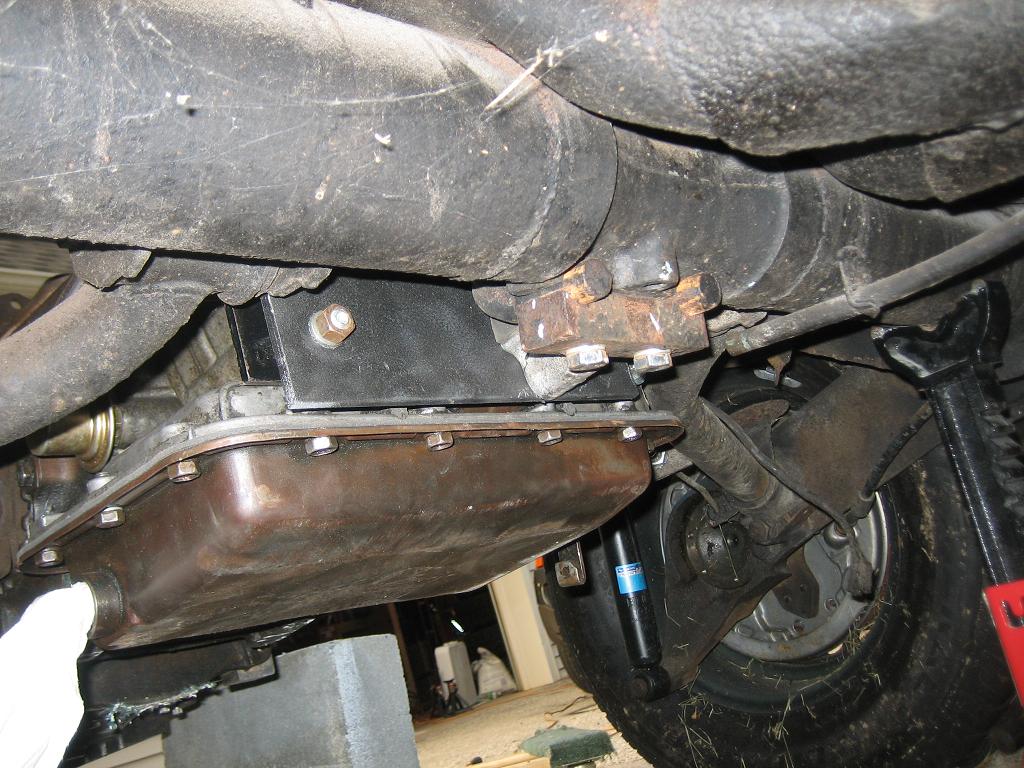

Today was very productive (IMG:style_emoticons/default/smile.gif) I had to modify the front mount a little more to get the drive train more forward so the starter would miss the rear cross bar, and my engineering actually worked! Now the engine in where it will live and is ready for the tin and engine bar to be mocked up after the exhaust is hung. (IMG:style_emoticons/default/smilie_pokal.gif)

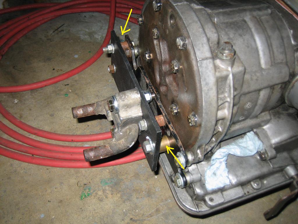

First is the plate I made to utilize the newer stock front mount on my bus. The mount setup originally had the spacers shown. They turned out to be to big and I had to shorten everything up so the starter would clear the cross bar. Arrows depict the space I shortened.
Engine on approach (IMG:style_emoticons/default/smile.gif)
Engine under bus (IMG:style_emoticons/default/smile.gif)
Dr Evil
post Aug 2 2009, 01:13 AM
Post #373
Send me your transmission!
Posts: 23,041
Joined: 21-November 03
From: Loveland, OH 45140
Member No.: 1,372

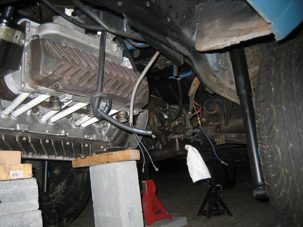

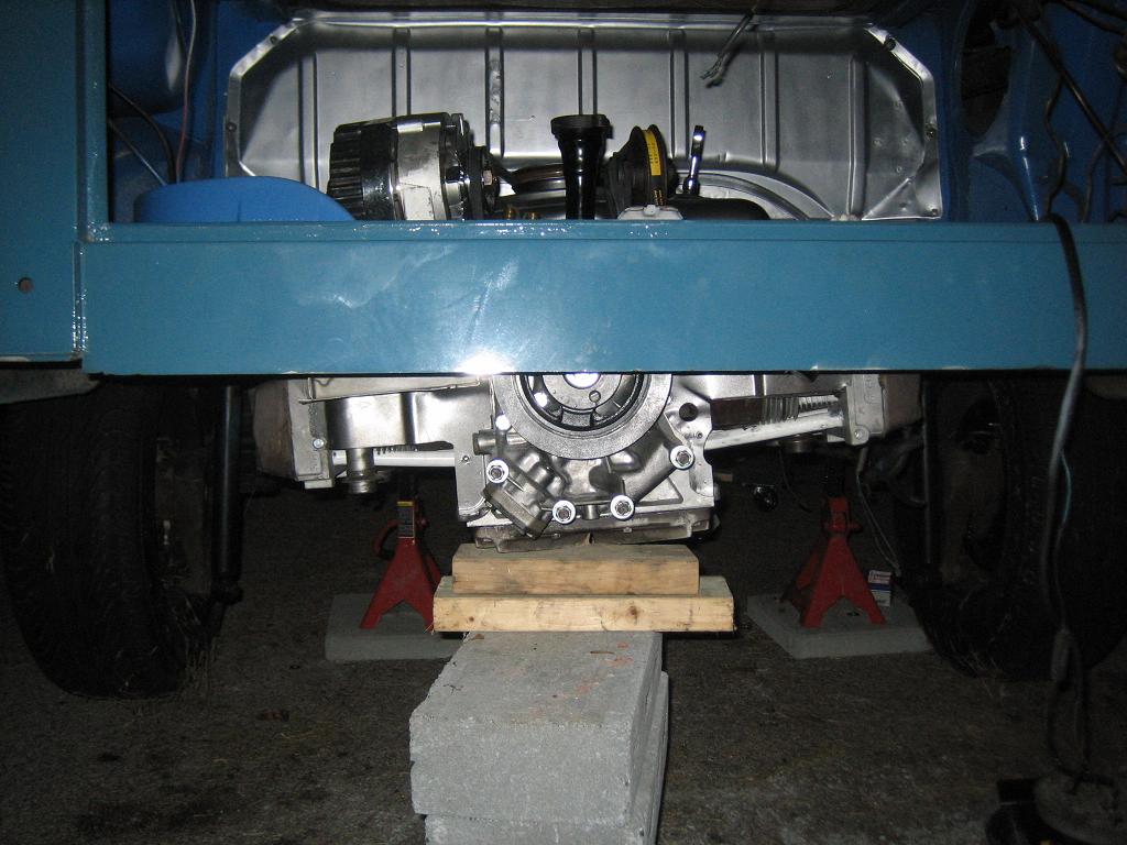

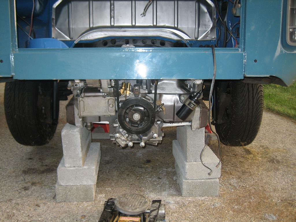

Under bus 2
Engine rising using my patent pending cinder block engine elevation system (IMG:style_emoticons/default/smile.gif)

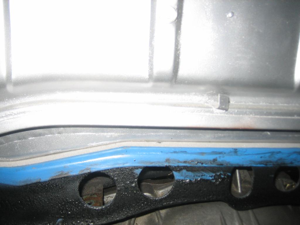

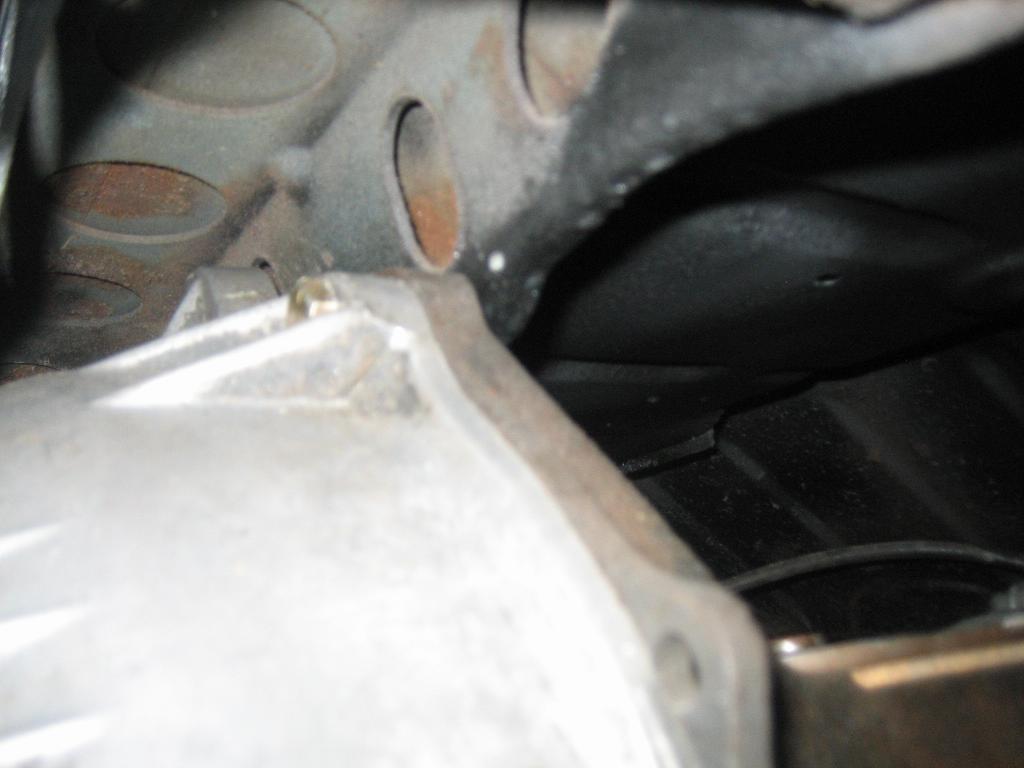

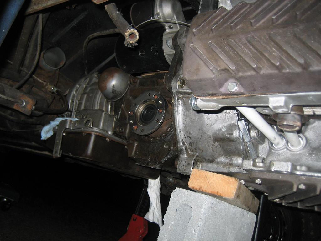

Here is a pic of the starter clearance issue. You can see the nose cone of the solenoid on the left where it can interfere with the cross bar.

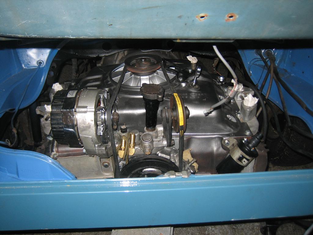

Here is the front mount mounted after I modified it for the last time (IMG:style_emoticons/default/smile.gif)
Engine up under driver side

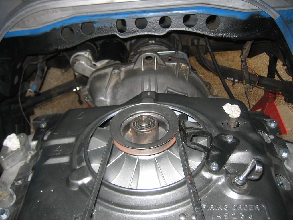

More under pics (IMG:style_emoticons/default/smile.gif)
Engine in! Sort of (IMG:style_emoticons/default/smile.gif)
Dr Evil
post Aug 2 2009, 01:28 AM
Post #376
Posts: 23,041
Member No.: 1,372

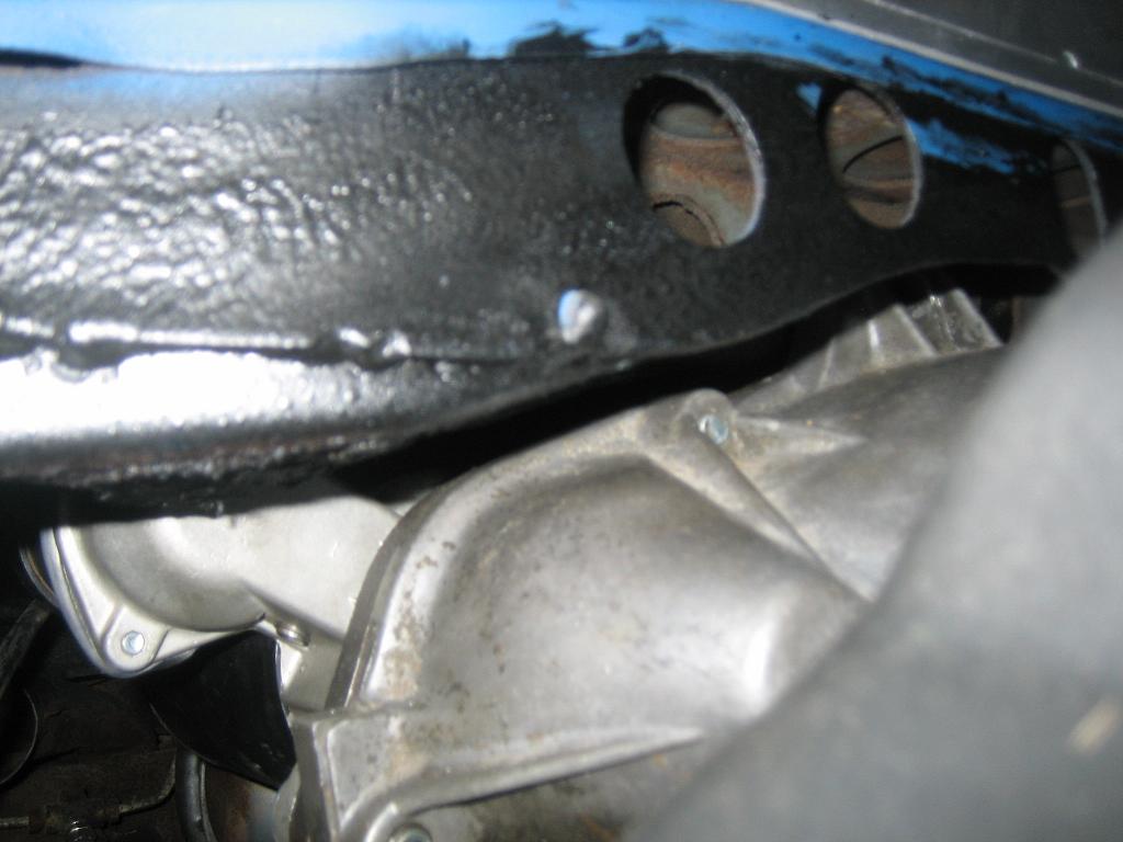

Ta da! This is where it will stay as it can not go any further up as the bell housing hits the rear frame bar.
Bell housing bar interference.

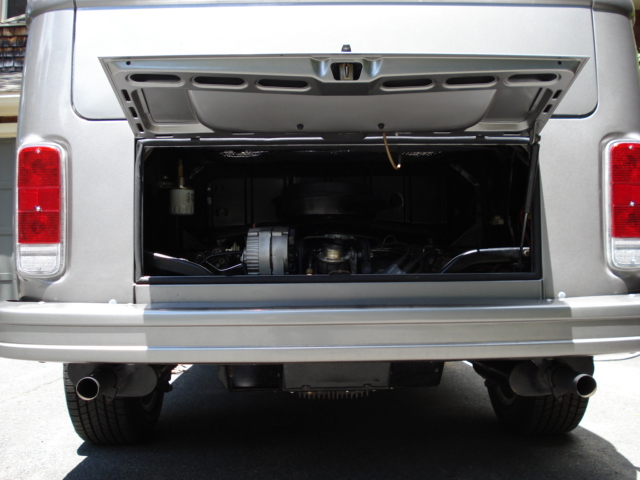

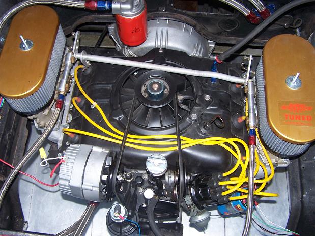

Engine height looks to be about right, though, compared to this excellent example.
