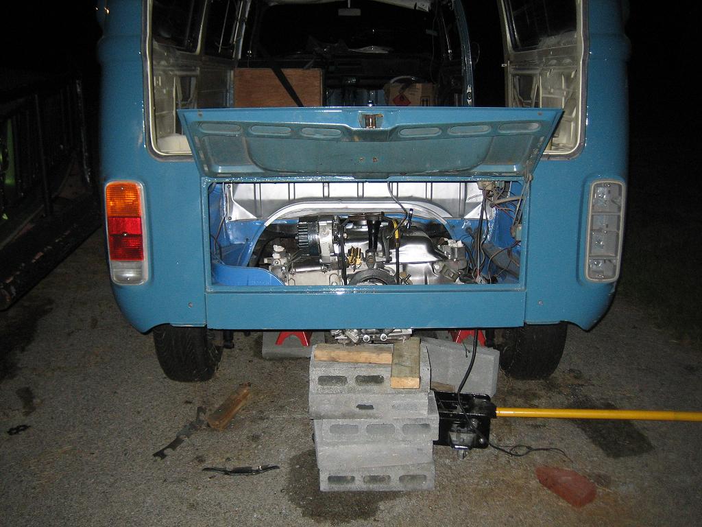

QUOTE(Dr Evil @ Aug 2 2009, 03:36 AM) *
Engine height looks to be about right, though, compared to this excellent example.
I Forsee a problem...
VaccaRabite
post Aug 2 2009, 12:41 PM
Post #382
En Garde!
Posts: 13,817
Joined: 15-December 03
From: Dallastown, PA
Member No.: 1,435
QUOTE(jsayre914 @ Aug 2 2009, 01:32 PM) *
What, you did not actually think we would drive it do you? This is just another installment of my redneck yard art.
Zach
Dr Evil
post Aug 2 2009, 12:49 PM
Post #383
Send me your transmission!
Posts: 23,041
Joined: 21-November 03
From: Loveland, OH 45140
Member No.: 1,372
Reverse entropy does not require that it move under its own power, only that all parts eventually be assembled in one lump (IMG:style_emoticons/default/dry.gif)

seems like there must be a better starter motor solution.
Given all the conversions that must have happened back in the day, I bet someone figured out how to clock the starter motor to lean the solenoid down at 7 oclock instead of its current position at 11 oclock.
Rich
Dr Evil
post Aug 2 2009, 01:29 PM
Post #386
Posts: 23,041
Member No.: 1,372
The starter is a non-issue now. The limiting factor is the contact of the bell housing with the cross brace. There are mini starters for the corvair, but they are like $700, which is fricken ridiculous. By lowering the nose of the tranny, I can raise the rear of the engine a little more.

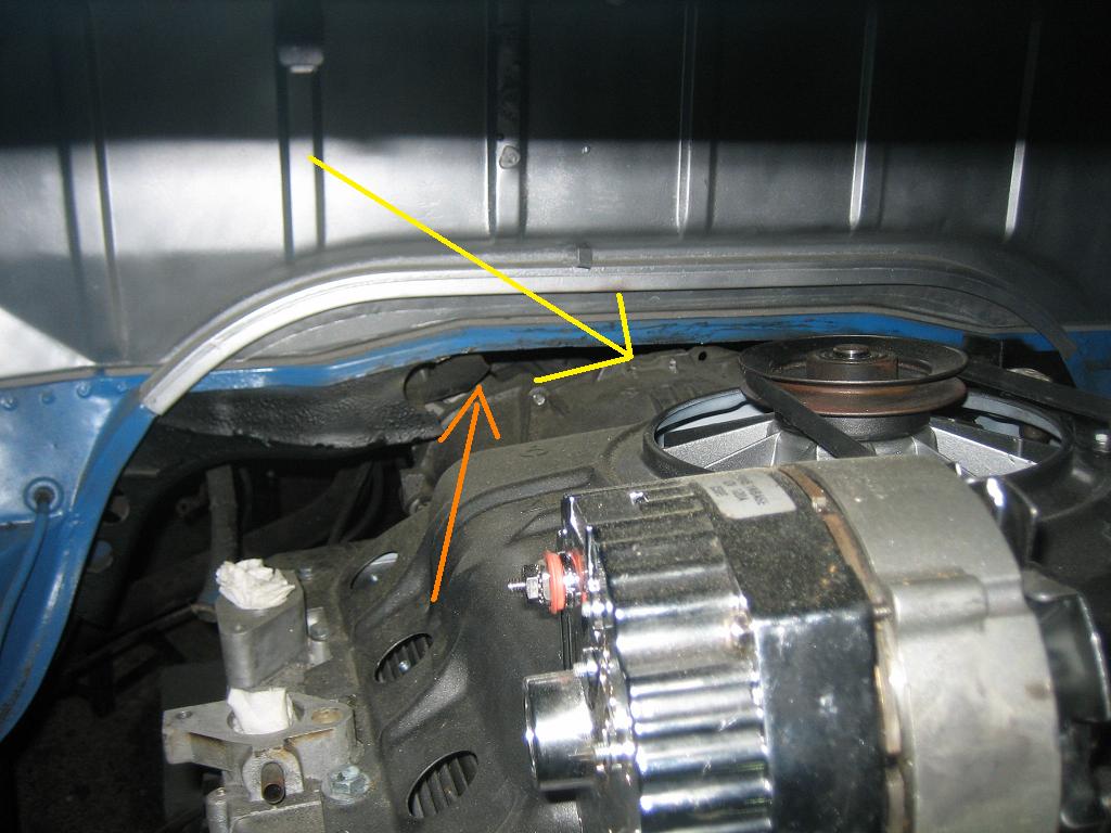

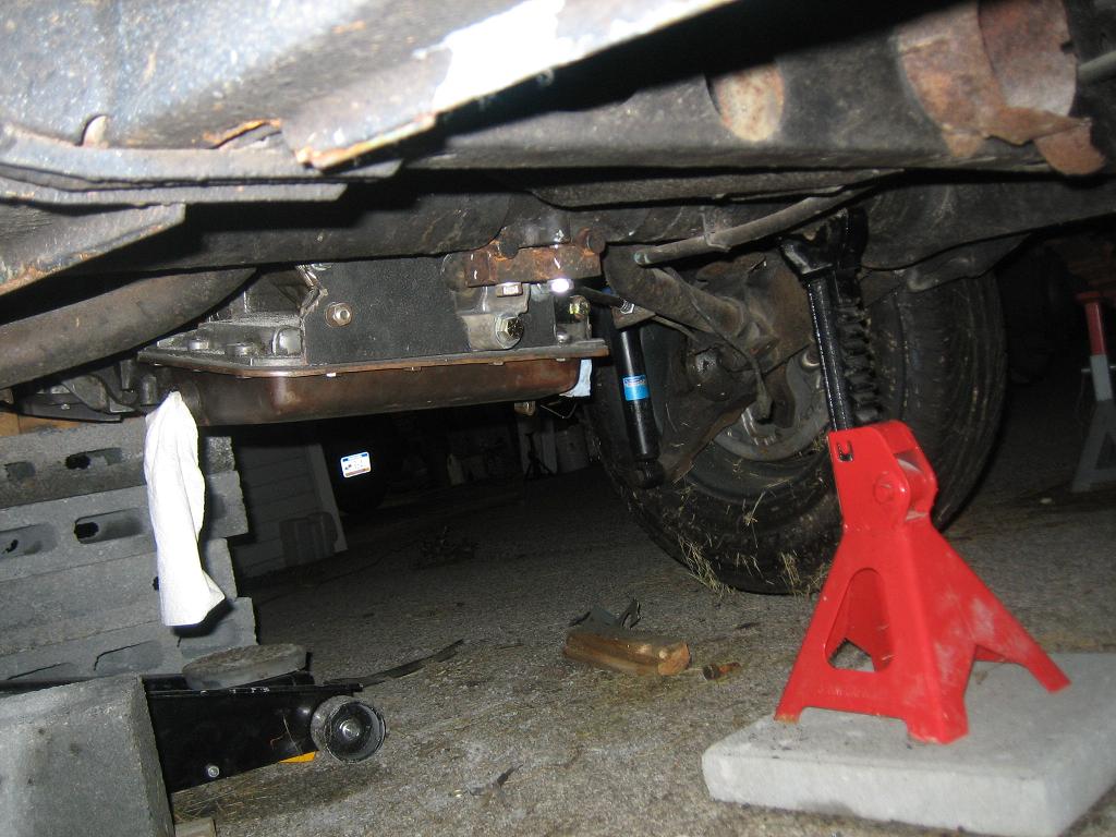

Yup, I flipped the front mount to lower the front of the drive train, cut the eye off of the bell housing (like I am ever going to use a cherry picker with this), and cut the offending metal after determining it was not a structural part of the bus so much as it was a part for the original tranz to hang from. It worked well (IMG:style_emoticons/default/smile.gif) See for yourself.
Flipped front mount.
Yellow arrow is where the eye was for the picker, orange is where the offending metal was removed. It was hard to cut (emotionally), but it had to be done.

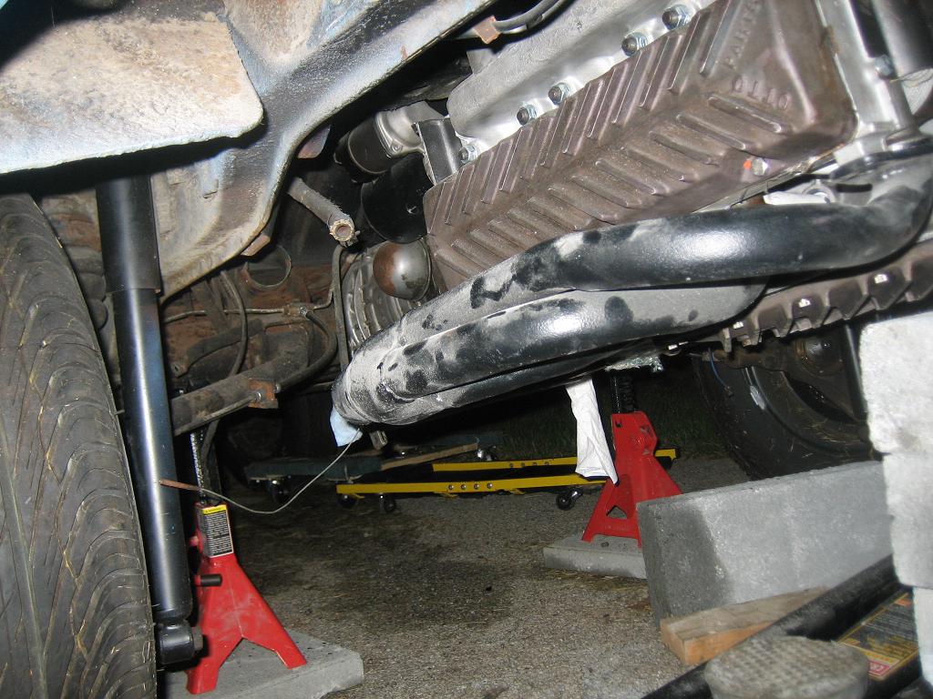

Here is one of the headers mounted.

Why do you have your headers bolted on facing forward? Don't you want them facing aft? Or does the rest of the exhust go forward and then loop back?
Zach
Dr Evil
post Aug 3 2009, 08:41 AM
Post #399
Posts: 23,041
Member No.: 1,372
QUOTE(Vacca Rabite @ Aug 3 2009, 10:38 AM) *
Zach
Ding ding, give that guy a cigar! If I face them aft the opening of the collector is at the same level as my bumper. LOUD. It has to have a 180 U installed. I forgot when talking about the O2 sensor placement. This will make it easier.
