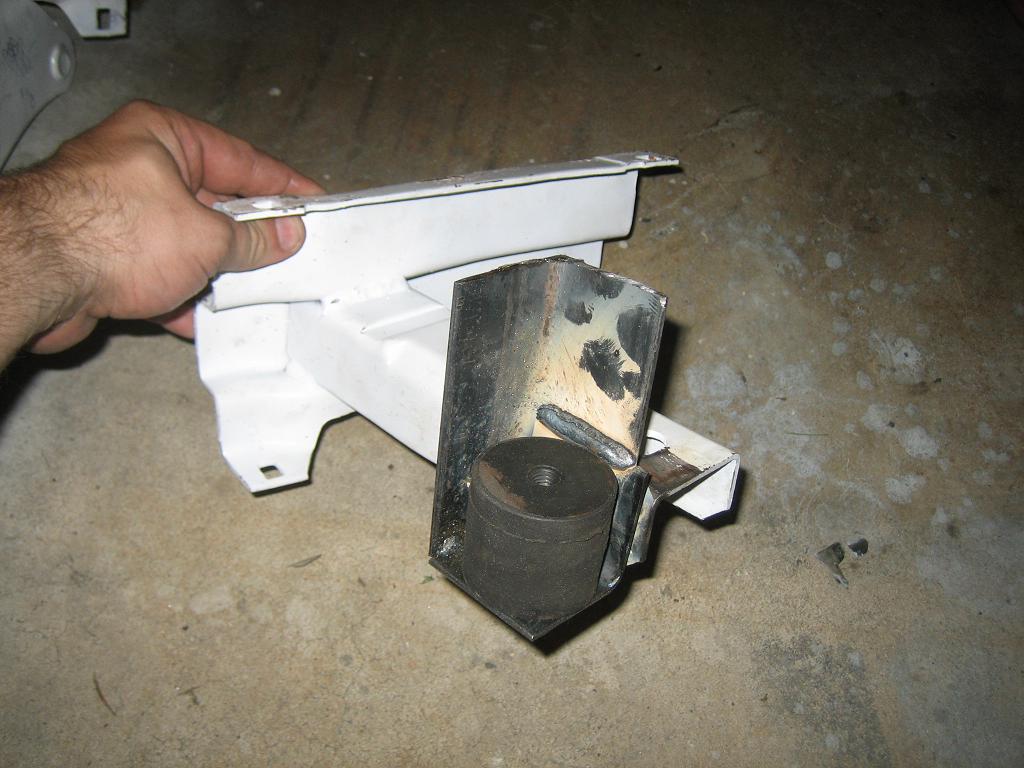

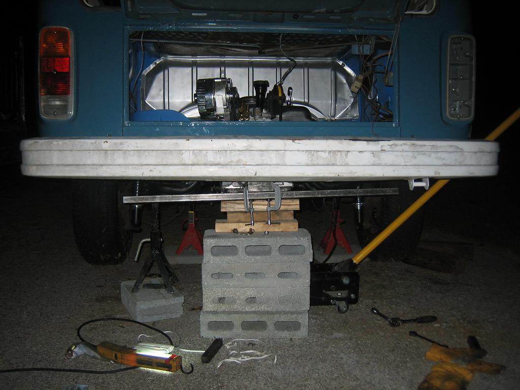

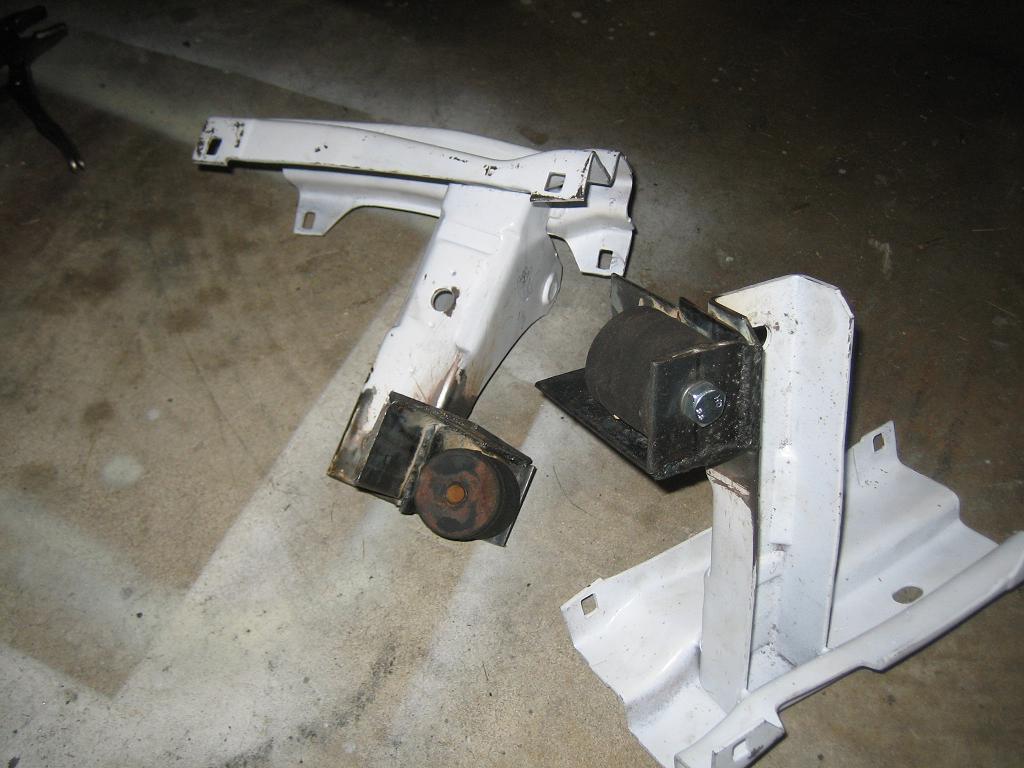

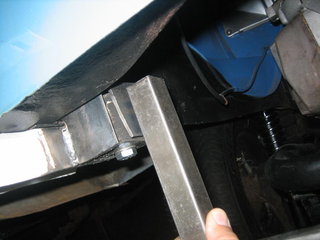

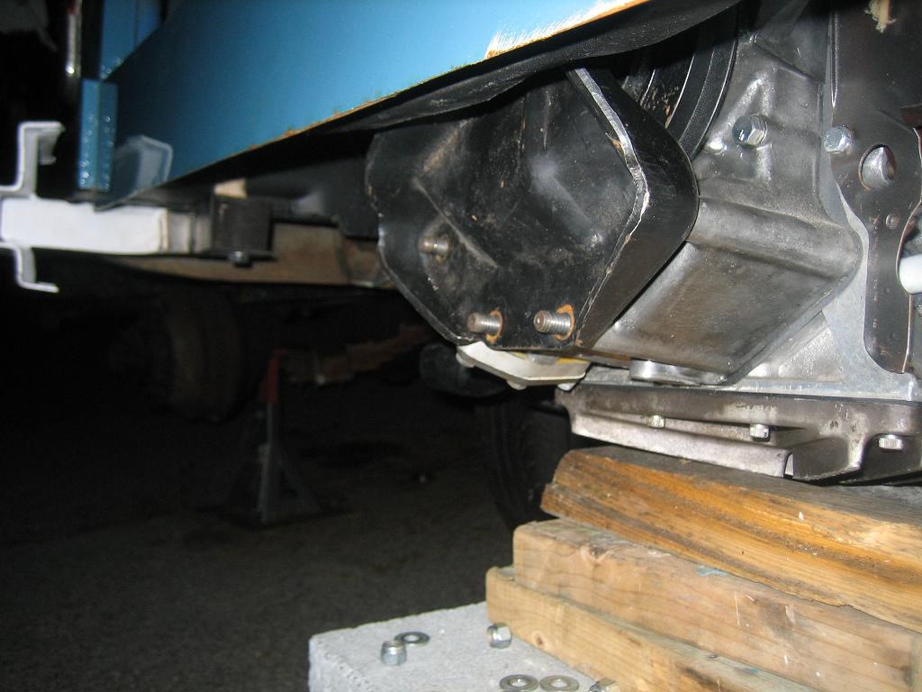

Pics of Bus progress from tonight. I'll let Evil explain what everything is.

Fabbing up the engine mount bar.
This took several days of creative thought before we started welding htis evening. Went through about 9 other ideas before we came up on this super simple and STRONG one. Mike can tell more.

Yup, Zach came up with the smart and kick ass looking idea to run the mufflers up forward, since that is where the headers point out anyway, and have the pipes point out in front of the rear wheels like a hot rod. This looks cool and frees up a lot of space in the rear.
The engine bar will be attached to the bumper mounts with an addition of a large bolt on each side. More to come later on this....I hope tomorrow (IMG:style_emoticons/default/smile.gif)
The door and hatch were painted and ABS panels were installed after I laid down sound dampener and insulation.

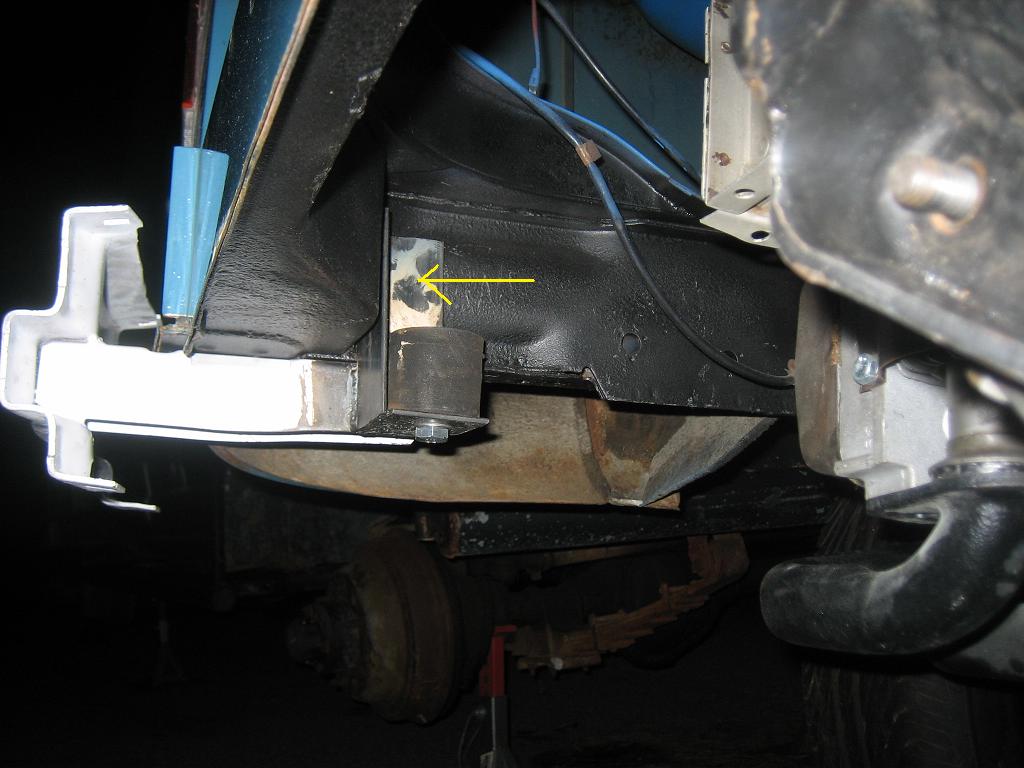

Here are the progress pics from tonight. The mount we devised utilizes the original tranny mount rubber pucks. The yellow arrow depicts where a 13mm bolt will be added to strengthen the mount to the frame.
Dr Evil
post Aug 27 2009, 11:04 PM

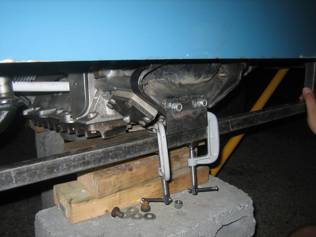

S'more

In the last picture, the engine is sitting cockeyed. That will be leveled when we are all said and done.
Also the clamps are there just until the super glue dries to join the metal bits together. They will be taken off before we bolt the engine on.
