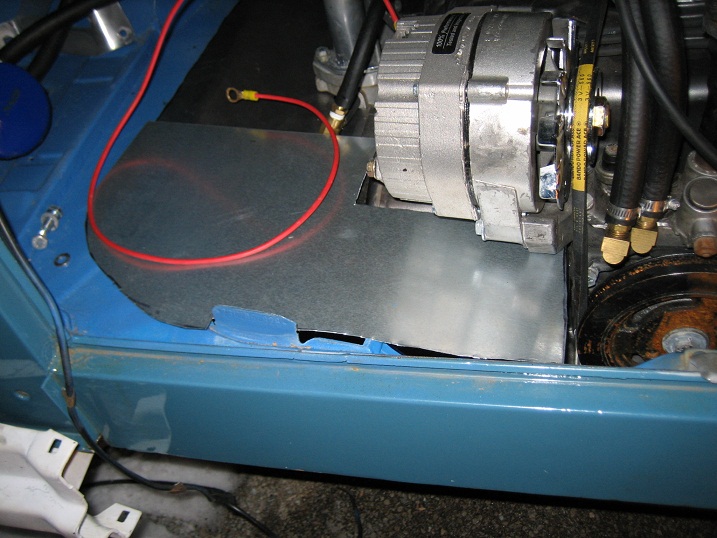

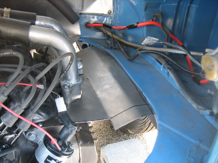

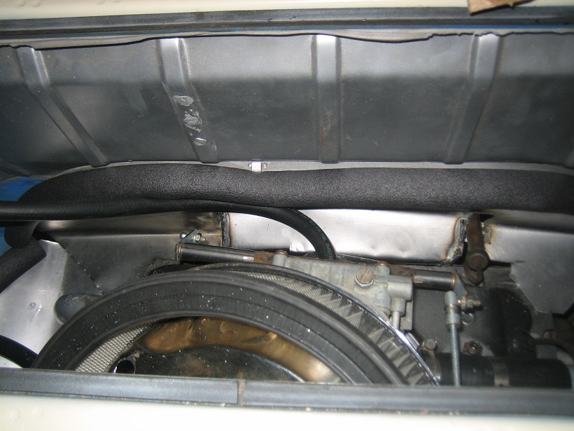

The tins are just mocked up and will be finalized once the engine is fremoved again for finalization.

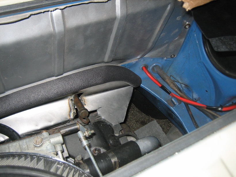

And with foam seal. I am using a $3 pack of insulation from wally world.

I think the filter I am using is a 14x3. If I can get a 14x2, which is the smallest I can find in the 14" dia size, then I will be pretty well off with the current setup. I do not wish to lower the engine one inch simply to change the damn filter (IMG:style_emoticons/default/rolleyes.gif)
Next trip should find the pass side tin done (the sides are very easy), and the rear one started (maybe finished, but it is gonna need some engineering).

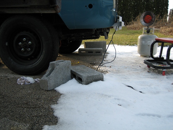

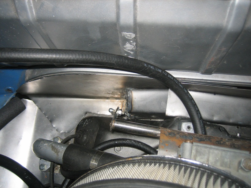

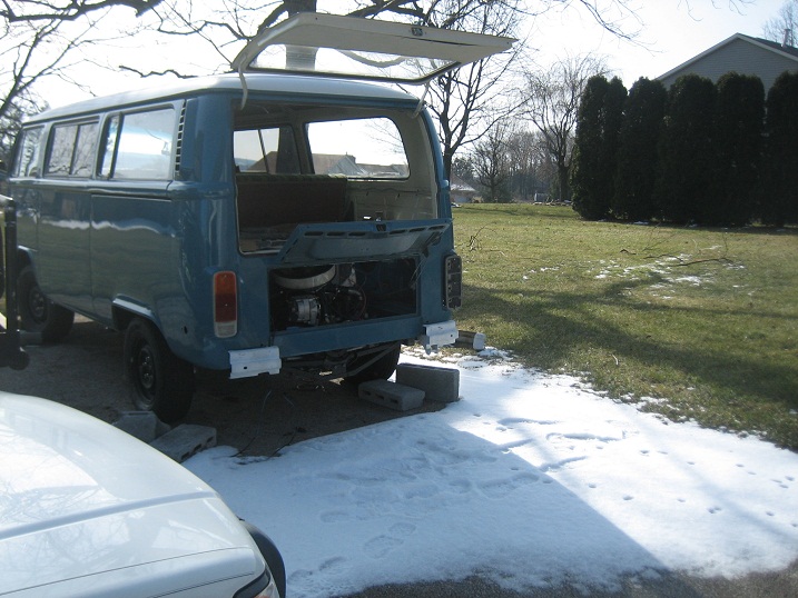

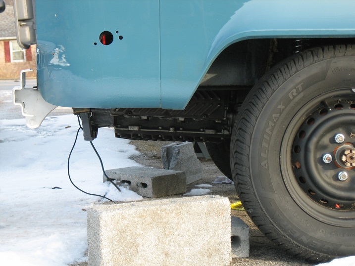

So today was pretty productive. I knew that the next few days would be boogered by snow so I worked to get to a point where the engine could come out. That just meant that I needed to get the rest of the tin done, which I did. I resolved the air filter issue, but I will elaborate on that separately, it deserves its own explanation. The tin will not be completely air tight in the rear due to the way the engine and all the shit back there is. It will be tight enough, though. I do not foresee any issues.
This was the situation/weather today:
A better shot of the adjusted engine height:

Tin sections

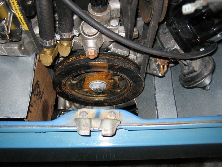

More tin
I have a piece that goes in front of the pulley and connects to the two sides. The cardboard section will be replaced with metal, of course. The tin needs to be finished with the engine out so I can do the fine tuning.

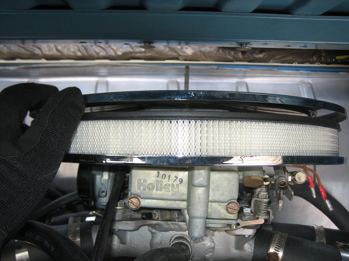

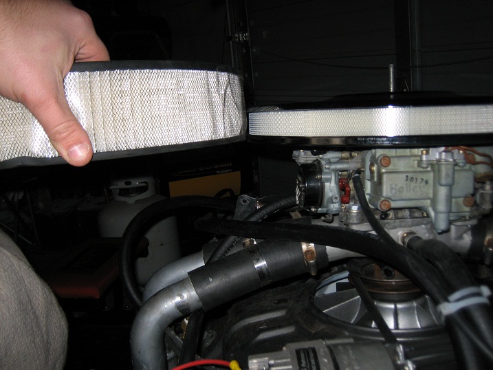

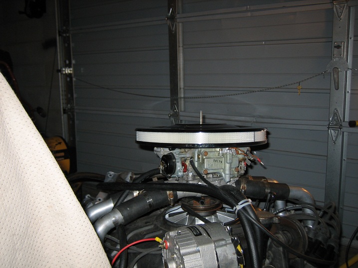

Now, the air filter was too damn big so I found one that was only 1.5" tall.
BUT, it was too short. The top cover was hitting the carb top. (IMG:style_emoticons/default/dry.gif)
Sooooo, I went to the flaps and sourced a different assembly. Notice how much of the all thread is now sticking out (IMG:style_emoticons/default/smile.gif)

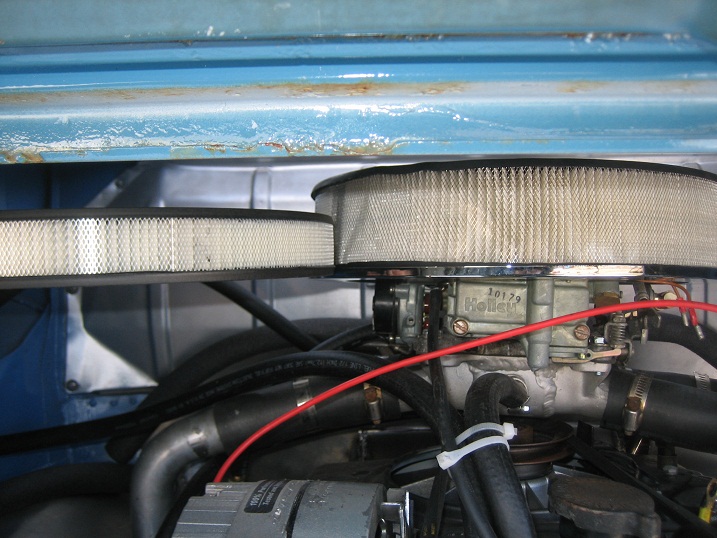

Dr Evil
post Feb 4 2010, 11:34 PM
Post #678
Send me your transmission!
Posts: 23,041
Joined: 21-November 03
From: Loveland, OH 45140
Member No.: 1,372
Final air cleaner. I have another filter that came with the new housing that is only .25 taller if I need it. For a /6, I dont think so, though.
