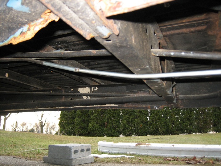

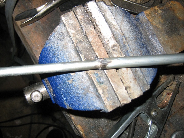

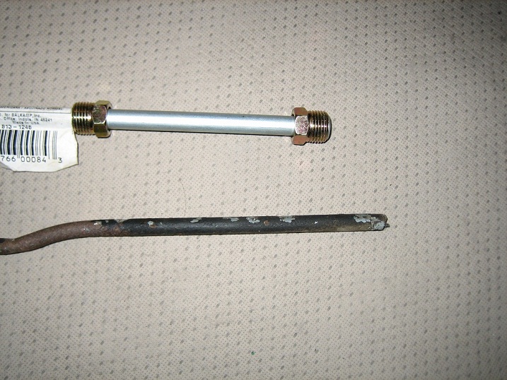

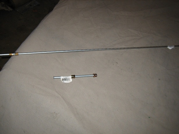

I cut the tube for the throttle cable, got an 8" section of 3/8" brake line and a section of 5/16" to make a new tube section. Attached Image
Here is a section of the old tube next to the 3/8" tube.
The 3/8" had an ID that was a bit too small for the OD of the 5/16" so I had to grind down the 5/16' a bit. Since I didnt want to do a long section of the 5/16 on the grinder I decided to tack it into place.

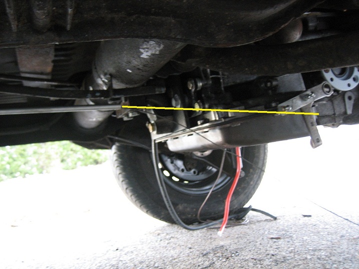

The tube was moved under the cross beam so that it had a more direct shot to the throttle linkage on the tranz. It needs to be finalized before I tack it into place.

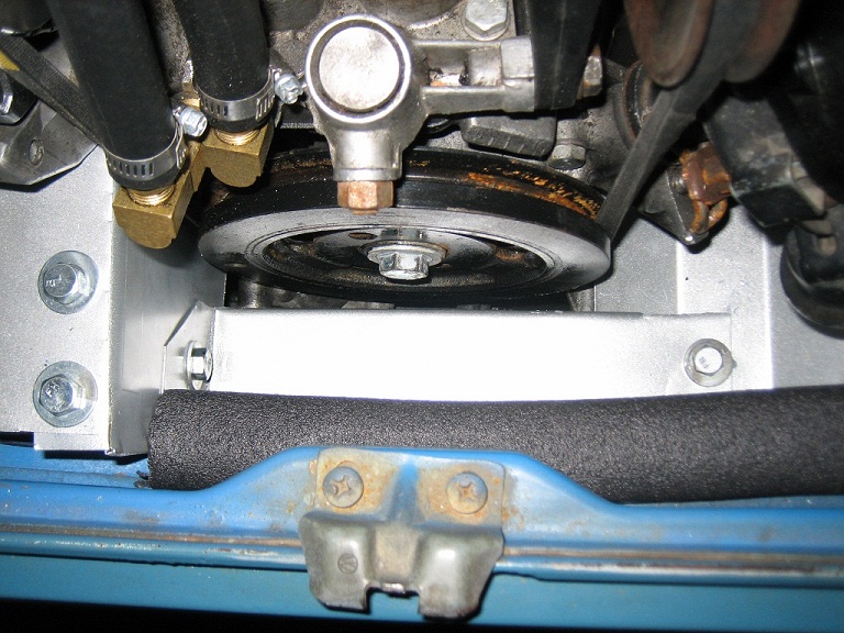

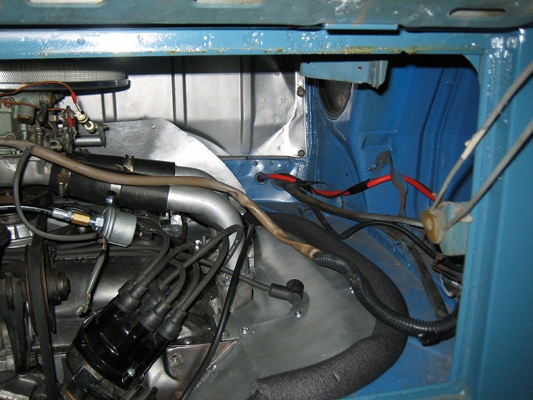

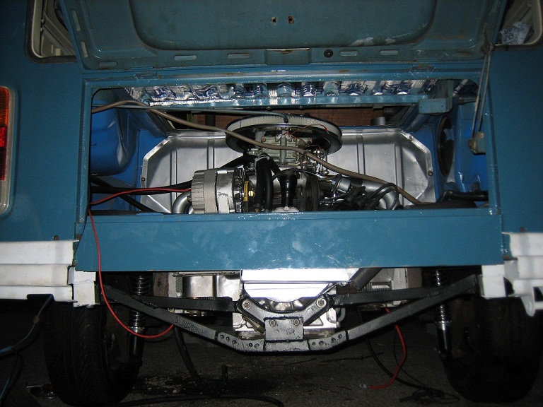

And now for the money shots! I put the tin in and none of it fit right. I had to trim everything. Weird. But, it still ended up working (IMG:style_emoticons/default/smile.gif)

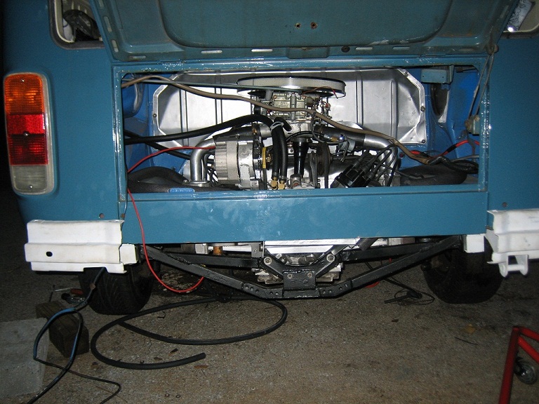

S'more

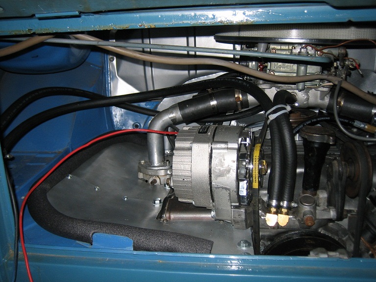

Last one showing the new clearance with the new filter and holder.

The engine looks much lower in the pics than in real life. For those that slam these buses, this thing is a monster truck.

I also need to figure out how I am going to couple my throttle cable to the bell crank on the tranz. That will dictate where my tube for the cable ends up.
