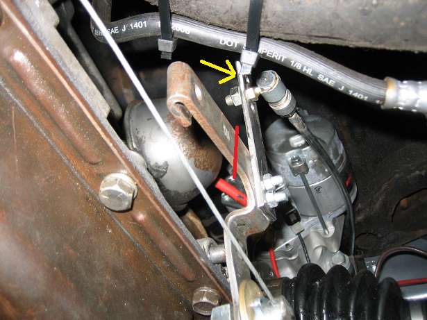

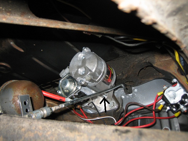

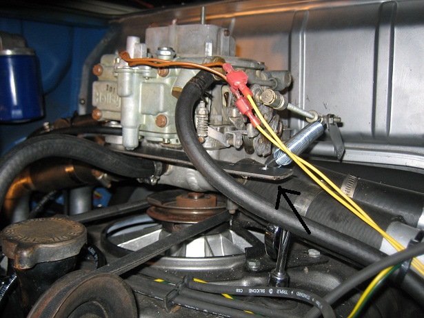

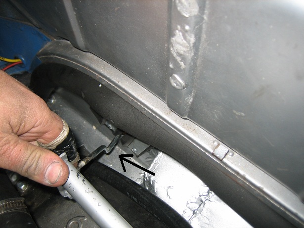

The thing I though would take the longest time, the throttle linkage, did. But, I came out victorious! (IMG:style_emoticons/default/smile.gif)
I bought a longer, thicker rod since I knew the new set up would require some bends that needed to be rigid. Not a big deal, just a Z bend, but it did have to be precise. It took a few attempts with lighter gauge rods.
Here is the return spring and plate I made for it. It works very well (IMG:style_emoticons/default/smile.gif)
Here is a view of the Z bend.
Throttle linkage going through tin.

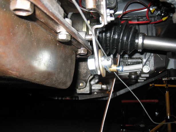

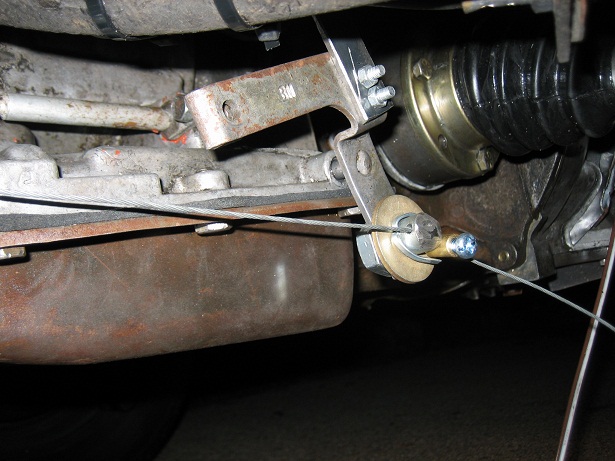

And now for the little part I am most pleased with. The throttle connection on the tranz was a 5/8 hole. So, I bought a 5/8 bolt with a good size unthreaded portion. I cut the threads off, flattened one side to make it easy to drill, drilled a hole for a cotter pin and one for the cable, put a washer on it, and installed it. It friggen worked as I imagined! I like fabricating things.....when they work (IMG:style_emoticons/default/wink.gif)
Attached ImageAttached Image
I had to make a new arm for the pivot on the tranz. This time I made it longer and with extra holes for adjustment. I did the drawing, caveman-trigonometry, and measurements and found the previous iteration to be 1cm too short. I could not get full throttle until I made the new arm. I will be cutting off the extra limb, and tacking the small fasteners on Sun, most likely.
