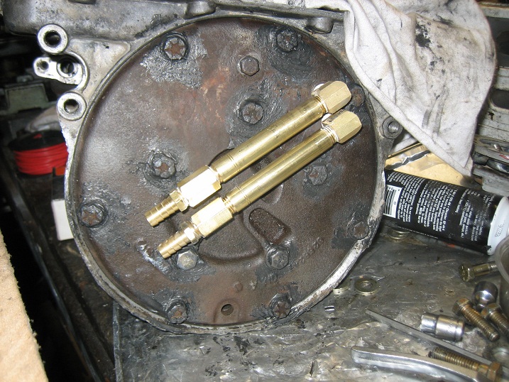

Since my last post I have conceded to install AN fittings in the oil system and to mount the cooler under the bus up front. The 250 max oil temps may be "normal" for the corvair engine, but if I can make it cooler and protect the engine then I think it is a good idea. No rubber push on line could handle the 250* oil so the braided line with AN was a natural conclusion. I still need to install this and look forward to doing this tonight. I have installed a transmission cooler (I am planing on towing stuff with the bus to my new home). I wont be able to post pics for a while, too busy.
The bus can not run until I get a modified part from Root that will allow me to put the AN fittings into the block for send and return.

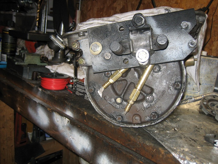

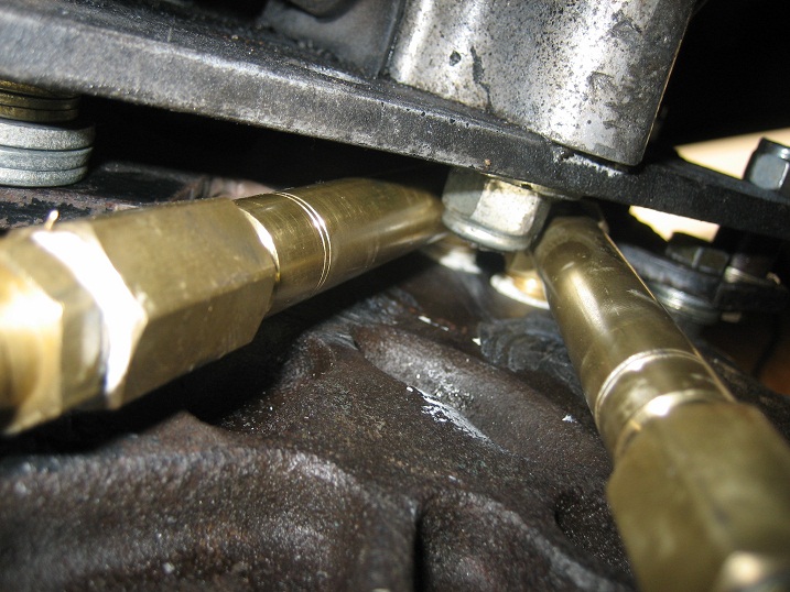

Here are some pics of what I managed to get done on the bus since last time.

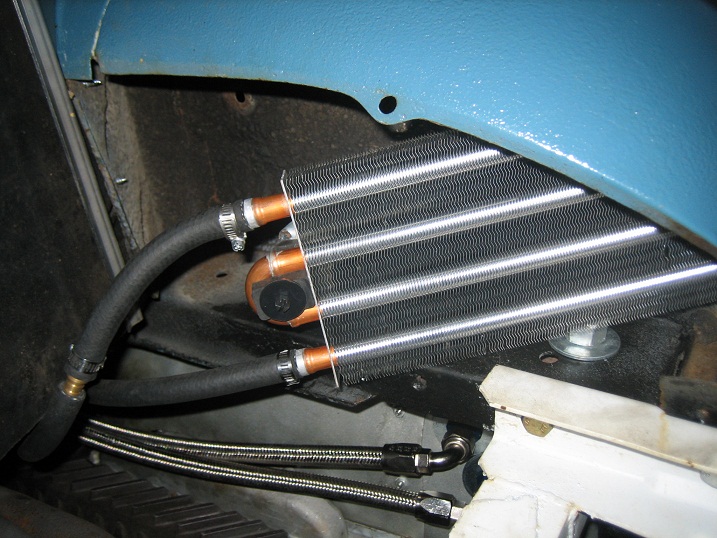

I am intending to tow things with the bus so I installed a transmission oil cooler. Not too hard to do.
90* NPT elbows to some nipples
Clearanced the mount

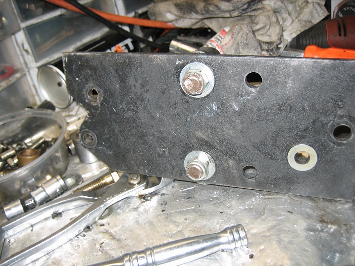

Dr Evil
post Jun 18 2010, 12:06 AM
Post #957
Send me your transmission!
Posts: 23,041
Joined: 21-November 03
From: Loveland, OH 45140
Member No.: 1,372
Of course the second part of the mount had to mess up what I had going on. The nut from the mount is right where the nipples were.

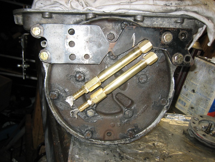

Dr Evil
post Jun 18 2010, 12:08 AM
Post #958
Posts: 23,041
Member No.: 1,372
Spread them to fit

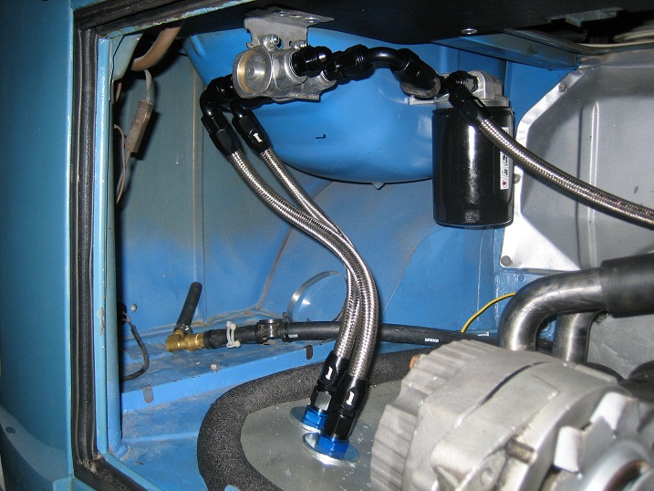

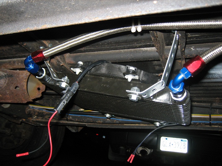

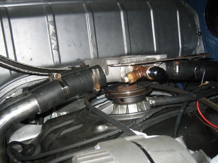

Tonight I did the oil cooler install which I can not finish due to awaiting the last major part from the USPS that Root modified for me (IMG:style_emoticons/default/smile.gif) Here is the AN madness I did.

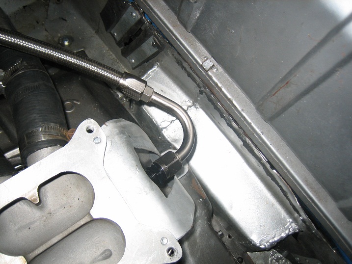

Dr Evil
post Jun 18 2010, 12:09 AM
Post #959
Posts: 23,041
Member No.: 1,372
More

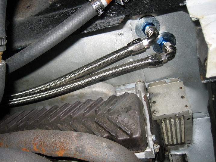

Dr Evil
post Jun 18 2010, 12:11 AM
Post #960
Posts: 23,041
Member No.: 1,372
Quick shot of the tranny cooler in the left rear pocket.
