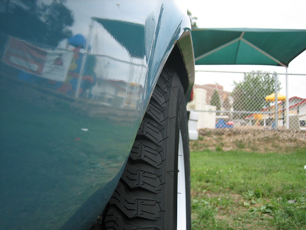

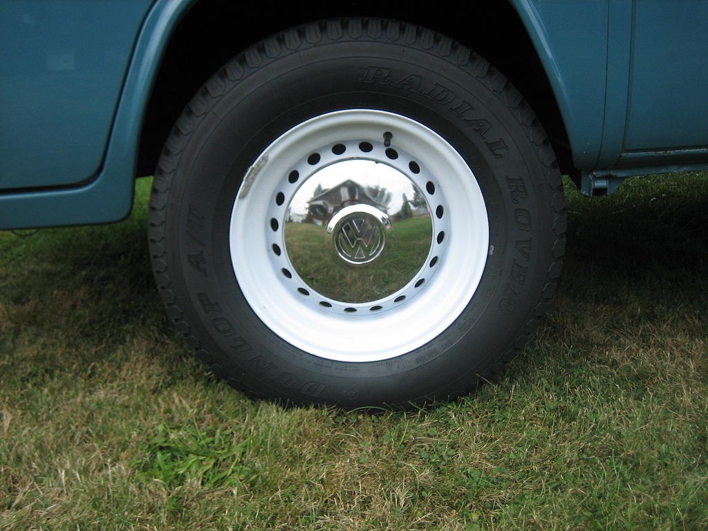

post Jul 31 2010, 08:17 PM
Post #978
Send me your transmission!
Posts: 23,041
Joined: 21-November 03
From: Loveland, OH 45140
Member No.: 1,372
No video yet, but here are the wheels and tires (IMG:style_emoticons/default/smile.gif) I will need to take a few more to show the difference.
Dr Evil
post Jul 31 2010, 08:18 PM
Post #979
Posts: 23,041
Member No.: 1,372
More
Dr Evil

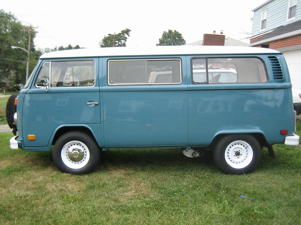

post Jul 31 2010, 08:19 PM
Post #980
Posts: 23,041
Member No.: 1,372
The rear.
