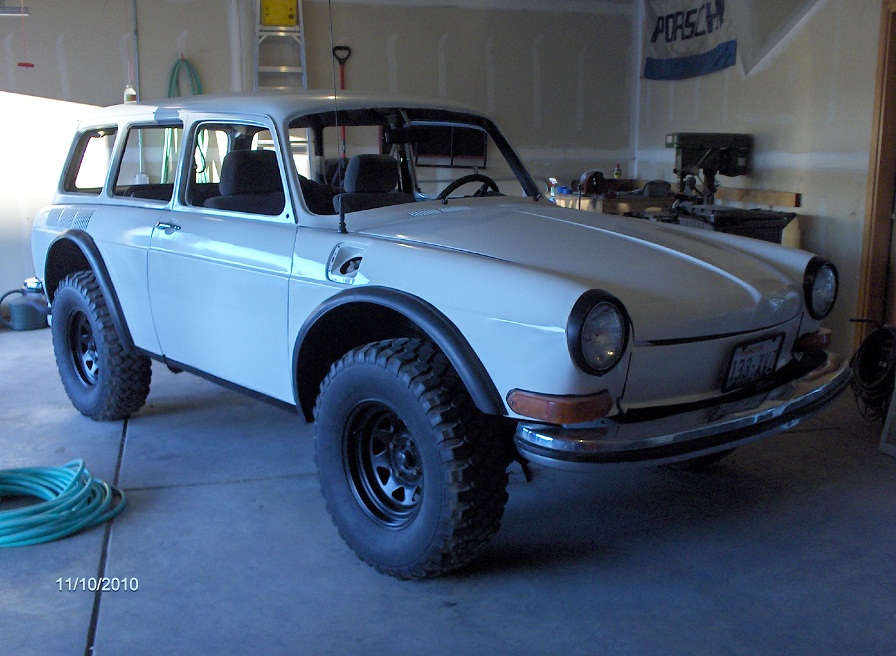

914's are always my first love, but love to see builds on other related VW-based platforms.
I'm almost done with my T3: ( I know I gotta finish adjusting the hood)
