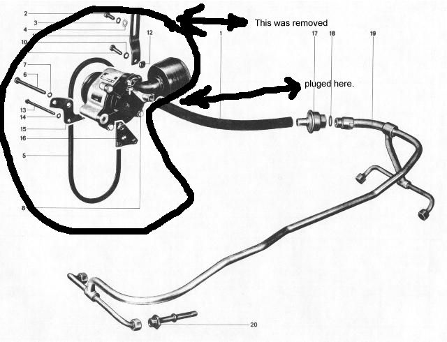

The pump was removed from my car and pluged as u see in the pic,is this okay or should all of the egr system be removed. Attached Image

If you don't have to worry about smog equipment then you can remove the rest of the injection tubing but it is not necessary. It is easiest to take the injection manifold (no 19 in your pic) off and put caps on the injectors (no 20 in your pic). You won't gain any performance but it gets some of the clutter out of the engine compartment. EGR is a separate system.

Thx Vacca Rabite for the info,mabey in the future i will replace the exahaust,for now i have it pluged it where the arrow is pointed ,just wanted to make sure the car would run okay like this.I did remove the pump but left all of the plumbing.

instead of leaving those injectors (#20) installed, can you unscrew them and plug it at the head? how would you do this?

There is nothing good about the smog pump. Just be sure you seal the head well. A common trick is a ball bearing in the cap of a fitting that screws into the the air-injection port.
