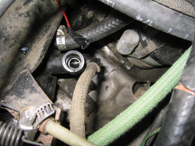

The lower hole on dizzy (Vac advance?) was empty. I now have it going to the vac hole on the throttle body nearest the rear trunk. The diagrams I have show a second one on the throttle body but my throttle body does not have it. However, the diagrams show that nonexistant line going to the other hole on the dizzy/vac advance.
But that line on the vac advance is going to a t splitter that goes to the decel valve and to the thing that attaches for the oil breather line. How should this one go? Please see the pics.
The vac line on the throttle body that was plugged in was going to the fuel pressue regulator. What is that hole on the regulator suppose to go to?

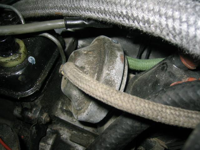

Here is the dizzy/vac advance

If you don't have a second fitting on the throttle body, do not hook the advance fitting on the distributor (the green hose in your second picture) to anything. The "other thing" in the diagrams is the EGR valve and you can ignore the stuff associated with it because a 74 ain't got one.
The fitting on the FPR should get connected to the manifold--pretty much to anything that is "downstream" of the throttle valve.

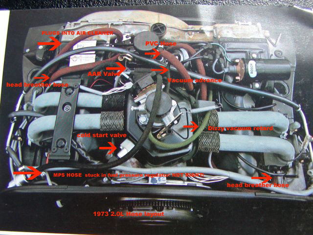

On the distributor vacuum canister, there are 2 ports. One is for vacuum advance and one is for vacuum retard. The vacuum retard is the one that points toward the distributor and should be connected to the port on the rear side of the throttle body.
The vacuum advance port is the one that points away from the distributor. Since you have a 1974 2.0 the vacuum advance is not used and there is no place on the throttle body to connect it as you discovered. That line should remain disconnected (leave a hose attached to the vacuum canister to keep out dirt, but leave the other end disconnected).
The 'T' that you show a picture of is really more of an 'F' coming from the intake plenum. One hose should go to the oil filler, and the other (small) hose should go to the small port on the deceleration valve.
As for the fuel pressure regulator, there should only be 2 hoses going to it - both of them fuel lines. The intake side of the regulator should be attached to the fuel rail on the drivers side of the engine. The outlet side of the regulator should connect to a hose that runs behind the engine over to the passenger side and then down through the sheetmetal where it connects with the return line from the fuel pump and goes back to the fuel tank.

Oops. Dave must have replied while I was typing my reply. But I think Dave has the vacuum retard/advance mixed up. If I remember correctly, the green hose in your picture the vacuum retard and should be connected to the throttle body. The other side is the vacuum advance and should not be connected to anything.

Yer right, Demick--got it swapped. The green in that pic is the retard, and should be hooked up. The grey one is the advance, and should not be hooked up.

here is a pic of the vacuum hose layout
