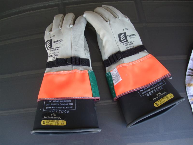

I ran off and left my high-voltage gloves at the office (i know I'm a wuss)... (IMG:style_emoticons/default/biggrin.gif)

Prolly next to yer "Man Card".... (IMG:style_emoticons/default/piratenanner.gif)

"high-voltage gloves " (IMG:style_emoticons/default/av-943.gif) (IMG:style_emoticons/default/av-943.gif) (IMG:style_emoticons/default/av-943.gif)
i don't care you ya are thats funny!!!! (IMG:style_emoticons/default/av-943.gif) (IMG:style_emoticons/default/av-943.gif) (IMG:style_emoticons/default/av-943.gif)

QUOTE(messix @ May 14 2008, 09:21 PM) *
You thought I was kidding? (IMG:style_emoticons/default/huh.gif)
