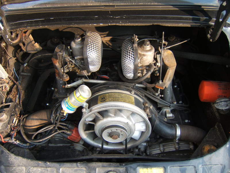

Allan
Okay, here's the problem carb. The arrow indicated the idle jet for the #2 cylinder.
I didn't see any place to access the circuit. Any ideas?
sixnotfour
take the jet out and spray in the hole.
Also the big flat head screw head below is a plug, The transition ports. Spray in there too.
Did you pull the spark plug out and check it ?
Allan
Yep, pulled the plug and even replaced it.
Should I go ahead and do this to all three?
sixnotfour
If it aint broke dont fix , I think is best here.
try get the one you know is bad working first.
Allan
I pulled the idle jet and the plug you mentioned.
I noticed that after a squirt or 2 into the idle jet port, carb cleaner shot out of the hole on top.
Pic.

So.Cal.914
I believe it should, I think that is where is sucks air from. Little different than my 40 idf's.
Allan
Success!!!
I guess I must of had something blocking the idle circuit. It took awhile, but after 5 or 6 attempts at dislodging whatever it was with a can of carb cleaner, the #2 cylinder is firing again.
Took it out yesterday to Buttonwillow and she seemed to run very nice.
Still got a small issue with an intermittent back fire out of the exhaust but nothing I'm going to worry about right now.
