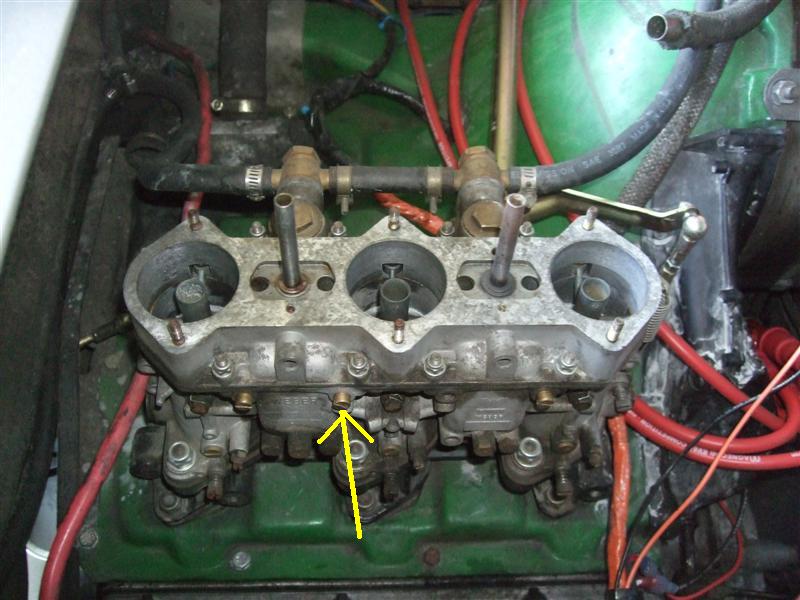

Okay, here's the problem carb. The arrow indicated the idle jet for the #2 cylinder.
I didn't see any place to access the circuit. Any ideas?

take the jet out and spray in the hole.
Also the big flat head screw head below is a plug, The transition ports. Spray in there too.
Did you pull the spark plug out and check it ?

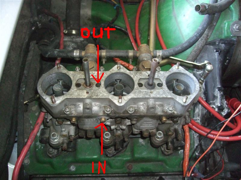

I pulled the idle jet and the plug you mentioned.
I noticed that after a squirt or 2 into the idle jet port, carb cleaner shot out of the hole on top.
Pic.

I believe it should, I think that is where is sucks air from. Little different than my 40 idf's.

Success!!!
I guess I must of had something blocking the idle circuit. It took awhile, but after 5 or 6 attempts at dislodging whatever it was with a can of carb cleaner, the #2 cylinder is firing again.
