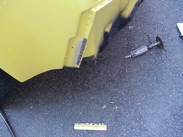

I have a big-bumpered 75. I have never done this, but my understanding is that it is not too difficult.
Two things need to be done:
1. Remove the bumper shocks (couple of bolts)
2. Shave the bumper lip retainers. These are tabs that hold the side of the late-style bumpers to the car.
See the pic below...

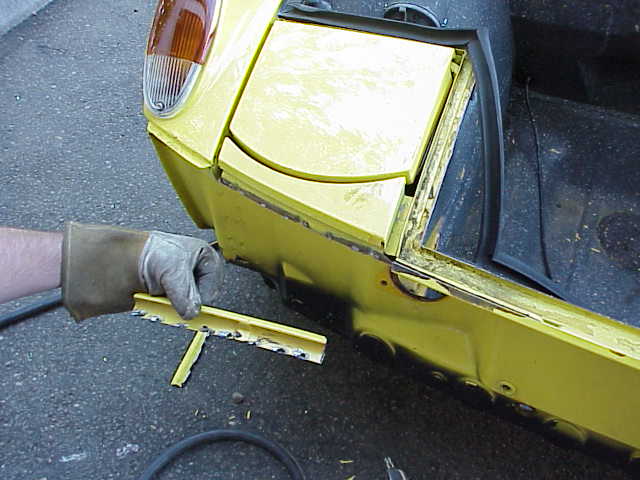

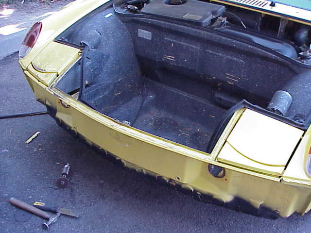

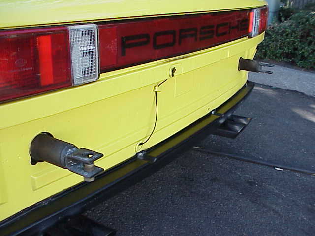

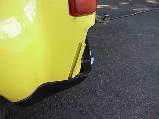

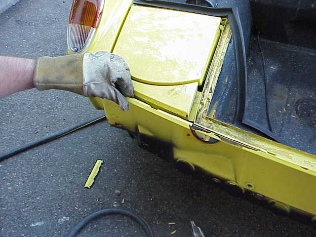

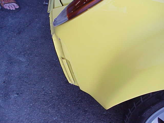

Neal I have pics of the last retro fit I did to JLO. Email me off line I will attach the pics if you want. I have done four other cars. No pics form them.

Why not post the pics here? I'd like to see them also. (IMG:style_emoticons/default/welder.gif)

Okay I will post pics here later this afternoon I am heading out for CAMP 914 and a parts run for Mike.

Pic 1
boxstr
post Jan 21 2004, 07:31 PM
Posts: 7,522
Joined: 25-December 02
From: OREGON
Member No.: 12
Pic 2
boxstr
post Jan 21 2004, 07:32 PM
Posts: 7,522
From: OREGON
Member No.: 12
Pic 3
boxstr
Posts: 7,522
From: OREGON
Member No.: 12
Pic 4
boxstr
post Jan 21 2004, 07:33 PM
Posts: 7,522
From: OREGON
Member No.: 12
Pic 5
boxstr
post Jan 21 2004, 07:35 PM
Posts: 7,522
From: OREGON
Member No.: 12
Pic 6
boxstr
post Jan 21 2004, 07:36 PM
Posts: 7,522
From: OREGON
Member No.: 12
Pic 7
