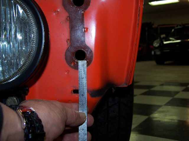

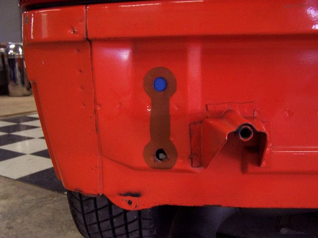

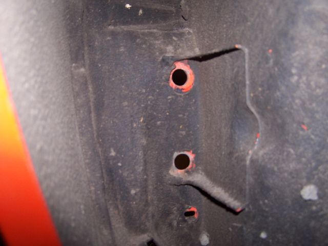

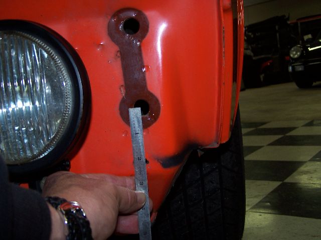

boxstr   Neal I have pics of the last retro fit I did to JL...   Jan 21 2004, 02:44 PM
RustyWa   Why not post the pics here? I'd like to see t...   Jan 21 2004, 02:47 PM
boxstr   Okay I will post pics here later this afternoon I ...   Jan 21 2004, 03:08 PM

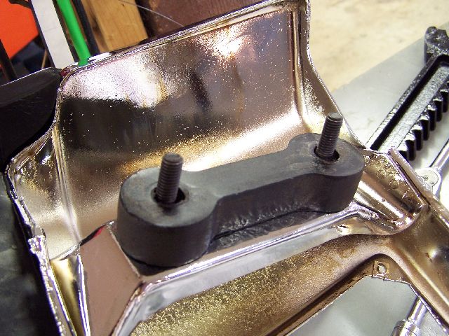

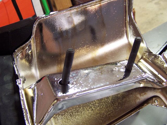

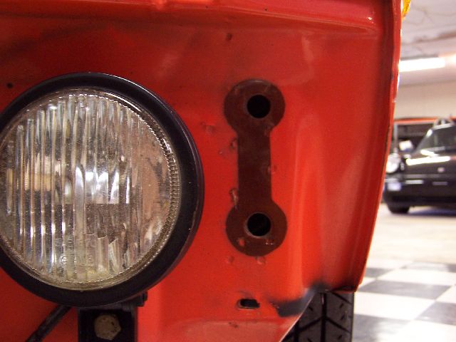

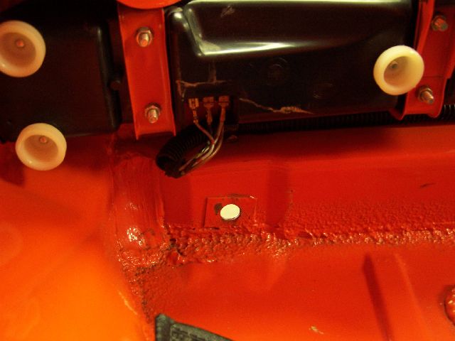

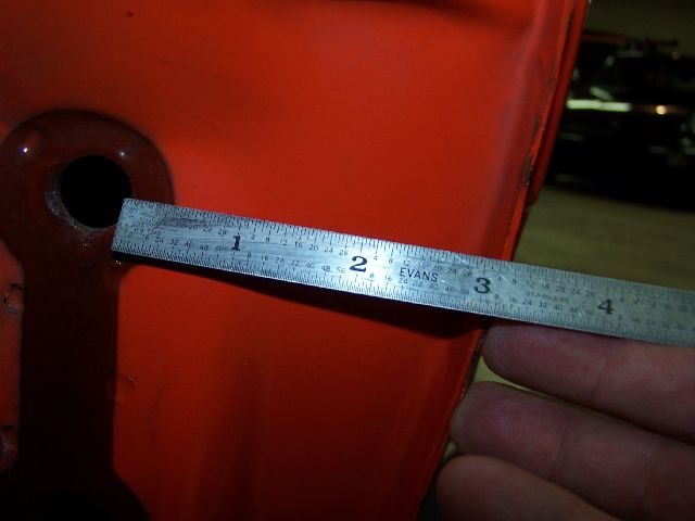

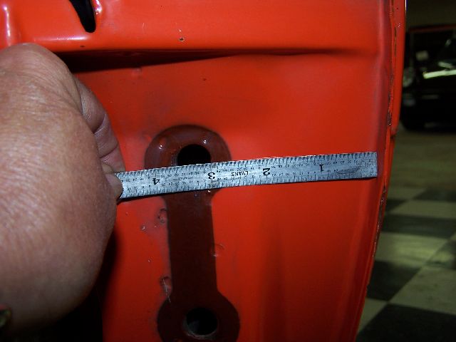

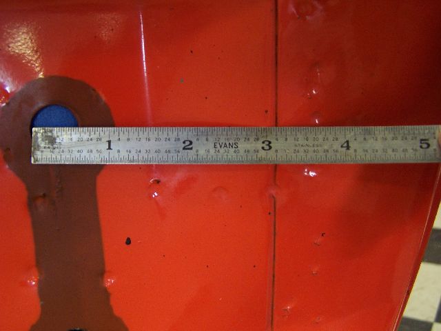

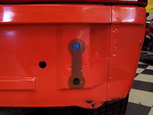

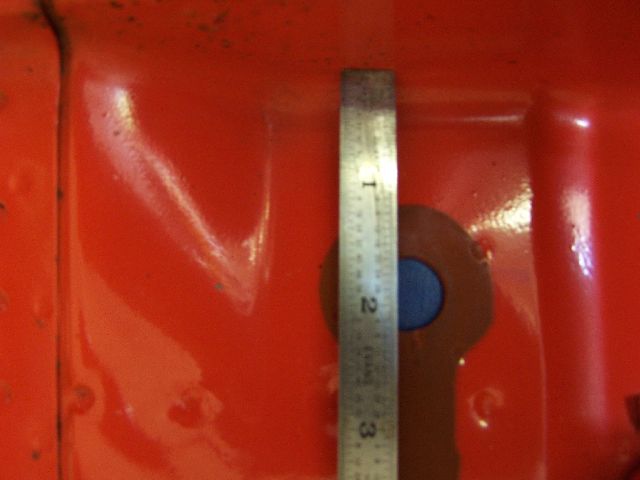

boxstr   Pic 1   Jan 21 2004, 07:30 PM
boxstr   Pic 2   Jan 21 2004, 07:31 PM
boxstr   Pic 3   Jan 21 2004, 07:32 PM
boxstr   Pic 4   Jan 21 2004, 07:32 PM
boxstr   Pic 5   Jan 21 2004, 07:33 PM
boxstr   Pic 6   Jan 21 2004, 07:35 PM
boxstr   Pic 7   Jan 21 2004, 07:36 PM
boxstr   Pic 8   Jan 21 2004, 07:36 PM
boxstr   Pic 9   Jan 21 2004, 07:37 PM
boxstr   Pic 10   Jan 21 2004, 07:38 PM
boxstr   Pic 11   Jan 21 2004, 07:38 PM
boxstr   Pic 12   Jan 21 2004, 07:39 PM
boxstr   Pic 13   Jan 21 2004, 07:40 PM
boxstr   Pic 14   Jan 21 2004, 07:41 PM
redshift     Jan 21 2004, 07:47 PM
boxstr   Sorry a couple of pics were out of sequence. One t...   Jan 21 2004, 07:55 PM
Bleyseng   Yep, its pretty easy to do as Craig showed. Fabing...   Jan 21 2004, 08:07 PM
RustyWa   Very nice photos. If you are going with the round...   Jan 22 2004, 12:18 AM
boxstr   Round fogs, ahh another problem. I have found a st...   Jan 22 2004, 12:37 AM

maf914   Craig and Geoff, Thanks for the great photos and ...   Jan 22 2004, 08:35 AM
boxstr   Good morning guys, The front bumpers have no real ...   Jan 22 2004, 08:42 AM
kafermeister   Thanks for posting the photos. I don't have a...   Jan 22 2004, 08:54 AM
maf914   Now I see. Thanks Craig and Kafermeister. Mike   Jan 22 2004, 09:34 AM

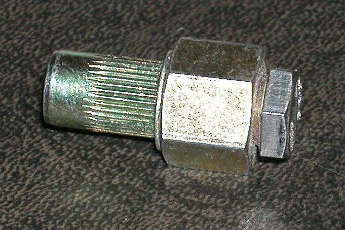

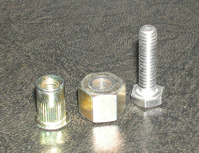

Bleyseng   For the early fogs I used a blind nut which is the...   Jan 22 2004, 09:46 AM
boxstr   Here is a pic of the "tee nuts" that I use for the...   Jan 22 2004, 05:59 PM

Bleyseng   Ok, I'll dig them out of the assortment box (p...   Jan 22 2004, 09:35 PM
maf914     Jan 23 2004, 08:03 AM
Bleyseng   heres the pieces put together   Jan 23 2004, 08:29 PM
Bleyseng   here is the 3 pieces   Jan 23 2004, 08:30 PM
Gint   Thanks Geoff. I've never seen those before.   Jan 23 2004, 10:34 PM
Neal   Geoff, were do we buy them ? Neal   Jan 24 2004, 12:28 AM
Bleyseng   I found them at Hardwicks in Seattle but I am sure...   Jan 24 2004, 12:29 AM
Neal   Now that I have the hardware what is the best wat ...   Jan 26 2004, 09:45 AM
boxstr   Do you have the dogbones?? Those will give you the...   Jan 26 2004, 09:53 AM
Neal   Craig, thanks very much for the reply, I do have d...   Jan 26 2004, 10:05 AM
boxstr   Neal I like the stud idea. I would try that next t...   Jan 26 2004, 12:20 PM
