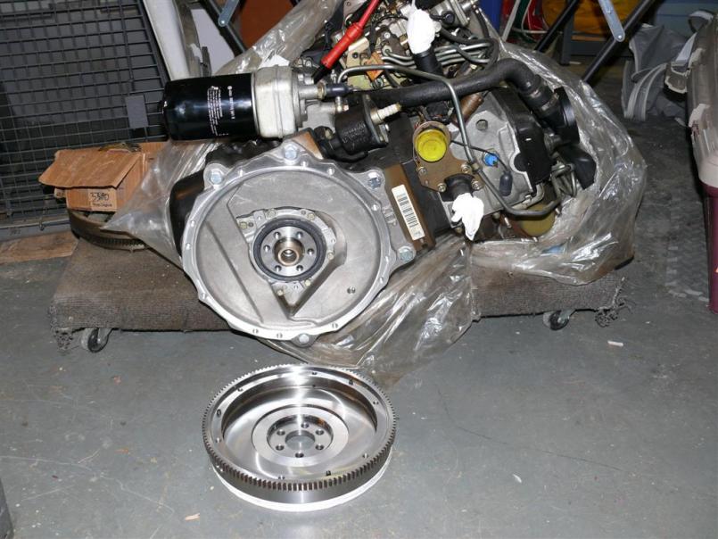

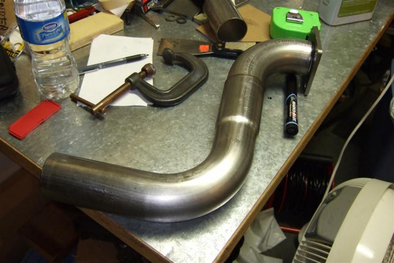

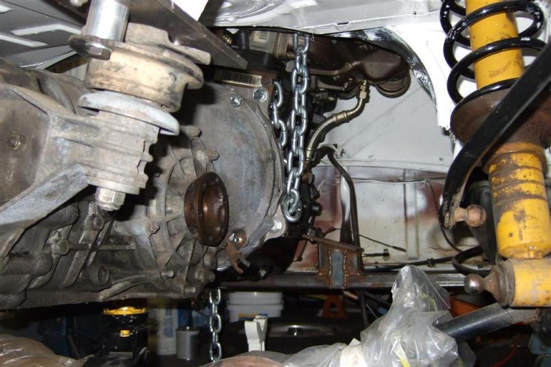

I have the engine in place with a fabricated front mount (thanks Jason) and a Kennedy adapter mounted to the 901 trans. The engine is a AAZ which has the same bolt pattern as an old Rabbit. I milled a exhaust mounting flange using 1/4" plate and have some 2 1/4" stainless exhaust bends to act as a down pipe.

Some pics of the slow progress

kennedy adapter. They modified my flywheel.
