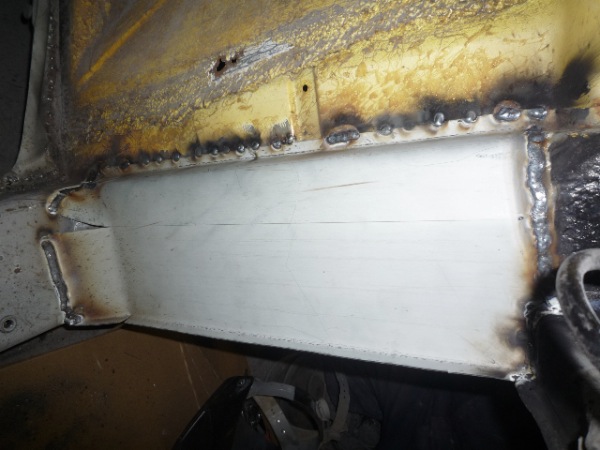

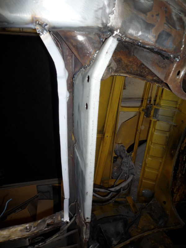

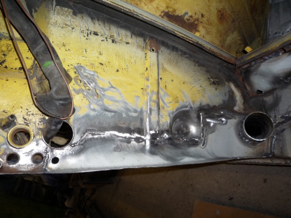

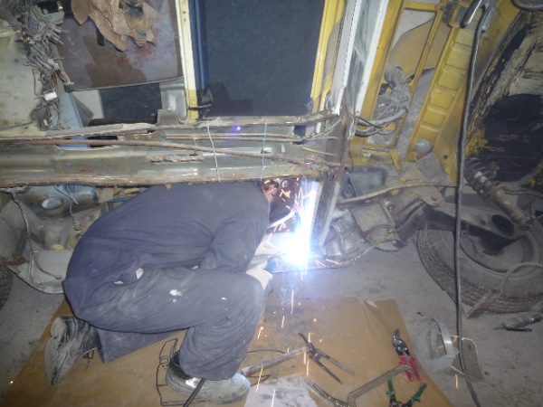

Hopefully work will now restart, which would be good, anyway the rear inner and outer firewalls are being done now. (IMG:style_emoticons/default/welder.gif)

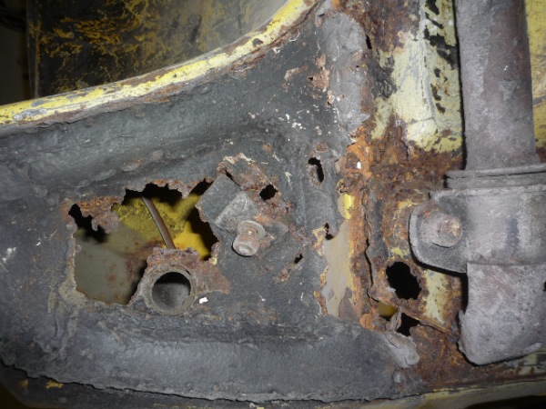

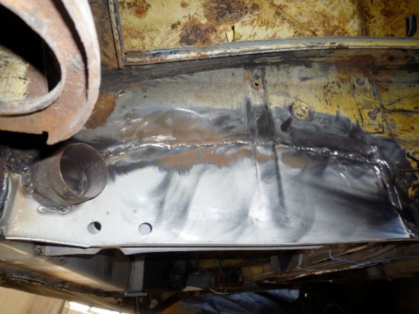

Now the other side, note the rotten front steering rack mount also. Still hoping to have a floor in soon.

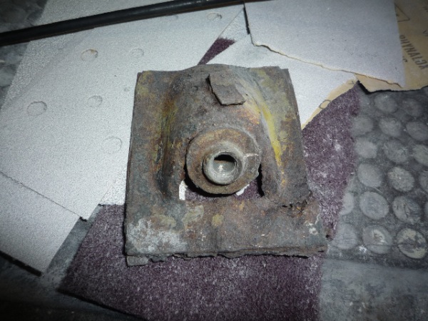

Veltror, how is your front trunk? I was looking at mine and the front control arm pad is just sitting there with some rusted metal around it. If your's is the same could you show how Marek addresses this as well. There doesn't seem to be any threads that shows how this is repaired. Jeff Hail touches on it, but he has something to weld to. Al.
veltror
post Dec 8 2009, 03:55 AM
Post #111
Posts: 930
Joined: 27-April 08
From: Potters Bar Herts UK
Member No.: 8,978
It's not so bad minor hole on one side, not sure when he is going to get round to it but i will let you know.

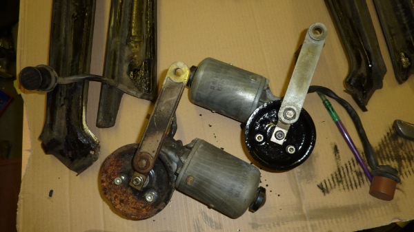

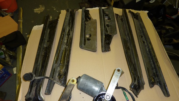

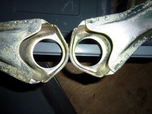

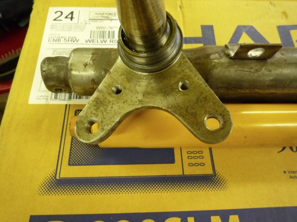

Right, I expect that there will be some more updates soon. In the meantime I have started cleaning and putting together some of the parts I have been collecting over the last year or so. Firstly I got these A arms cheaply which have been cleaned and zinced, I plan to powder coat these, I assume they are all the same? I plan to put in my Koni 911 struts into these. (IMG:style_emoticons/default/confused24.gif)
Secondly I started cleaning my headlight motors and assorted gubbins I noticed that one operating arm is steel the other white plastic which one is correct?
post Mar 31 2010, 02:25 PM
Post #116
Resident German
Posts: 42,562
Joined: 21-January 03
From: Oakland, Kalifornia
Member No.: 179
QUOTE(veltror @ Mar 31 2010, 01:20 PM) *
Steel = Early model car (up to '74)
Plastic = Late model car ('75/'76)
As for the A-Arms, make sure they are not bend. Post a pic of the underside of the hole where the strut will mount ...
(IMG:style_emoticons/default/bye1.gif) Andy

The A arms do not look bent, what do you think Andy

So I am currently redoing the dashboard since it is rusty what a surprise, I thought I would start on the suspension. I have some nice sandblasted Koni struts and got some 8641-1039 inserts like Richard has but Jason at Paragon tells me that they won't fit since there were two types. (IMG:style_emoticons/default/mad.gif) (IMG:style_emoticons/default/mad.gif) (IMG:style_emoticons/default/mad.gif) So it looks like I am going to have to get rid of these to fund some others.
Now I also find that using 914-6 rear discs on my 5-stud conversion requires some lathe work to turn down the discs a few mm (IMG:style_emoticons/default/mad.gif) (IMG:style_emoticons/default/mad.gif) this si getting me mad, one of the ideas of this project is to have as much bolt in stuff as possible so in the future my son will be able to have my car and not have to remember that there are lots of special bits. All we need now is the Labour party to win the election tomorrow and remain in power.... (IMG:style_emoticons/default/mad.gif)
You can see where the insert necks down two low, what struts will these bloody inserts fit ? So I can describe them to somebody who wants them.
