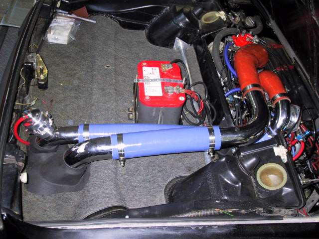

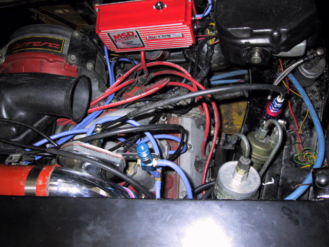

Pressure switch and boost gauge plumbed into the power assist port.

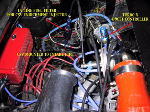

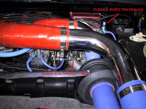

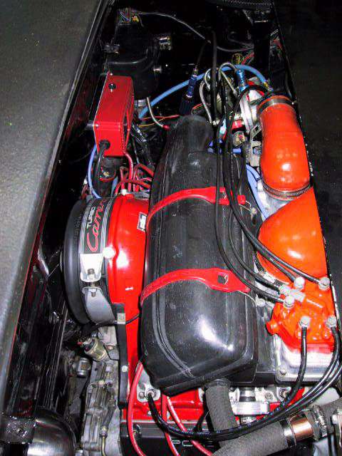

boost controller and CSV

csv

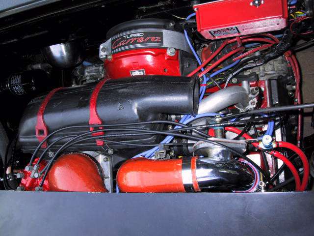

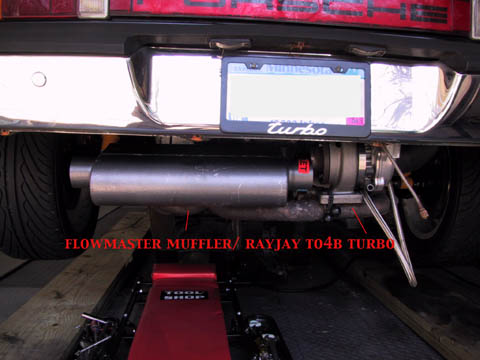

Flowmaster and Rayjay turbo

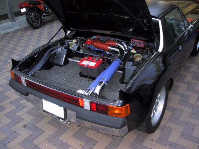

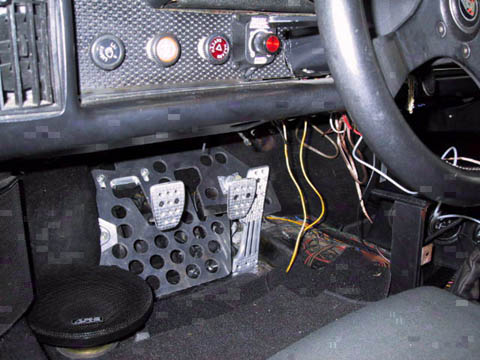

Oh ya, pedal board

I have followed a thread on the bird board for sometime now on tubo installs on 3.0 sc engines using the Bae kit with modifications, As they were figureing it all out, I started my installation. I will be running about 8lbs of boost which should make for an exciting ride. My dream car has always been a 914 6 turbo carrera, and it's looks like I am getting pretty darn close to it. (IMG:style_emoticons/default/givemebeer.gif) almost time to celebrate. I think I will start on a Heineken right now,posting all these pictures was a lot of work. (IMG:style_emoticons/default/beer.gif) (IMG:style_emoticons/default/beerchug.gif) (IMG:style_emoticons/default/givemebeer.gif)
