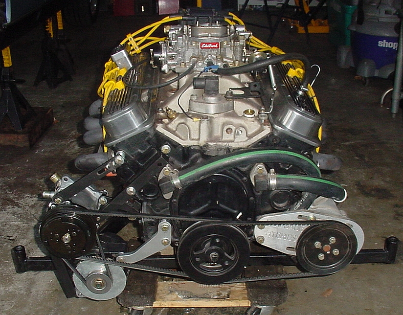

I'm installing a chevy 305 with a renegage kit and I have a few questions.
There seems to be plenty of room to leave the battery tray in the OEM position, why do many move the location to the trunk?

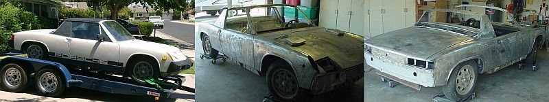

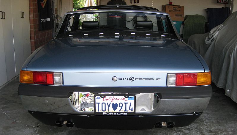

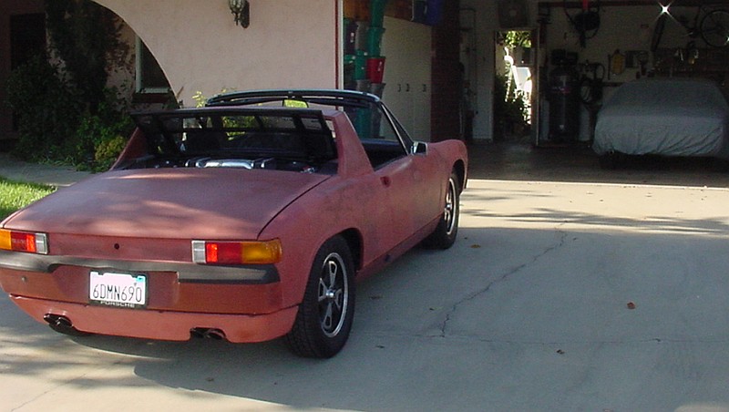

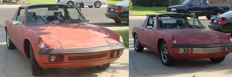

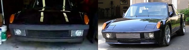

Edited.....thought I would add some before and a after picture since this thread has evolved into a v-8 install/restore/modify thread. The story begins....
computers4kids   Installing a V-8...a few questions   May 28 2008, 10:21 AM

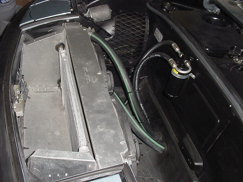

michaelt55   Mark; Heres a photo of my radiator setup... I hav...   May 28 2008, 10:50 AM

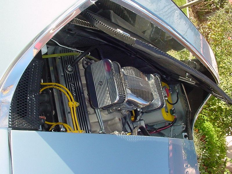

marks914   Here is how I did my front trunk. Why did I move m...   May 28 2008, 12:00 PM

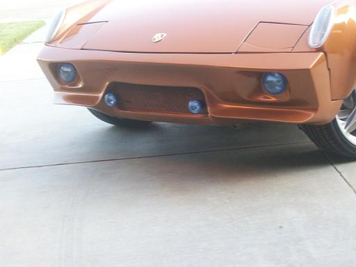

computers4kids   A little more progress today...the focus was bumpe...   Jun 10 2008, 09:26 PM
JRust   Looking good Mark! What color are you planning...   Jun 10 2008, 10:19 PM

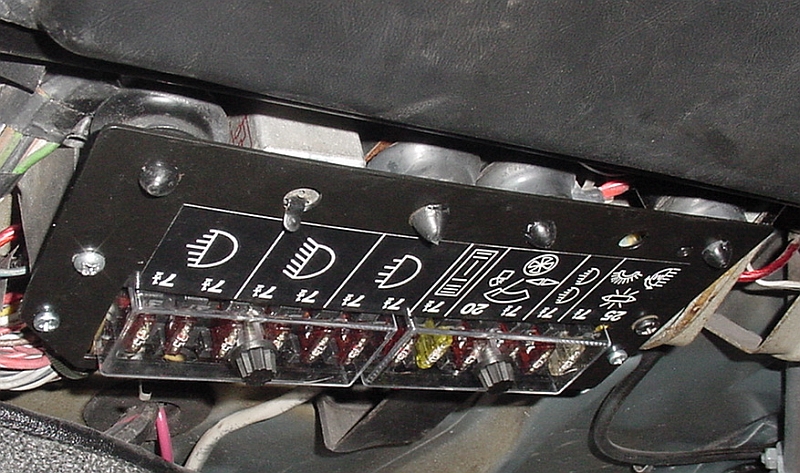

computers4kids   Today I started installing the Renegade wiring har...   Jun 11 2008, 10:23 PM
computers4kids   last question   Jun 11 2008, 10:23 PM

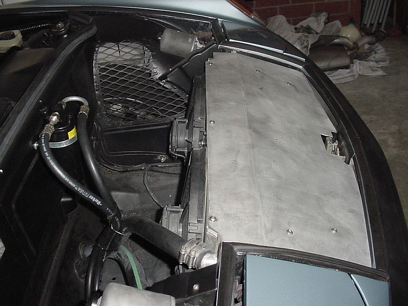

computers4kids   The latest... I removed the support brace from the...   Jun 18 2008, 08:53 AM

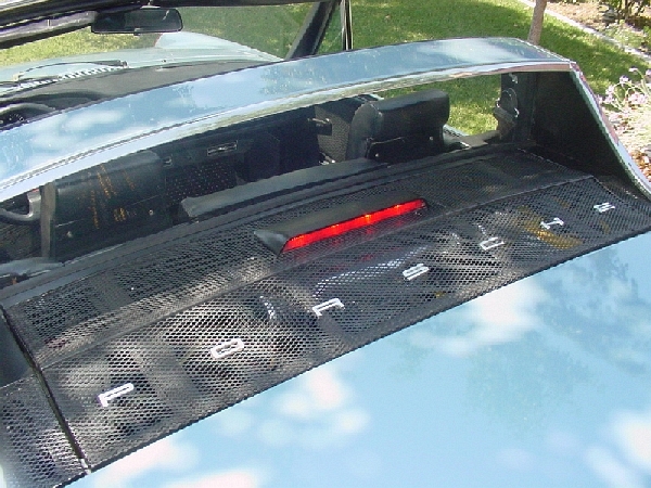

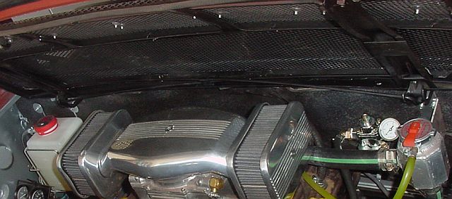

computers4kids   In the engine compartment I added a wide mesh stee...   Jun 18 2008, 08:55 AM

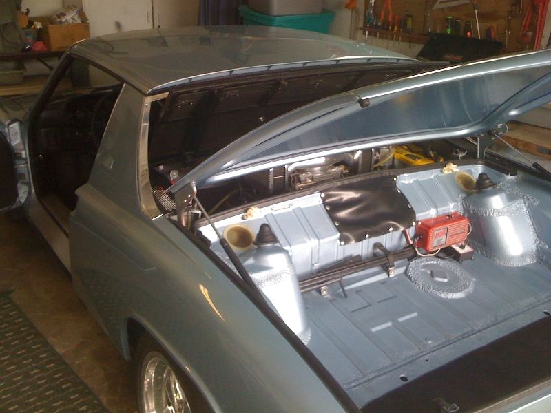

computers4kids   It's official...the 75 is off its rollers. I ...   Jul 21 2008, 09:52 PM

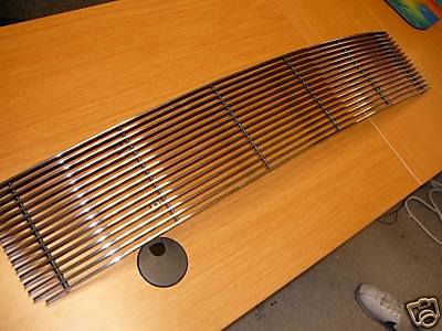

computers4kids   Now I know why GT grills are so expensive...they...   Jul 23 2008, 12:48 AM

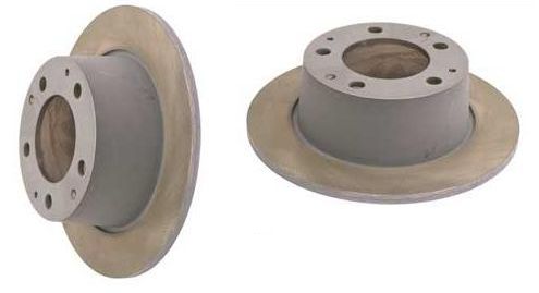

computers4kids   Thanks to Nick, his almost new BMW front calipers ...   Jul 29 2008, 11:34 PM

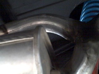

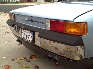

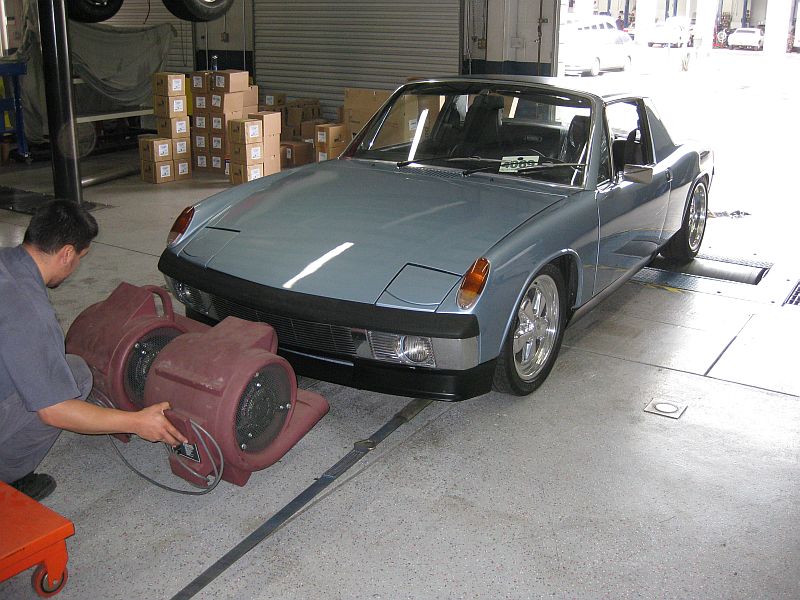

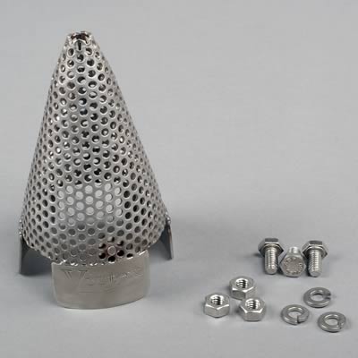

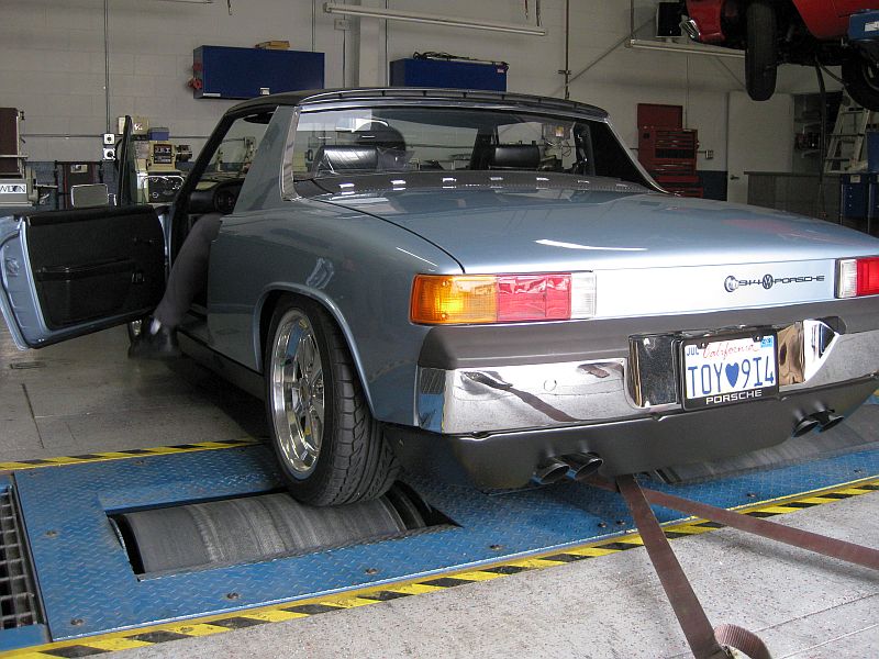

computers4kids   A little more progress... I took...no, "I dro...   Aug 1 2008, 06:12 PM
computers4kids   After the muffler shop, drove it down to this high...   Aug 1 2008, 06:38 PM
JRust   Sounds good Mark! Dual tips fill it perfectly....   Aug 2 2008, 12:30 AM
