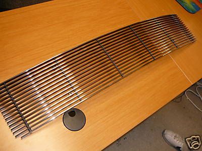

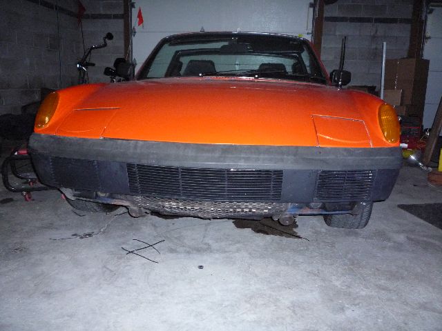

Hi Sean,
The curvature of the 350z grill is pretty darn close to that of our front bumpers. You will need to shorten both ends and remove I as recall a couple of bars on each side of the width. This stuff cuts like butter with a cutting wheel. Just tape where you are going to cut so you don't accidentally mar-up the area next to the cuts. After cutting, use a DA or sander with fine sand paper to smooth the cut....looks perfect. The recesses of my grill bars is black, so I used a small paint brush and dabbed the ends to make it looked finished...can't even tell.
I welded a supports from a piece of an extra engine lid across the center of the bumper on either side. The grill comes with brackets on the backside and they will bolt to those brackets I welded on. I used some fiberglass spacers from the hardware store to space the grill flush.
The ends of the grill bars also flex easily. You will find the ends curve a bit downward for the 350z...just flex them straight to match the 914 horn grill pattern.
My buddy did the same for his v8 914 and went with black grill and black bumper for the stealth look....looks very nice as well if the bling is not your style.
Here is a picture of my painted bumper version still hanging in the garage....if your interested I would sell you that one ready to go (primered)...

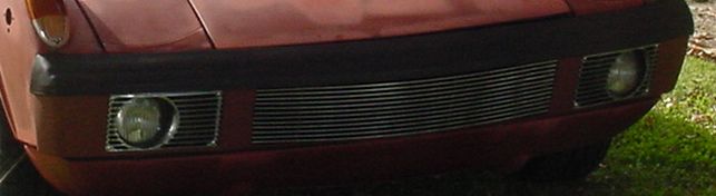

Here is a pic of mine using the 350z grill. I gotta admit mine is held in place at the moment with Zip ties (IMG:style_emoticons/default/dry.gif) . Still even without my valance I think it turned out nice. Really is pretty dead on with the foglight grills for spcing between ribs

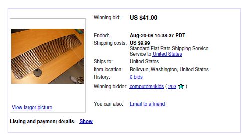

Yours looks to be the 13 bar version. Do you remember where you bought yours from?
Trex grills are high quality grills but can be had very cheap on ebay, or buy them direct from a retailer...several people sell them. Check around first...I found quite a few different prices. I bought mine new on ebay for $41.

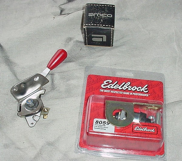

Here's one that I would highly suggest for all 914 v-8 motors. My motor is a bit cold blooded and doesn't like a slow idle for the first 3 minutes until it gets warmed-up. Once warmed-up, it just purrs at 600 rpm. Even with the autochoke and fast idle cam, the motor needs a faster warm-up rpm when it is cold. After some reading, I knew what I needed: An Edelbrock Idle Compensator. Normally these are for kicking-up the idle when the AC is on, I wired it so I can manually kick the idle up until the motor is warm, and then manually kick the idle down when I want. It also will kick in if the AC is turned on. It's quite slick, and works awesome.
The kit is between 100-120 at parts stores. After I bought mine I came across a guy who sold me an extra for considerably less, so if you want one I'll make you a deal!

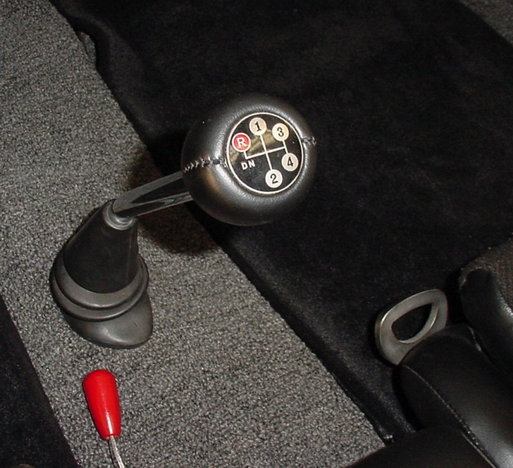

Last but not least, I picked-up a NOS 4 speed leather stitched gear knob for a teener for $15. My tranny is still a 5 speed but I never use 1st anymore, so it's the pattern I use and will ultimately end-up with when I rebuild my transmission and install the h gear I picked-up.
