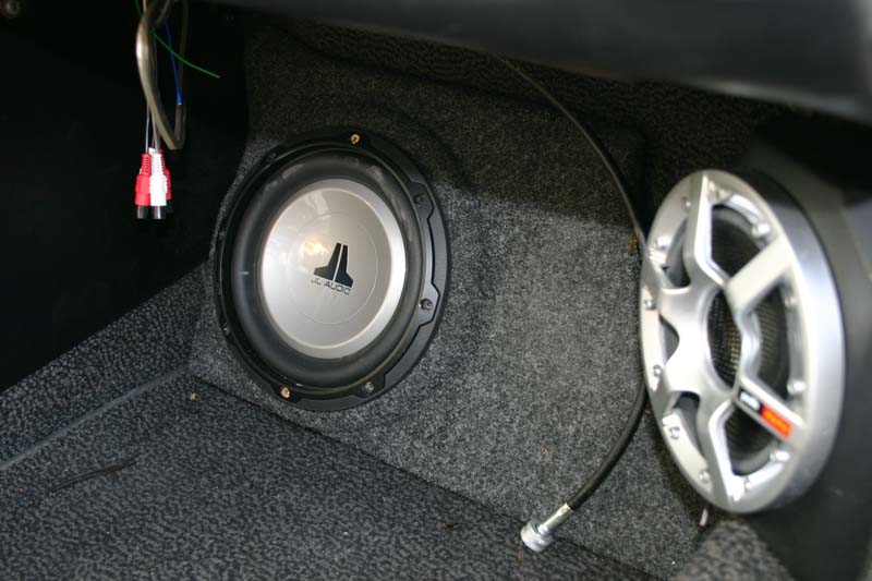

I made my own box about 2 years ago that was almost indentical to the one that is being made here. Check it our here
http://www.914world.com/bbs2/index.php?sho...ic=47247&hl
I measured the volume with a displacement method and it was perfect for a 8in sub. The 10 needed way too much volume. I bought the JL 8in audio speaker and have way more bass than I need (this fit in my box as I designed it to fit, but may not fit in other check the specs before you buy it). The car interior volume is very small also. It is very clear and has the right sound. If you want to just piss off your neighbors or show off for the ladies go with the 10 but it will not do much as the volume of the box is too small to allow the speaker to move in and out properly. In regards to speaker location, trust me it only works on the left side due to the contour of the body. If you get the JL audio speaker you will need to order the grills on their web site, about 8 dollars if I remember (link to buy the grills) http://store.jlaudio.com/home.php?cat=255. They are strong enough to stand on, really you could stand on top of these things and they will hold it. So get a grill and you should not have a problem with putting your feet thru it. I actually have my floor mats covering the speaker as well. Bass is non-directions unlike trebal and does not need to be in your face or even be seen. The sound waves go in all directions and will reach your ear, even if the speaker in hidden. I love the sound and would totally recommend this set up.

What kind of JL Audio sub is that? W1? W3? I went to the JL Audio website and the specs for an 8W3 work with the dimensions Morph posted up above (0.30 ft2 volume and 4.63" mounting depth). I had a pair of 12W3v2's in my last car in a sealed box. Was very impressed with the sound quality and clarity, I'd like to stick with W3's if possible.

The 8W1v2-4 looks like it's a perfect match for the box, though it's not part of the W3 series that you're looking for:
http://www.crutchfield.com/App/Product/Ite...ofer&tp=111
# 8" 4-ohm subwoofer
# metallic-finish polypropylene cone with nitrile-butylene rubber surround
# power range: 35-150 watts RMS
# peak power handling: 300 watts
# frequency response: 28-250 Hz
# sensitivity: 83.86 dB
# top-mount depth: 3-13/16"
# sealed box volume: 0.375 cubic feet

No thanks, I'm sticking with dual voice coils. If I can't get a W3 to work, I'll look at other brands that have an 8" DVC speaker that will. But the more I look at the spec sheet and enclosure requirements on the JL Audio site, the more I'm pretty sure an 8W3 will work. It has the proper mounting depth, volume requirements, etc. The only thing that might not work is if the MDF used isn't thick enough (if the box was designed for a 50watt SVC speaker, there wouldn't be any point in using beefy MDF). That wouldn't be a design problem though, just special order the box with thicker wood. The 8W3v3 only needs 0.30 cubic ft of volume while the 8w1 needs 0.375... weird. The 8w3v3 does need more mounting depth, but still less than the specs Morph posted. Should be good.

That looks nice! The question I have, is do you think it would stand up to a JL Audio 8W3? The volume is right, and the mounting depth is right. I just don't have any experience with 'glass enclosures, and know that MDF will shake apart if you don't use thick enough stuff. If it'll handle the pressure an 8W3 puts off, could I special order one without the speaker at a lower price?
