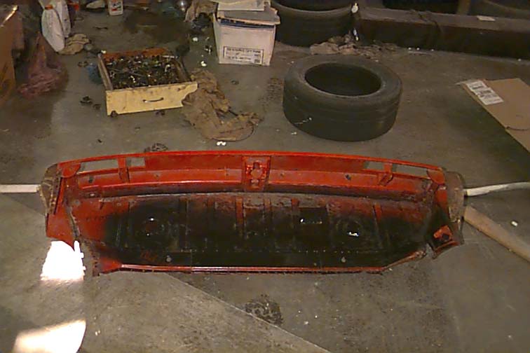

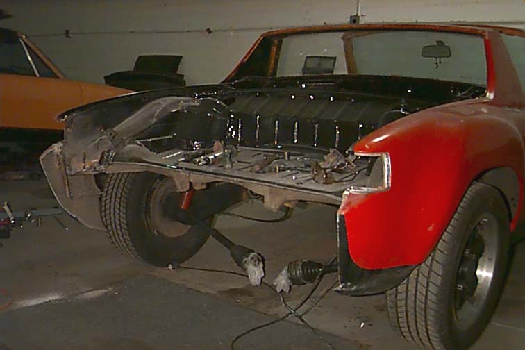

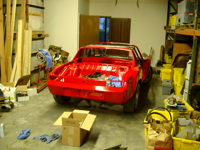

a good bodyshop will be able to pull this out ... you probably need a rear clip from a junk car. i replaced the rear clip on mine, wasn't too bad of a job.
but make SURE the car is pulled back correctly *before* you let them weld up anything. nothing worse than not fixing it right ...
(IMG:style_emoticons/default/shades.gif) Andy

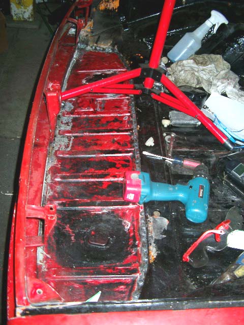

donor rear clip:
my old one removed:
new one welded in:
and painted:

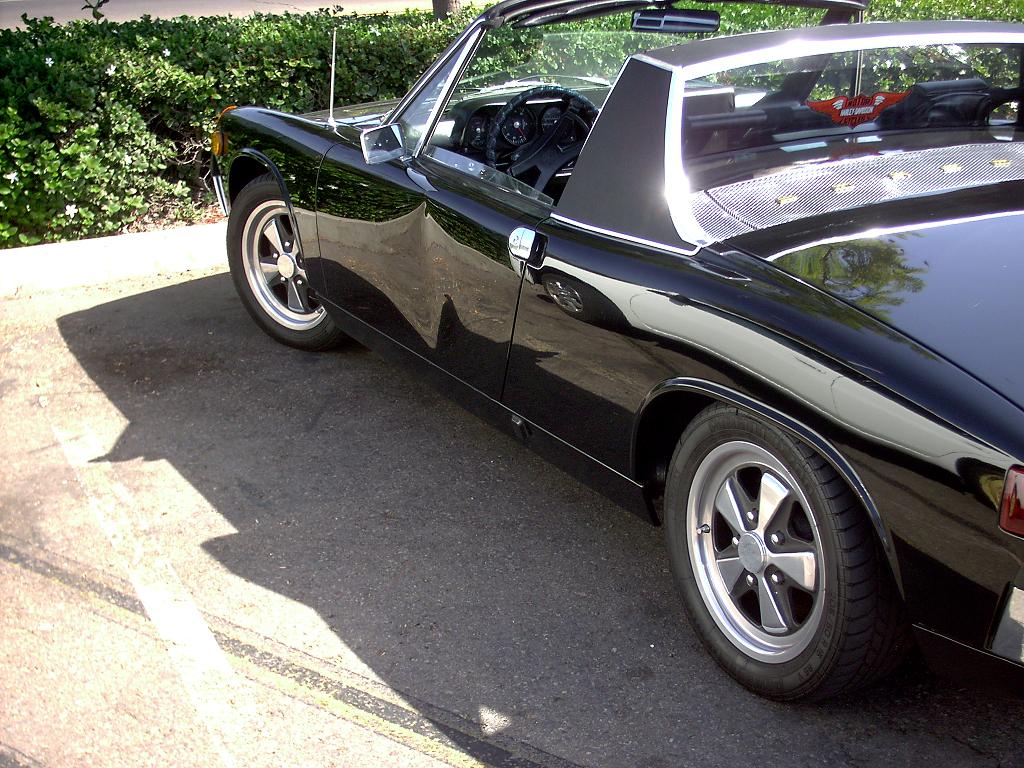

Doesn't even advertise, word of mouth. Excellent work, Concours quality, but you will pay for it. Took my RS America in to get a ding in drivers door fixed. They didn't want to fix ding, wanted to just replace door ($3500 for stripped door)
Took it to West Coast Specialties.
Shop is easy to miss. Take Mission Gorge off ramp from Route 52, lights call for left turn, don't make turn, go straight, takes you into Phil's parking lot.
Check for rear clip at Autobahn parts in El Cajon. Really nice guys, good prices
Autobahn
444 Vernon Way
El Cajon, CA 92020
Pic is off my 6 after the last as*** ran into it while parked. Took it to West Coast, saved door, perfect repair.
Good Luck,
Don
