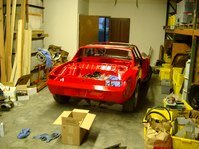

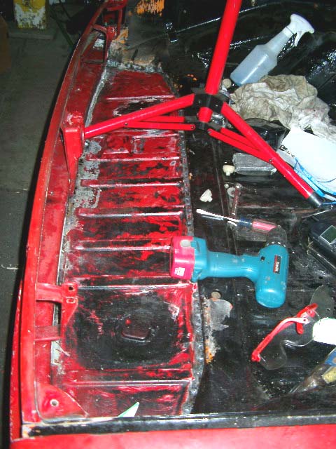

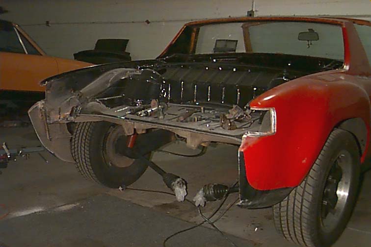

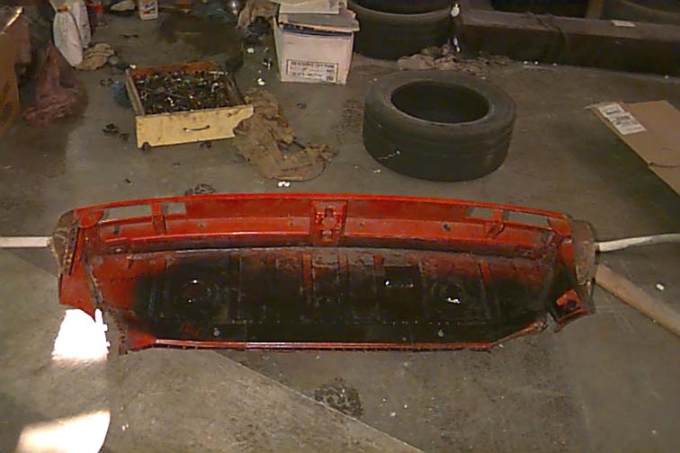

a good bodyshop will be able to pull this out ... you probably need a rear clip from a junk car. i replaced the rear clip on mine, wasn't too bad of a job.
but make SURE the car is pulled back correctly *before* you let them weld up anything. nothing worse than not fixing it right ...
shades.gif Andy
donor rear clip:
my old one removed:
new one welded in:
and painted:
