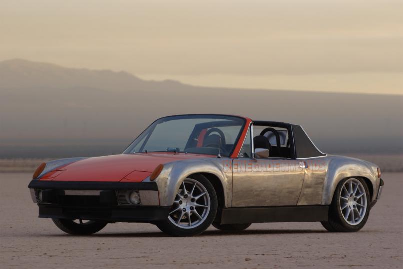

plymouth37
post Jun 10 2008, 05:19 PM
Post #58
Posts: 1,825
Joined: 24-May 05
From: Snoqualmie, WA
Member No.: 4,138
QUOTE(ninefourteener @ Jun 10 2008, 03:12 PM) *
With that.... I have to suggest you go a different direction with the wheels.
You've created (or will create) a low, fat stance for the car, and filled the wheelwells with these ricey, skinny-spoked wheels. I'd like to see you go with a more solid looking, less ricey wheel. I personally like mesh style wheels, but there are thousands of other options. Yea, you may gain a little weight, but I think that will be a small sacrifice for such a radical design.
What are you going to do with the "interior" portions of the car that are still painted?? Getting them all sanded down?? Just curious.
Are you sticking with the stock WRX TMIC setup? I was going to suggest a nice STI TMIC setup.... by the looks of the engine bay, I think it would fit nicely. I really don't think a FMIC would work with the radiator.... although that would be pretty cool.
The wheels in the concept are just for fun, these are the actual wheels I will be using, they are off of a 996.
As for the interior I will remove all orange paint and paint it to match the rest of the car.
I will be running a custom top mount intercooler, the new lid creates a ton of space for plumbing. Intercooler plumbing should be kept as short as possible so a front mount intercooler is really out of the question..
Rand
post Jun 10 2008, 05:25 PM
Post #59
Cross Member
Posts: 7,415
Joined: 8-February 05
From: OR
Member No.: 3,573
QUOTE(plymouth37 @ Jun 10 2008, 03:55 PM) *
It is so tempting to just toss the windshield all together.
I hear ya, but have to say I like the looks a lot better WITH the windshield like your concept photo. (IMG:style_emoticons/default/smile.gif)
That chopped/raked windshield, and the dual humps behind the cabin are exactly what really makes this thing WAY cooler than the other 914s without the targa bar and windshield that I've seen. Your design is working!
