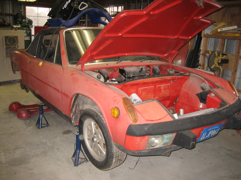

Hey Guys I finally got some time and the motivation to start working on my project car again. I started it a few years ago but, got side tracked on a few other project but I have decided to come back to it and finish it.
I all started 3-4 years ago when i got my first subaru wrx and decided i loved the power plant and thought what better way to add a lot of power to a light car. So i started with getting a twin turbo ej20 subaru engine from japan. I also bought the kennedy engineering adapter kit. I worked on the car for awhile, then got busy working on other project and kind of abanoned it. But no im back working on it about 5 nights a week.
But lucky I did take a break from it cause i decided to make to big changes to the car( since i can afford them now. Im going to use the stock subaru trans, with a bremar 2wd kit. Im going to use big brakes all the way around, i have some big reds for the front, and im goin to do the rear also. Car is getting a full cage, and all longs and suspension pickups are going to be plated and reinforced. And i decided to swap over to the single turbo set up for simplicity of tuning, and more maximum power output. ( im eventually swaping in a built 2.5 STI engine)
So i thought id start a thread to show my progress on my car, and will glady answer any questions along the way if anyone is looking to do a similar swap. Seems like the subaru conversion has gained a lot of popularity since i started my project quiet awhile ago.

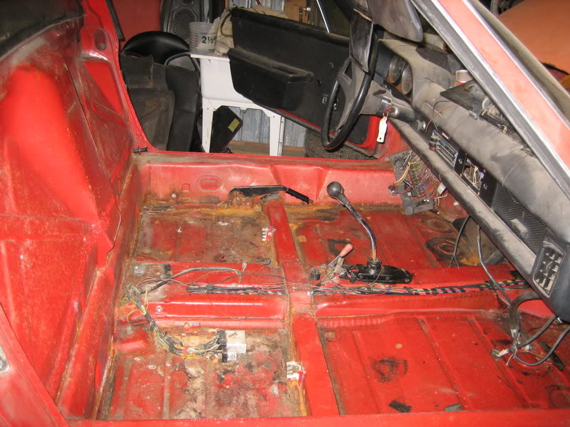

Started working on it about one and a half weeks ago, and so far got my interior stripped out, and gonna pick up my material for my cage next week. I got my transmission mounts fabricated, and my engine mount fabricated, and now im working on reinforcing the shock tower and such where my engine mount attaches to. Here's some picks of my progress hope you all enjoy
(IMG:http://www.914world.com/bbs2/uploads_offsite/img.photobucket.com-752-1269359998.1.jpg)

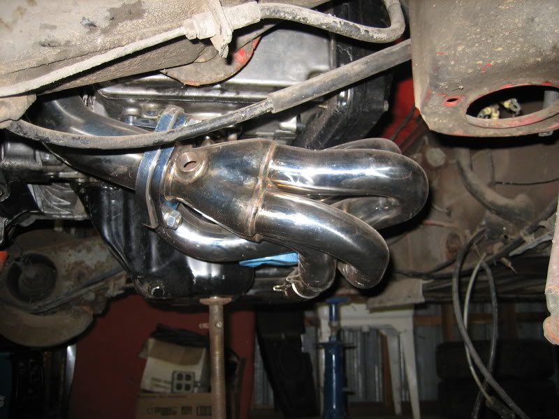

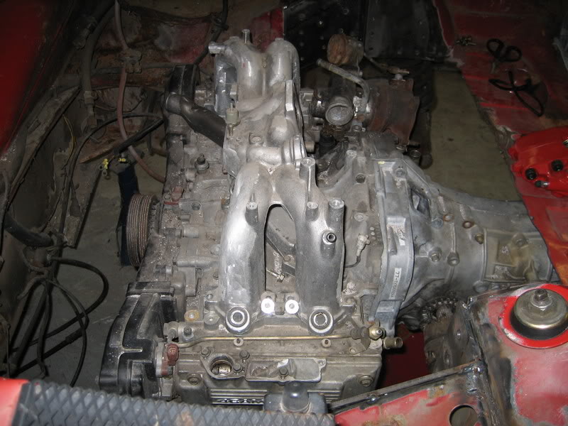

Here the engine sitting in the car

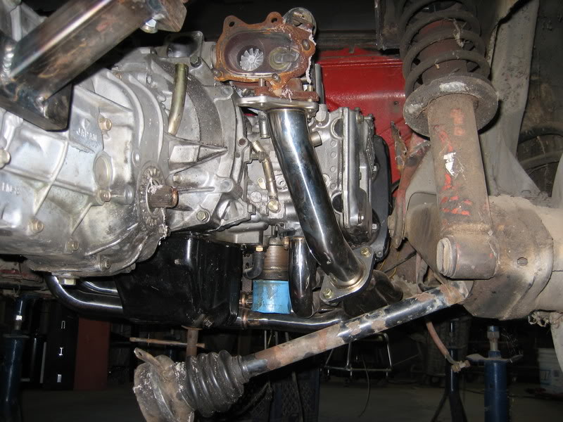

(IMG:http://www.914world.com/bbs2/uploads_offsite/img.photobucket.com-752-1269359999.2.jpg)
(IMG:http://www.914world.com/bbs2/uploads_offsite/img.photobucket.com-752-1269360000.3.jpg)
(IMG:http://www.914world.com/bbs2/uploads_offsite/img.photobucket.com-752-1269360000.4.jpg)

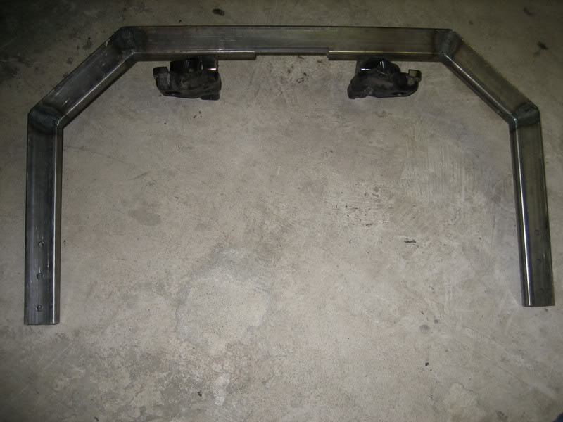

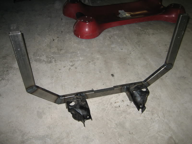

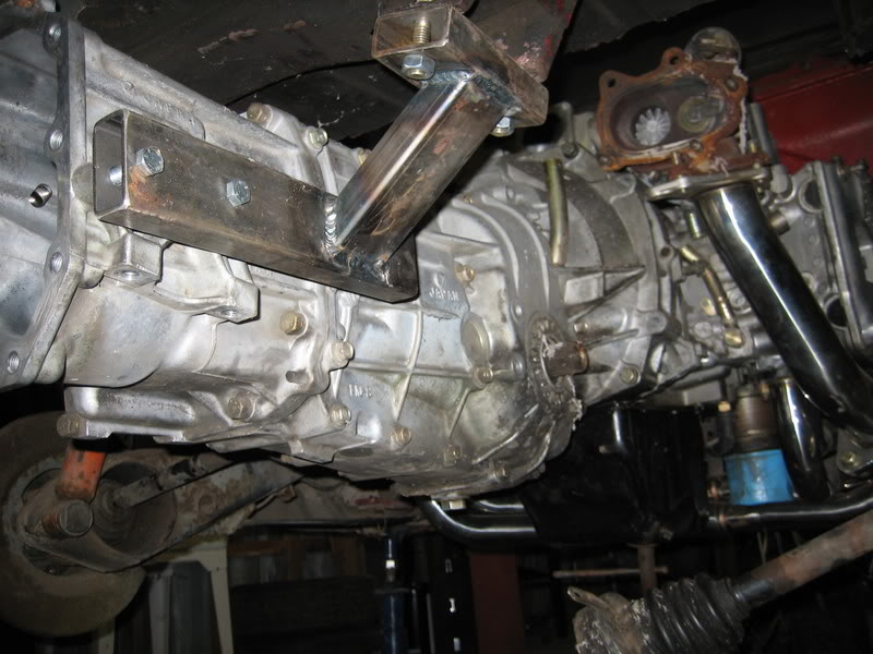

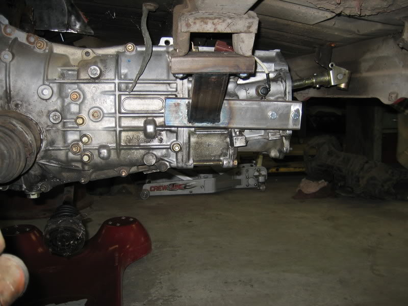

Transmission mounts, there not done yet still gotta cap all the ends on them and powder coat them and such

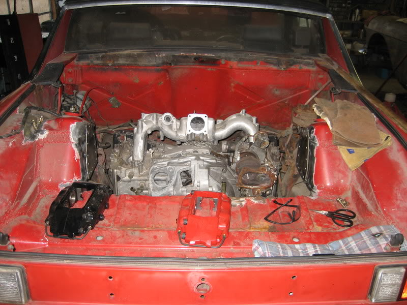

Engine mount ill show some pics of it installed later its out right now as im tig welding it up right now
(IMG:http://www.914world.com/bbs2/uploads_offsite/img.photobucket.com-752-1269360005.11.jpg)
(IMG:http://www.914world.com/bbs2/uploads_offsite/img.photobucket.com-752-1269360005.12.jpg)

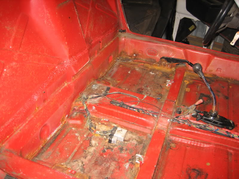

My stripped out interior, getting ready to prep it to plate the longs and start my cage
(IMG:http://www.914world.com/bbs2/uploads_offsite/img.photobucket.com-752-1269360006.13.jpg)

that engine mount design looks like i have seen it before

SCOTTY! (IMG:style_emoticons/default/bye1.gif) Ya looks kind of like your mount. You were the pioneer. Before the Vegas guys did theirs.
I would sleeve those mount bolts or they will start to crush the tubing and either fall out of shear off. Oh and use grade 8's.

Yah Im going to sleeve and cap everything when im done with them, just wanted to get the rough construction done first. Im gonna powder coat them also.

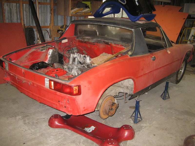

Worked on the Car a little bit more this weekend, i stripped all the insulation/sound deadening from the floor, and worked on getting the dash out, im gonna soda blast the whole interior of the car, before i start work on my cage, and boxing my longs.
I also started work on mocking up my intercooler setup. I'll post some more pics soon.

Well i have Been working away at the car when ever i get a chance. And i have made the final decision that im Gonna change over to the subaru 3.0 Six so if any one is looking for a Good EJ20 Subie engine, i have one along with a good stainless header and uppipe. I also have a kennedy adapter and clutch for the 914 transaxle, as im using the subie trans. Lemme know if anyone is interested.
Heres a few pics of the Interior and engine compartment. I got most of the interior blasted and some of the engine compartment done. I'll probably do more this weekend. I just gonna finish removing some of the seam sealer.

Here's a Pic of the hell hole area, it looks really good very few spots that had rusted thru
(IMG:http://img.photobucket.com/albums/v227/ForceFedGN/CameraPics106.jpg)
This week ill finish stripping the seam sealer, and then work on prepping the plating i made for the longs, and drill all the holes in them, and them get them welded in. Them ill work on making the pieces to box in the rails in the engine compartment. Stay tuned more to come

Can ask why your able to cut out the area in the trunk? I understand that it will help with engine fitting, but doesn't that part of the trunk add some structure to the car, or maybe it doesn't add any?

Yes, that trunk section braces between shock towers...something besides the horzontal sheetmetal should be there to avoid flex.

Well I cut the trunk for a couple of reasons, One it made it alot eaiser to fit the engine. But it would kit no problem with the trunk wall, it would just need to be notched a little for the turbo on the passenger side. and two the car is gonna get a full cage with full trunk bracing and a the cage will completely tie the shock towers together. More on that to come, once i get longs plated and the engine compartment frame rails plated.
